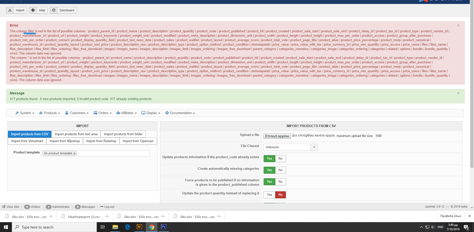

6 years 11 months ago #311806
...also i attached a screen shot to see.
I follow exactly your guides. The Title of custom text is material the column name is "iliko"
In csv i fill in iliko column name all the values but the import can not accept.
If name "iliko" is not of list possible name which the name ??
Do you know how to fix it??
thanks

6 years 11 months ago #311805
The problem is the type of your custom field.
The type "custom text" is a type which allows you to have text between other custom field inputs on forms.
So there is no column in the database corresponding to the custom field.
You need to delete it and recreate it with the type "text". Then, you'll be able to use the column name of the custom field in your CSV to import data into it.
