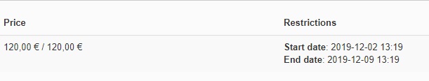

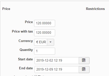

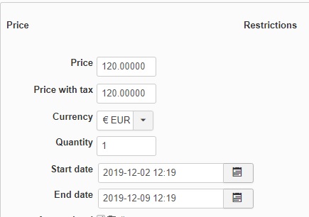

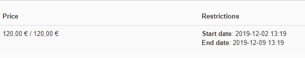

Hello!
I found some strange behavior in price restriction when start dates and end dates are set.
If I just save the product (with or without any modification), the Start dates and End dates adds one extra hour.
Its happening on your demo site to.
Is this an expected behavior?
Regards!
