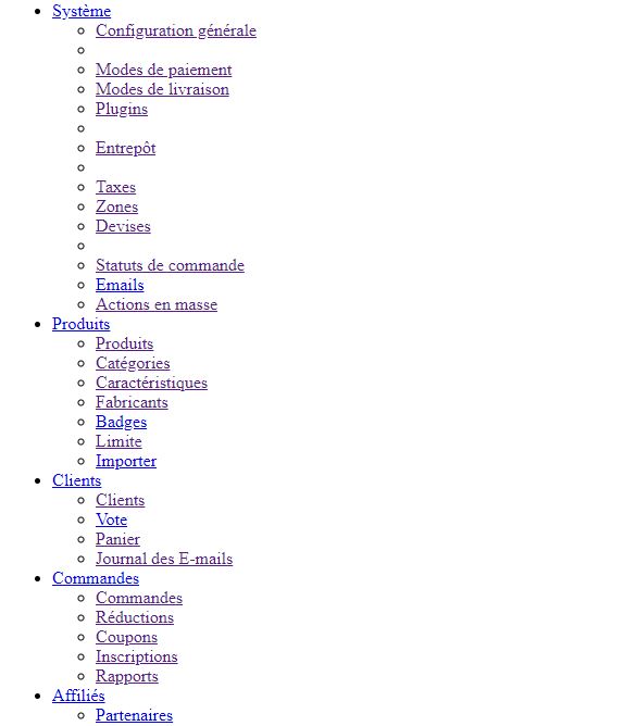

I recently made a big update on my website, and i now have a strange behaviour on the backend (in administration) : when clicking on a product, a category, a shipping mode, a paiement mode and a few more items... i have a strange output (no matter what browser i use) :
It looks like the icons and many more things are missing !

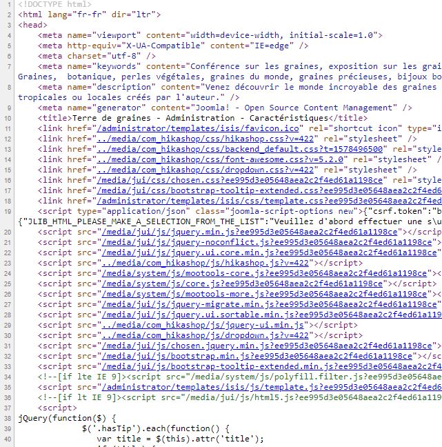

I tried to understand what is happening. When i open the console i can see that the "beginning" of the html file is missing
Instead of starting with a "normal page" like this

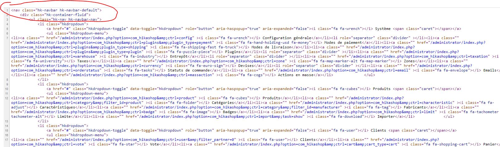

it starts directly with
<nav class="hk-navbar hk-navbar-default">
	<div class="hk-container-fluid">
		<ul class="hk-nav hk-navbar-nav">
			<li class="hkdropdown"
here the picture :
so do you have an idea how to fix that ??
