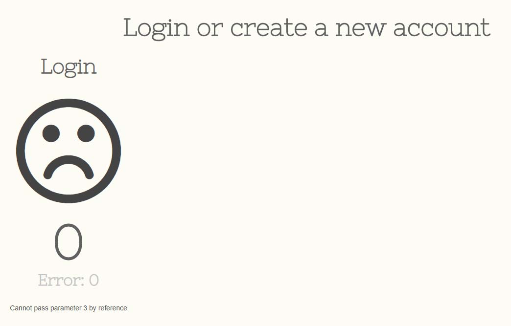

Suddenly, I'm getting an error on my website www.madebyleah.uk when I add something to the shop and checkout - its saying that I need to login (which is correct, but normally it comes up with a nice Hikashop message, not this ugly system generated one (which is putting people off and they are leaving the site). Could you advise please?

I already currently have the 'error reporting' set to 'development': and 'debug' set to 'yes'. You can see the errors live for yourself, also the screen grab of what I see on the image I attached on the original post. So, as originally sated "Error: 0 Cannot pass parameter 3 by reference" is the only error message I can manufacture.
