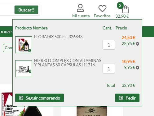

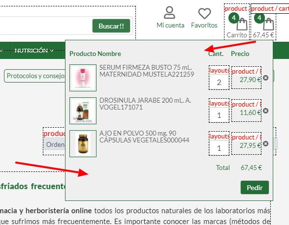

HI,
I'm customizing the minicart dropdown window. Apply the styles ok, but I need to incorporate a button "continue shopping".
I cannot identify the view to modify. Applying "display view files" in Advance settigs does not show which view file to edit.
Thank you
Javier

The thing is that if you check the HTML of the area, you can see that it is inside the area of the product / cart.php dashed border.
And on your screenshot, you can see that the text "product / cart.php" itself is bordered with a continuous line, indicating that your mouse is hovering inside that area.
You think it's outside because the CSS / JS applying on it for the dropdown view make it go outside the area.

6 years 4 months ago #317061
solved. With hover cursor, the file product / cart is indicated
I have edited this view and adjusted the window without problems with the button "continue shopping"
Thank you
Javier
