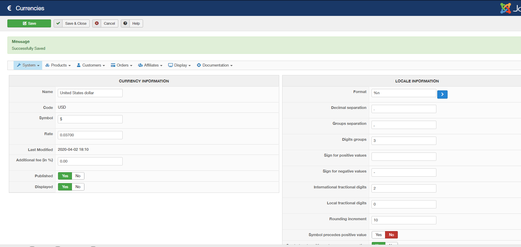

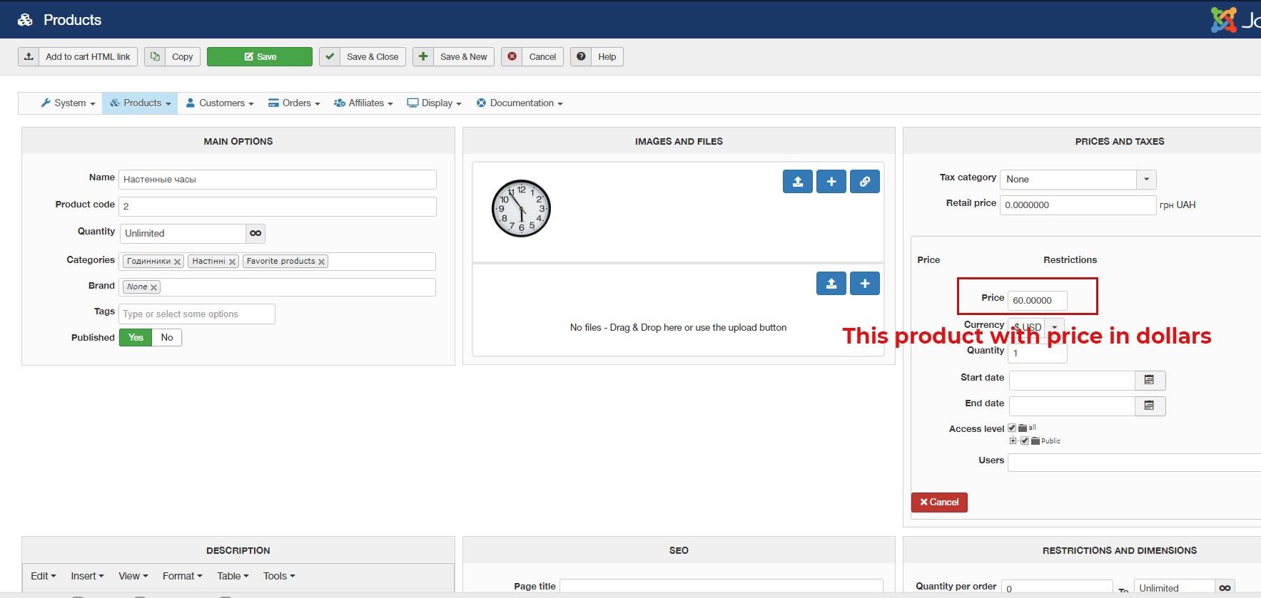

Hello. I am adding price in USD but I need it to display in local Ukrainian currency, but it is not rounded. How to fix this?

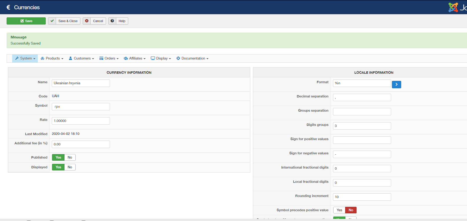

In the settings of your currency, you can configure how you want the prices to be rounded. You can find them when you edit the currency via the menu System>Currencies.

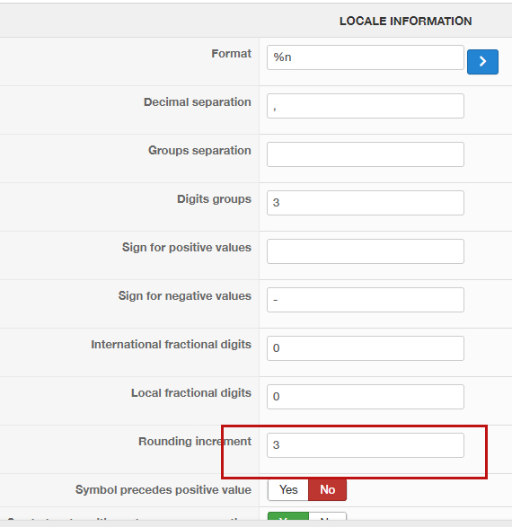

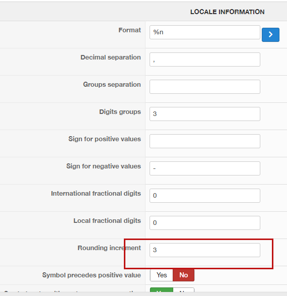

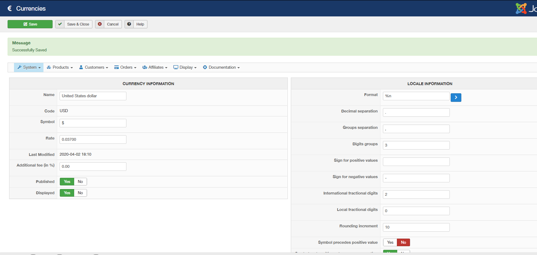

I've tried to change from 0 to 10 - the price was the same. screenshots attached.
What I can do else?

  • Posts: 86081
  • Thank you received: 14189
6 years 4 months ago #317042
Then try to activate the "round prices during calculations" setting of the HikaShop configuration.
Also, I would recommend a round increment of 10, not 3.

6 years 4 months ago #317069
it is activated from beginning and round increment is 10 now - nothing.
All screenshots attached

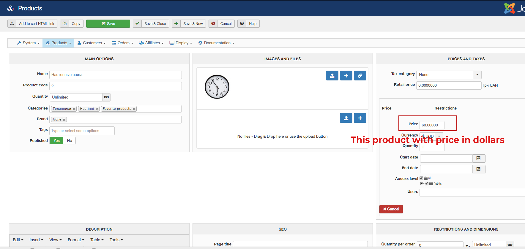

6 years 4 months ago #317080

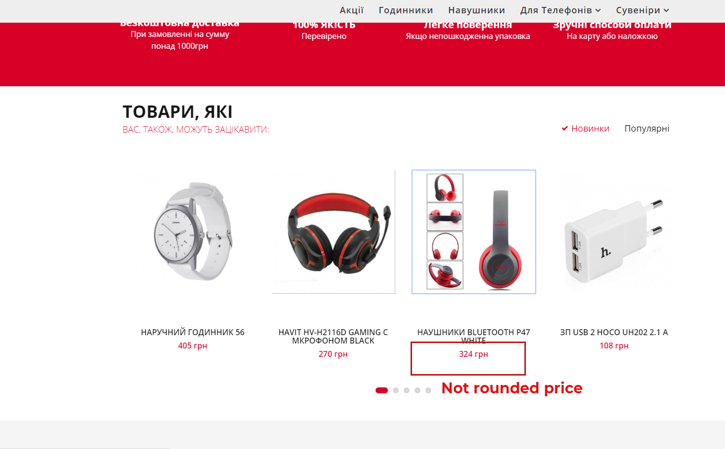

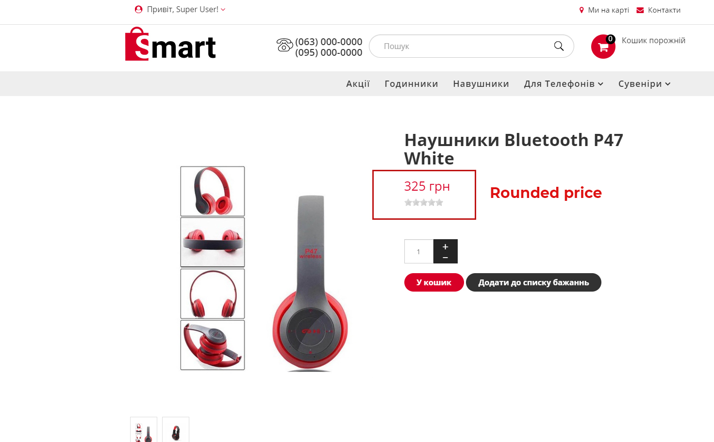

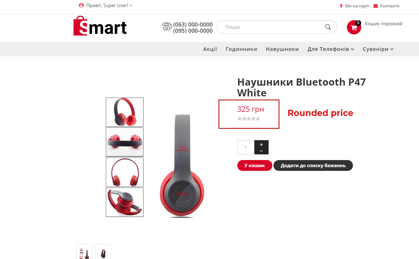

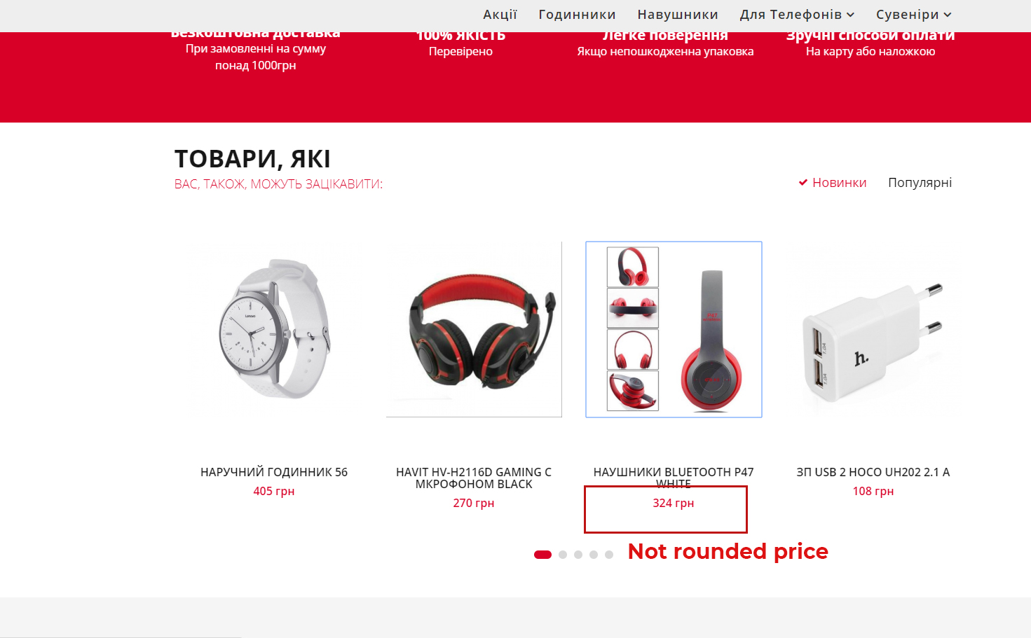

There're prices that are not rounded in JD Hikashop Category module on the main page smart.ck.ua/ .
Each product separately has a rounded price. How to fix this? Screenshots attached
smart.ck.ua/component/hikashop/product/7..._Bluetooth_P47_White
it is a link to a product with rounded price, but it is not rounded in the Hikashop Category module of favirite products

There was my last comment
  • Posts: 86081
6 years 4 months ago #317081
For the JD Hikashop Category module, I don't know. I would recommend to check with the support of that module as I don't know how is their code to display the price. Normally, it needs to call the format function of the class.currency class which does the increment rounding before the display. But if the module doesn't call that function and does the display differently, then it it probably requires some code modifications to support that rounding capability.
