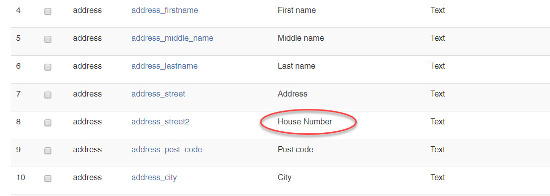

For your information we use the address_street2 for the house number. So clients can't forget to fill in the house number.
Therefore you gave us a custom code (myparcel.php) to add the number after the address_street like this:

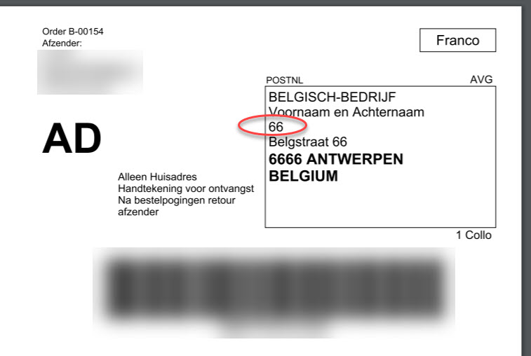

This worked fine for the last year. But now with the updated plugin we get an extra line into the label.
See here?

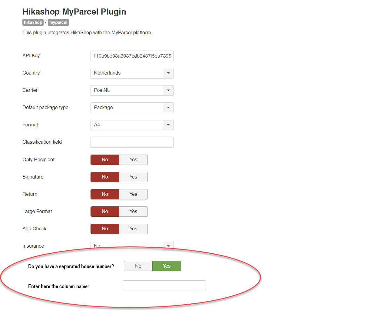

I think more people could have this issue so it would be nice if you can have an option in the
backend from the plug-in where you can set Column name for the house number if you have this separated from the column address_street.
Like this:
Hope you can help us.
See here?
Like this:
