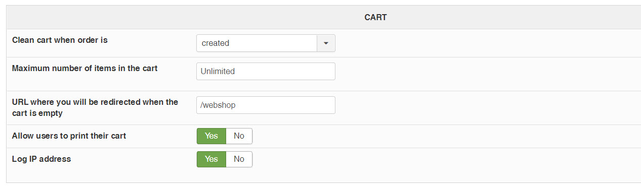

6 years 4 months ago #317819
Thanks Nicolas,
The configuration was set clean cart when order is created.
See screenshot, so I will contact skyspider.

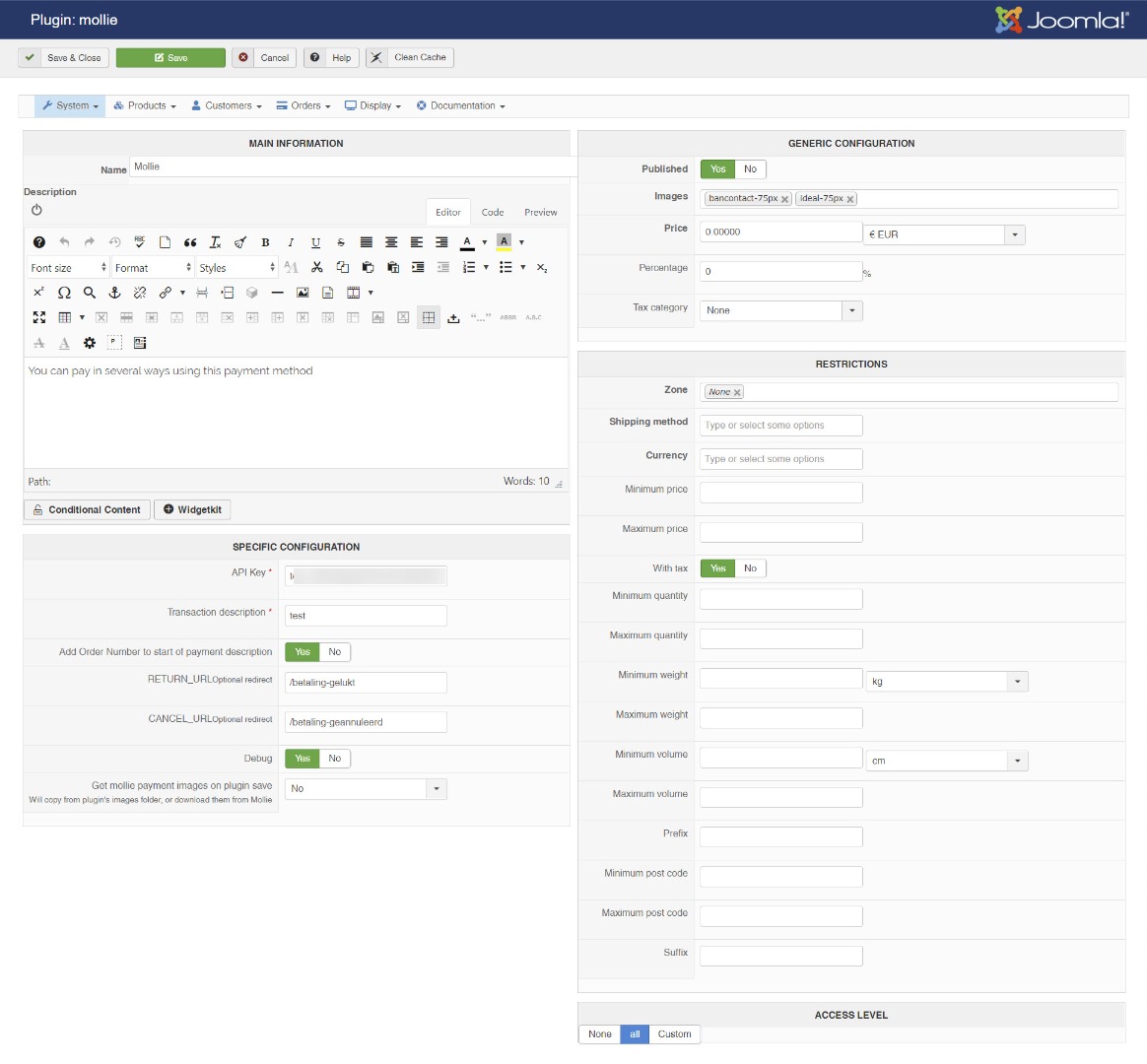

6 years 4 months ago #317869

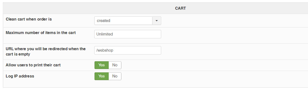

Here you can see the configuration:
The return url is: basis-hikashop.lucians.eu/betaling-gelukt
I have turned off the MyParcel plugin, so no you can use fake addresses.
Hope you can find something.

With the "clean cart when order is" setting set to "created", the cart is cleared following the creation of the order, before the redirection to the payment gateway. So if you still have a cart when you come back from the payment gateway it means that it's not the same cart.
You must have had several carts linked to your user account while doing your tests, and thus when one cart is cleared, the next one in line becomes the current cart, and if you have several carts with the same thing, then you think that the cart wasn't cleared.
First, delete the carts linked to your test user account in the menu Customers>Carts of your backend.
Then, test again and hopefully you won't be able to reproduce the problem.

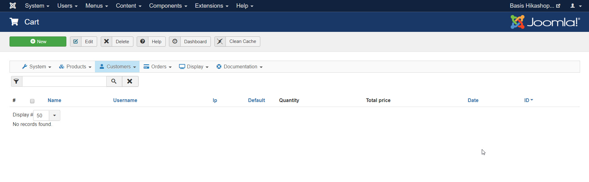

  • Posts: 637
  • Thank you received: 26
6 years 4 months ago #317900
Hi Nicoals,
Thanks for the hint, but that's not the problem.
Because when I test with an other payment plugin (ROPayments form Roland) it's working perfect.

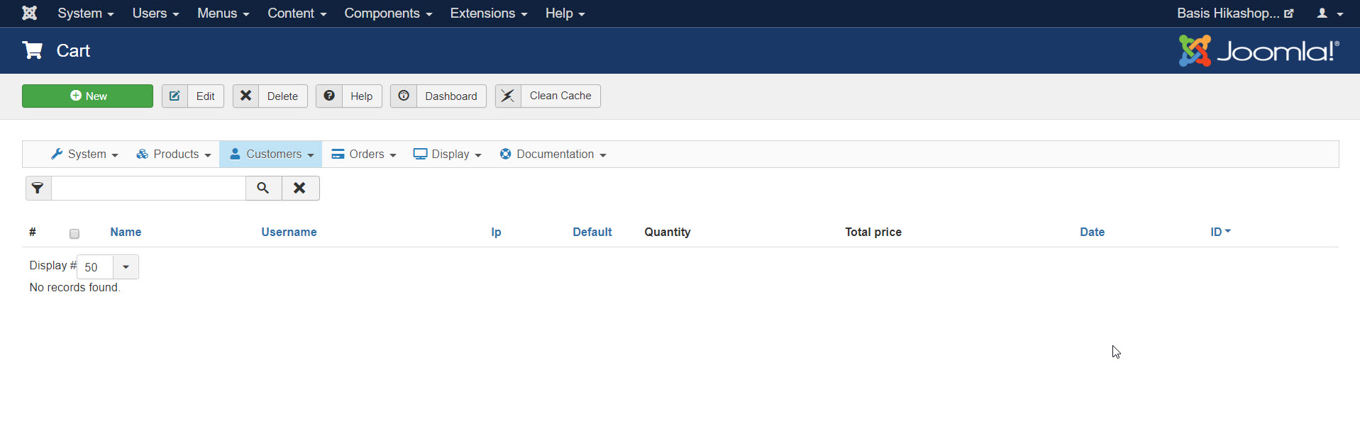

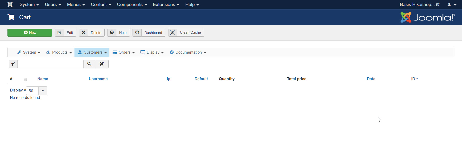

And here you can see I have no carts open in the menu Customers>Carts,
And everytime I start my test with an empty cart and I have tested with differents products.

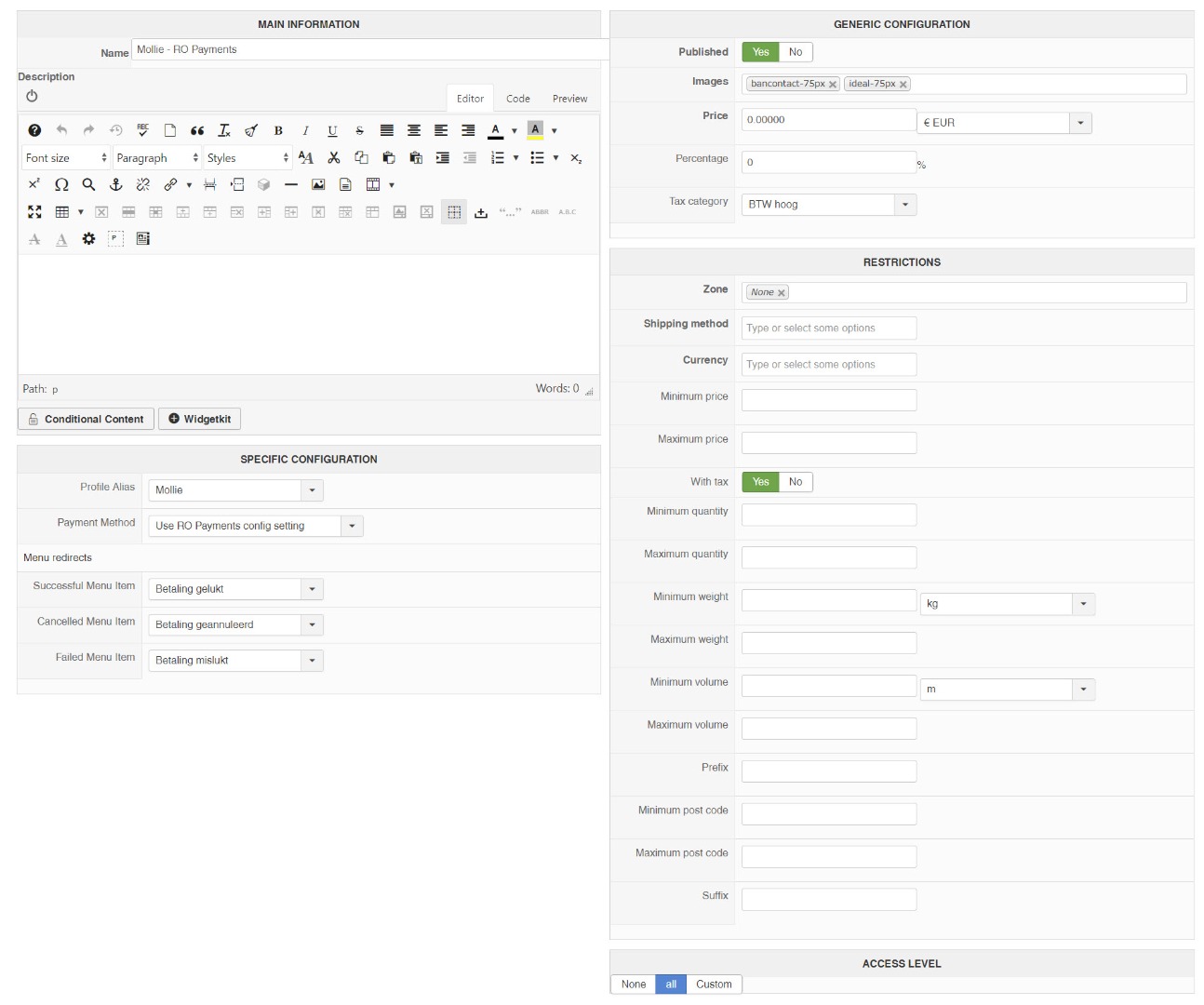

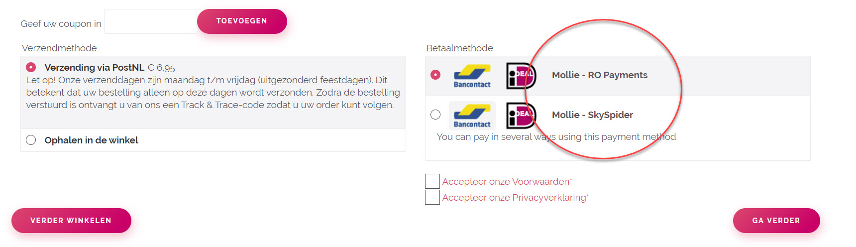

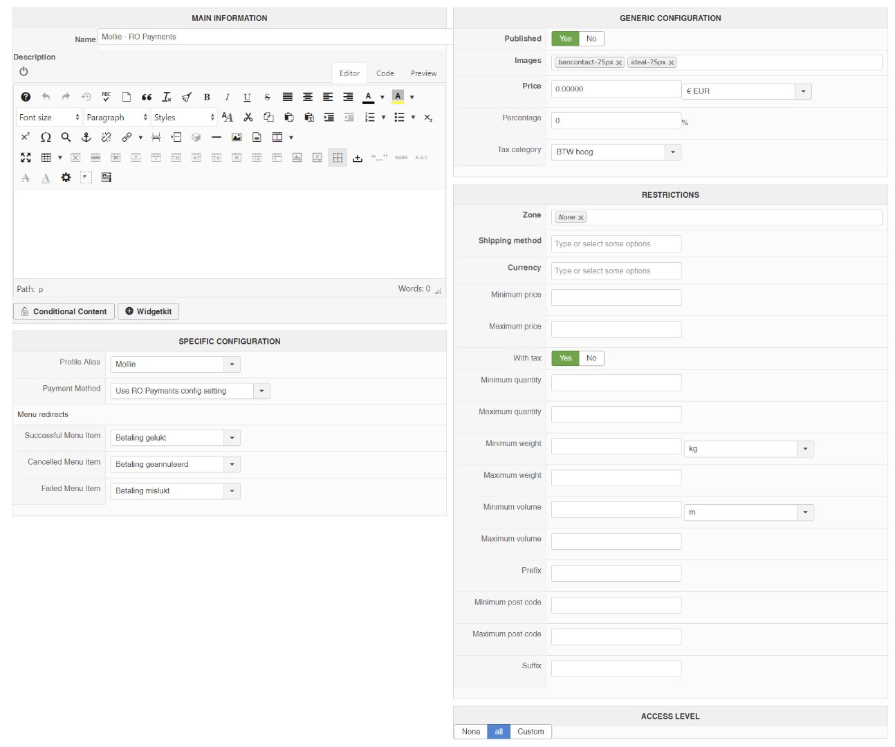

6 years 4 months ago #317930
For me it's also a mystery!
Al my shops are configured with clear cart when order is created, they all work perfect with RO payments.
I only want to test Sky Spider as an alternative option in case of.

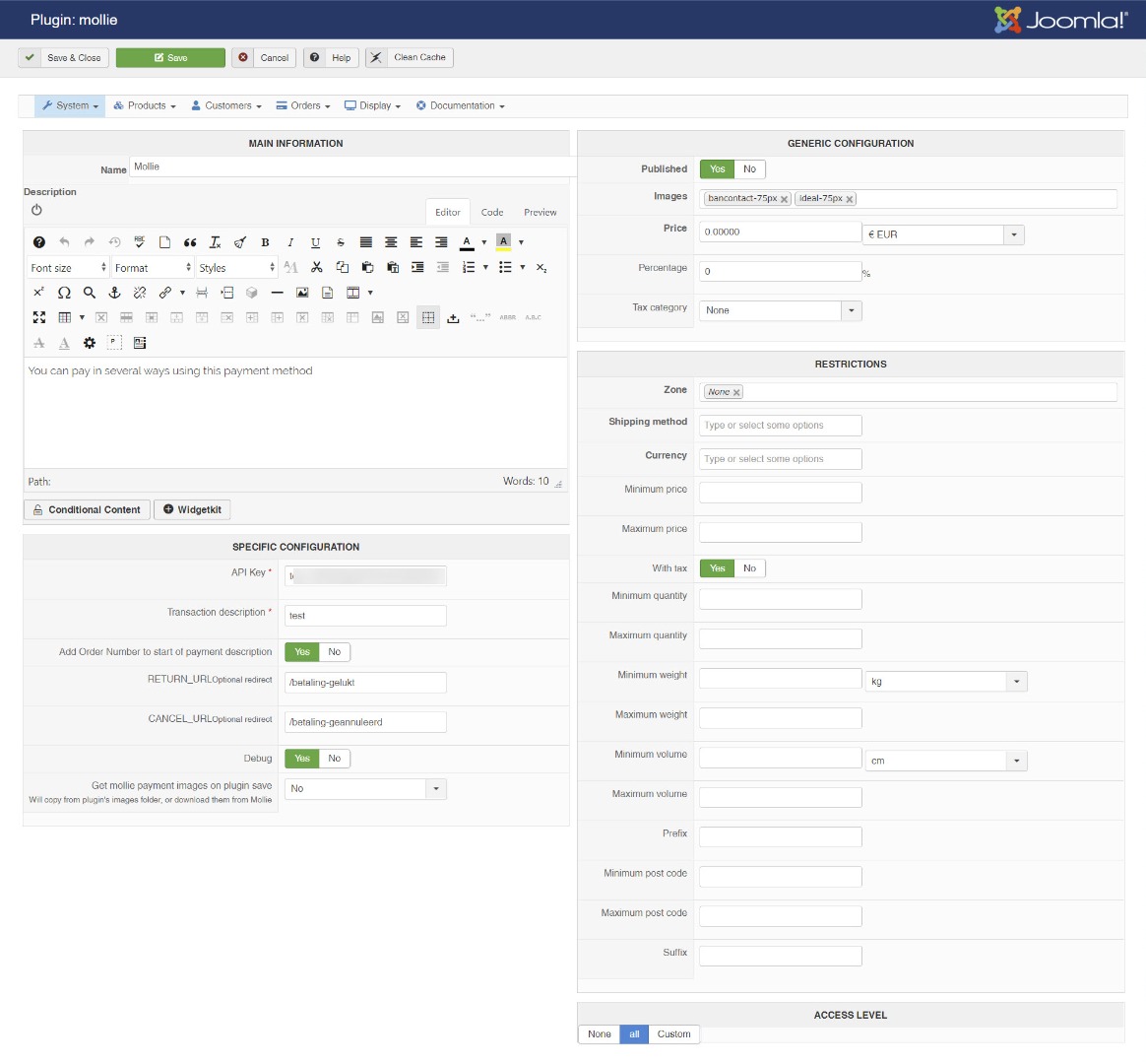

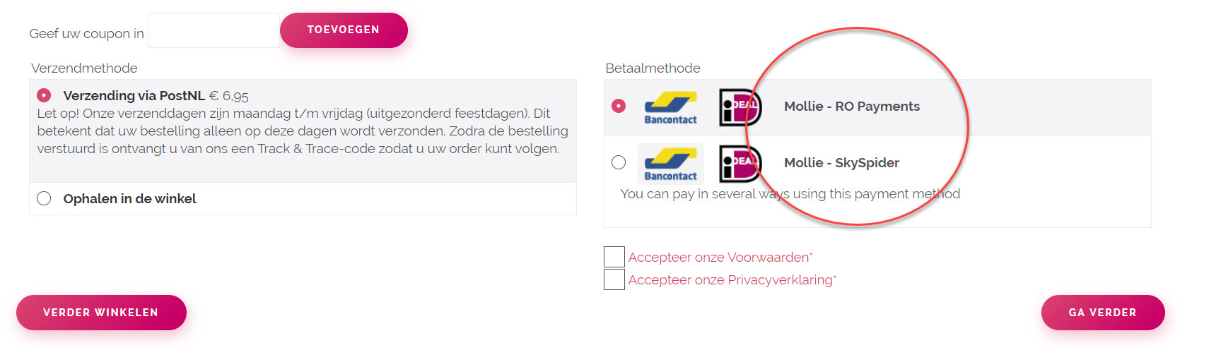

I have turned on both Payment plugins so you can test with both.
See also the configuration from RO Payments.
Kind regards,
Lumiga

  • Posts: 637
6 years 4 months ago #318004
When I turn off the RETURN URL then the cart is gone. So that works fine.
But I will then be sent back to this URL: basis-hikashop.lucians.eu/betaling-mislukt (payment failed)
But the payment was successful and the order is confirmed.
