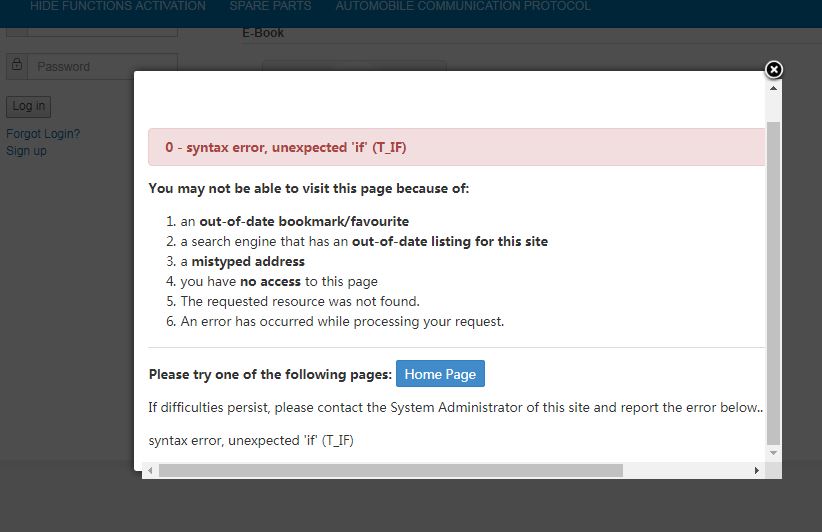

Today I upgraded hikashop to 4.3.0. Unfortunately there was a error when click add to cart button after upgraded.
Error info:
0 - syntax error, unexpected 'if' (T_IF)
What is the problem? Thanks!
You may not be able to visit this page because of:
1.an out-of-date bookmark/favourite
2.a search engine that has an out-of-date listing for this site
3.a mistyped address
4.you have no access to this page
5.The requested resource was not found.
6.An error has occurred while processing your request.
Please try one of the following pages: Home Page
If difficulties persist, please contact the System Administrator of this site and report the error below..
