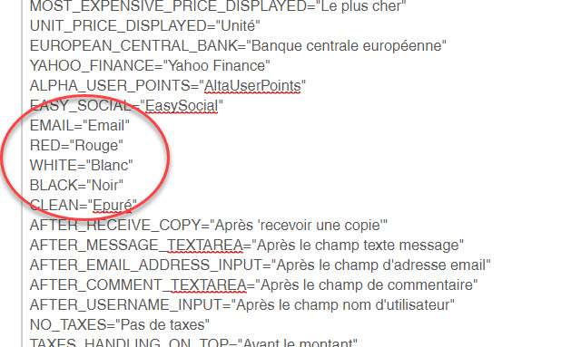

Hi Hikashopteam,
We have an issue that some colors are automatically translated when showing the characteristics names at the front-end and the backend. But, some colors of products must remain in the original (English language).
We have issues with the colors:
RED
WHITE
BLACK
It seems that there are translations that are causing this now. But we cannot solve this with a language override because sometimes the color has to be written with a small letter and in other places with a capital letter. Is it possible to give the colors from Hikashop a more specific language string like HIKASHOP_RED, HIKASHOP_WHITE, etc.?
In that case our issue is solved.
Hope you can take a look.

6 years 2 months ago #320488
You can do it the other way. In your characteristic values, instead of writing Red, Black and White, write MY_RED, MY_BLACK and MY_WHITE
Then, in your translation override file, you can add:
MY_RED="Red"
MY_BLACK="Black"
MY_WHITE="White"
And you can add that for all the languages in their translation override file so you'll get the english text for all the languages.
