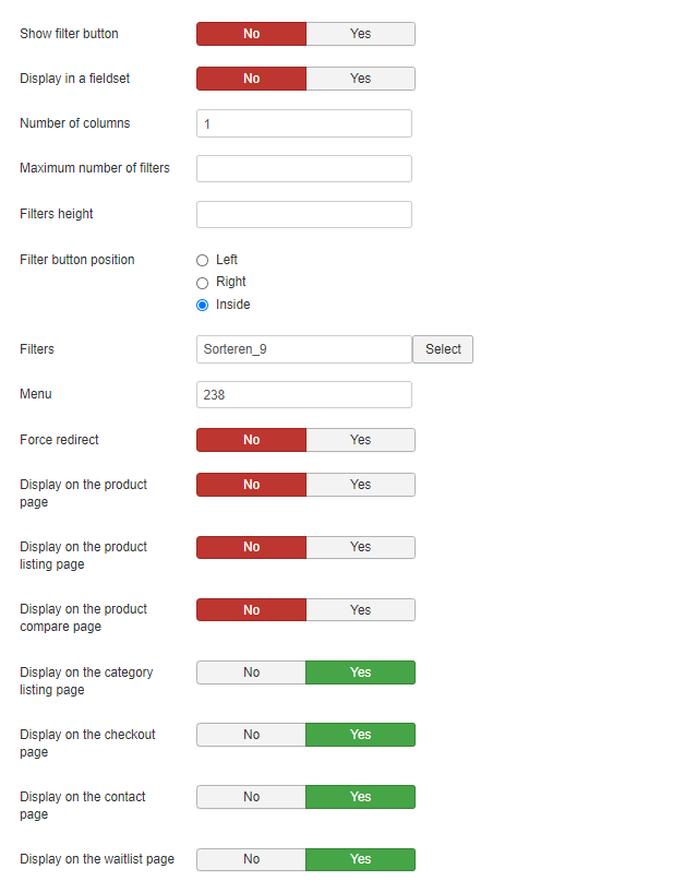

Hi, have a strange issue.

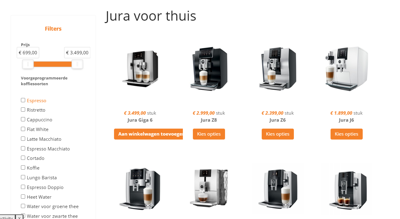

I am running the filter module (only visible for administrators).
See 'FIlterGoed' for how it looks in the category

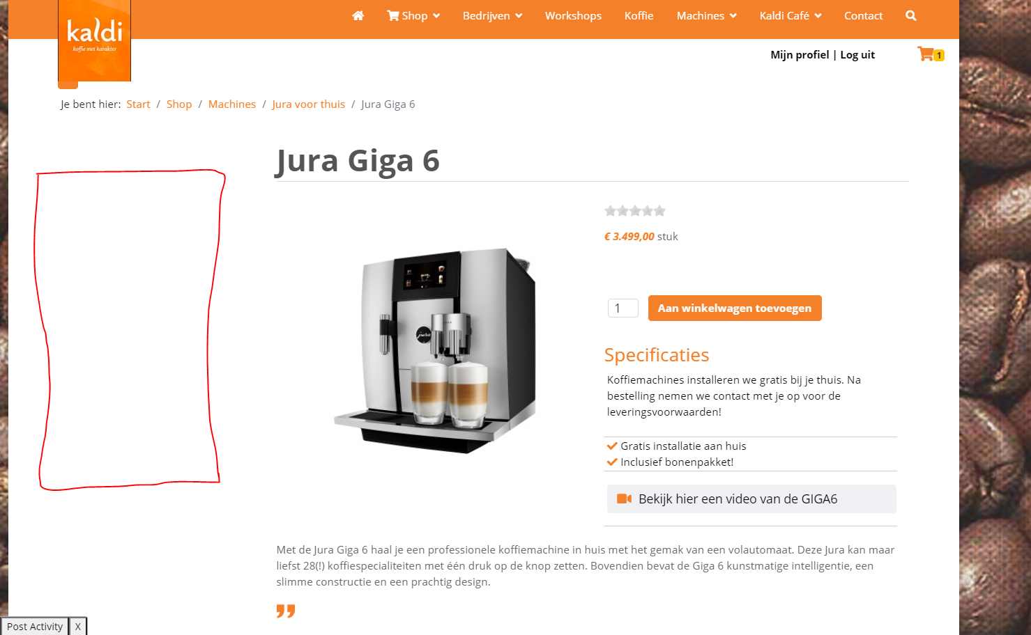

I disabled the filter (see settings) in the product
But in the product it still shows an empty column (image ZouLeegMoetenZijn).
Any idea what causes this?

I didn't totally understand this, so I solved it in a different way and I am putting it here so others can also learn this.
I use Advanced Module Manager and selected the module to display in certain categories
Within the module I select to NOT display the filter module on the product itself (but this leads to an empty column)
