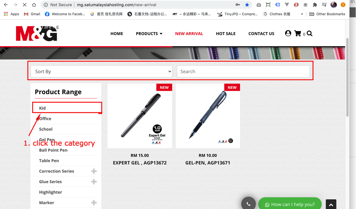

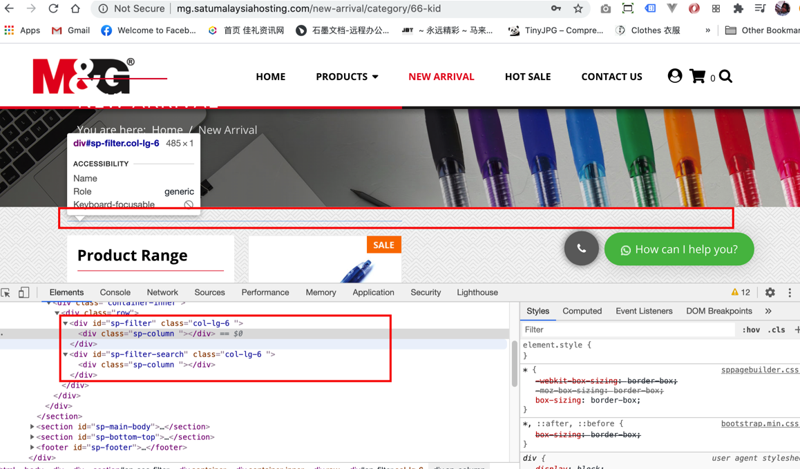

Dear Support
why the filter won't display when I click the category eg Kids (Menu Accordeon CK)

I'm not sure. However, I can think of 2 things which could do that.
- if you have Advanced Modules manager, you can restrict the modules to be displayed based on the current category
- in the settings of the filters (menu Display>Filters) you can restrict them to only one category. So if you selected the main category and have the "include sub categories" setting turned off, then the filter will only display for the main category and won't appear for sub categories
