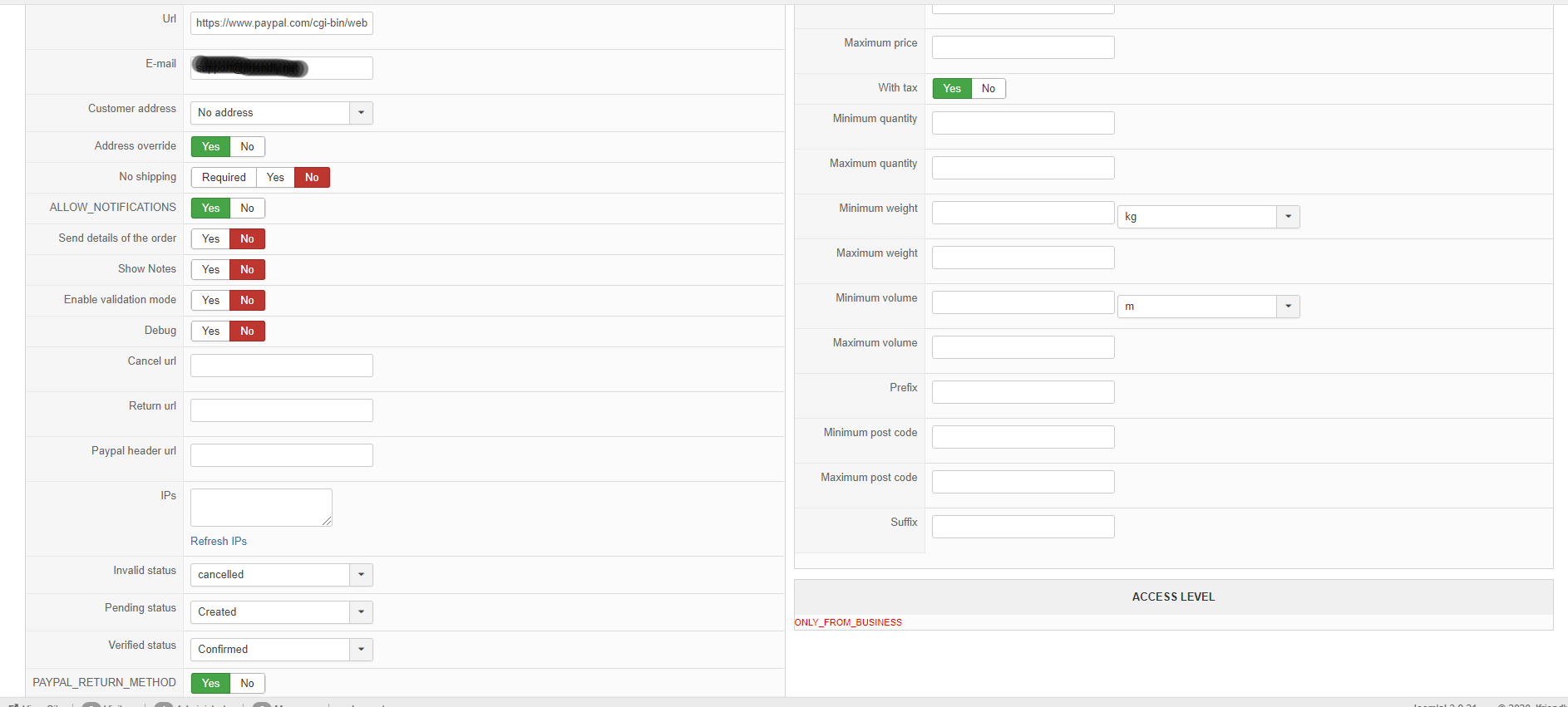

Hello I have special code in after_end.php view of Checkout, why is it not being triggered by Paypal plugin. As a test, I have a Cash on Delivery payment setup, and whenever I use the COD, after_end.php is triggered. I have not modified anything with the Paypal plugin except for the settings. I just want it to trigger my modified after_end.php
Attaching my settings in Hikashop for paypal.

5 years 11 months ago #323549
The after_end will only be "triggered" when the customer comes back to the website from the PayPal payment page.
If you close your browser/tab after the payment is done or don't do the payment on PayPal, then after_end is not called as after_end is the view file displaying the default thank you page.
