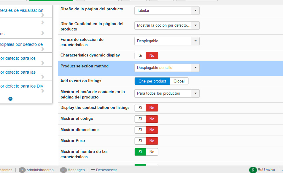

After upgrading to hikashop 4.4.0 I have a problem in the product view.

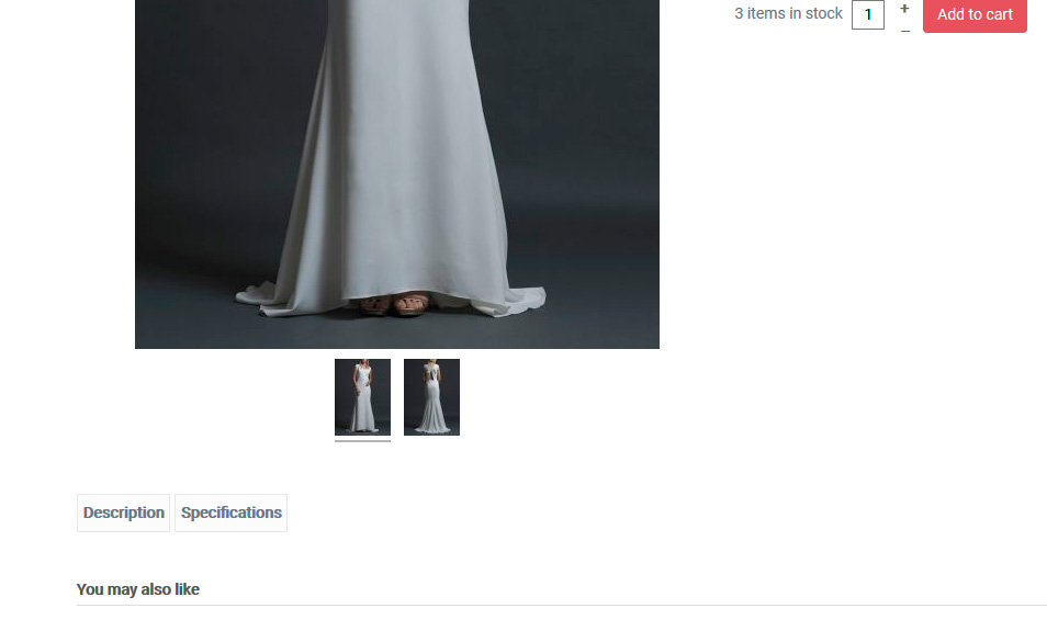

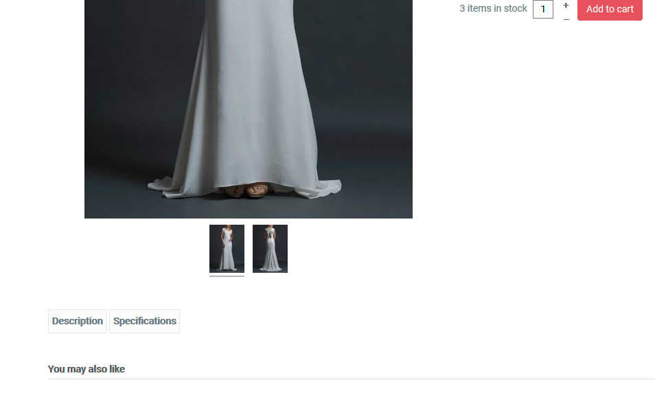

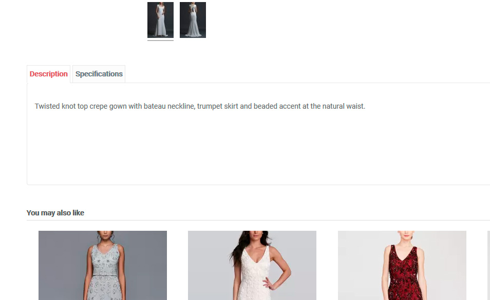

I have the tabular view on my product page. If I enable "Characteristics dynamic display" the carrousel that I have under the product disappears.
The description and specifications of the table disappear and the table tab selector does not work.

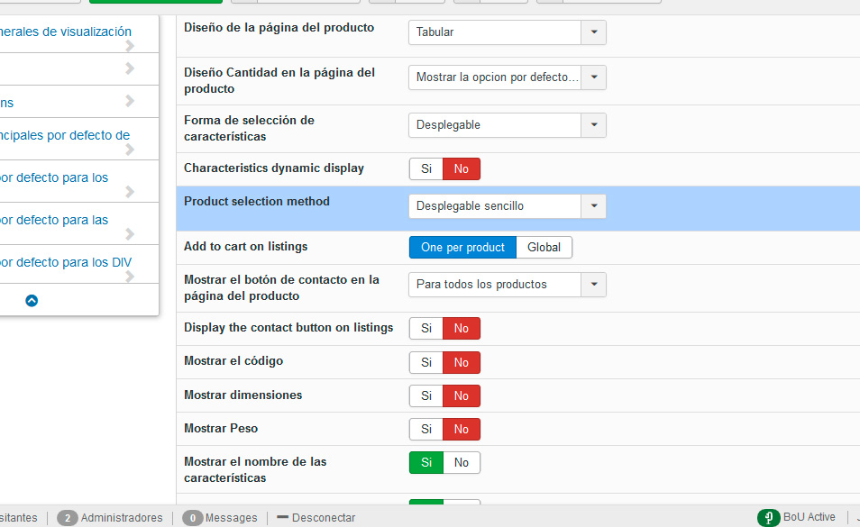

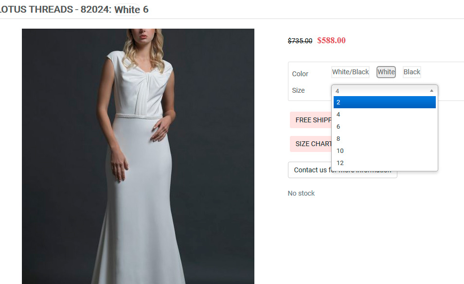

If I disable "Characteristics dynamic display" the stock of the variants all appear in "NO stock"
I appreciate your prompt help with this

1. The problem:
If I enable "Characteristics dynamic display" the carrousel that I have under the product page disappears. Carousel is
(You may also like)
The description and specifications of the table disappear and the table tab selector does not work. (Only tabs appear)

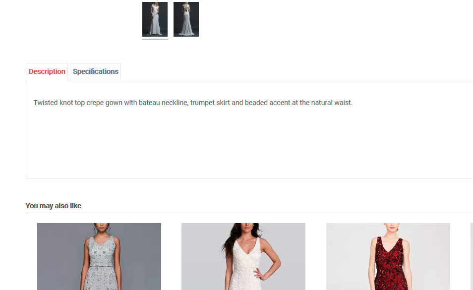

- Disable third party plugins like magiczoom, and the result is the same.
2. The conflict
I found that I have a conflict with the magiczoom:

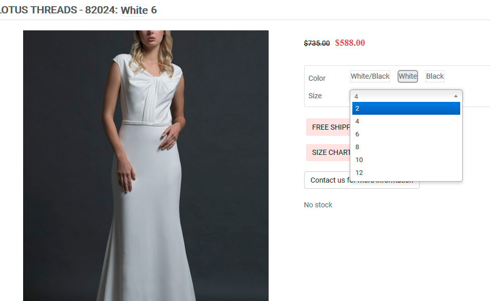

If I disable the "Characteristics dynamic display" the carousel below the product page appears (You may also like) and the product descriptions and tabs work.
But it conflicts with the stock of variants.
When changing between color and size, it shows a wrong stock, as if the quantity was not updated in each variant.
As I know the stock of the product, I know that it is showing a wrong stock. In a color and size there are 7 and he shows 2 or 3 and sometimes it appears that there is no stock.
Disable the magiczoom and with the "Characteristics dynamic display" disabled it works fine.
