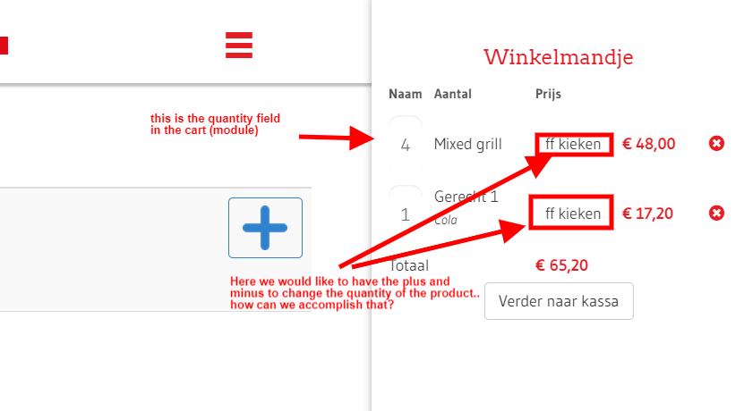

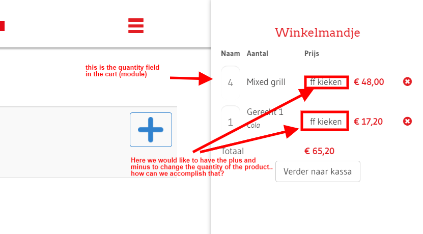

We would like to have a plus and minus sign in the cart module we configured to plus and min the products in the cart.
We can not get this to be done?
Please see screenshot and help?? :)

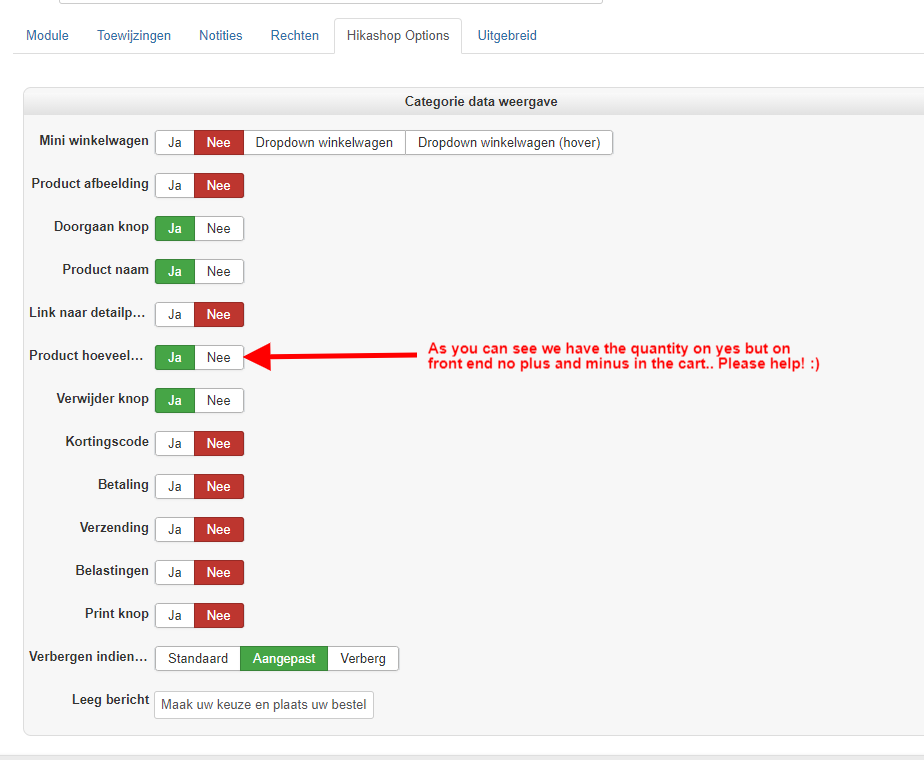

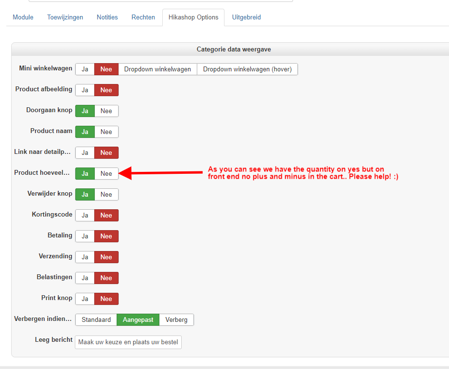

Setting the "Product quantities" option to YES, through "Hikashop Options" tab of your cart module configuration page will probably do the job.

We have the option Product Quantities on yes.. but unfortnatly no plus or minus on the front end in the cart..
see screenshot.

There is no option to add plus and minus buttons to the quantity input field of the cart module.
The only solution would be to edit the file "cart" of the view "product" via the menu Display>Views to add your own code (the HTML of the link with a bit of javascript).

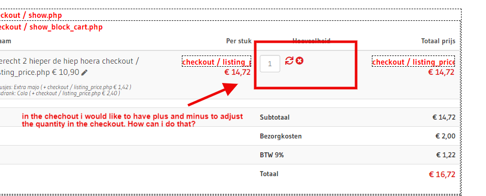

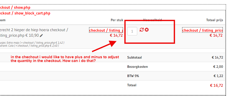

another question about the plus and minus but now for the general checkout.
Pleas help.. see attachment
Thanks.

Similarily, there is no option for that and you'll have to edit the view file show_block_cart.php in a similar manner to what you did in the product / cart.php view file if you want to add these extra buttons.
