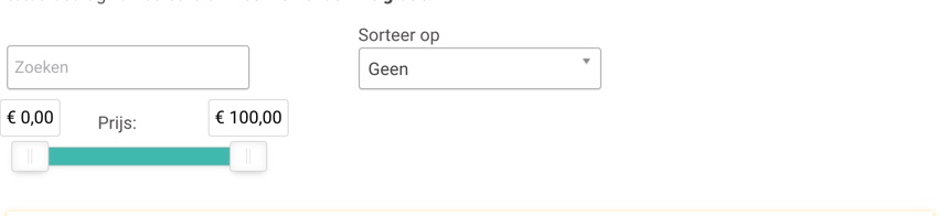

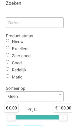

Other question about this filter module.
In the sidebar the filter has more options than in the category top
Sidebar:
Category Top:
Kind regards René

5 years 8 months ago #326930
So there is one search module used for the sidebar and the category filter (i have selected inherit).
I can't explain why the Status field is not displayed in the category view (see previous post for the screenshots)
And can you explain why the filters are not collapsed?

5 years 8 months ago #326975
Could you provide a screenshot of the settings of the "product status" filter ?
To me, it seems that if you don't see it at the top of the listing, it's because of its settings.
Regarding the fact that the filter area is not collapsed at the top of the products listing, I suppose it is because you have a view override based on an old version of HikaShop which doesn't contain the necessary modifications for the collapse system, which was only added last year.
So check the folder templates/YOUR_TEMPLATE/html/com_hikashop/product via FTP.
Try renaming it and see if that helps. If it does, then it means that it comes from one of the view files in that folder and probably the "filter.php" view file.
