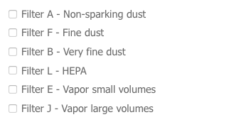

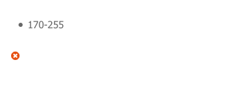

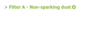

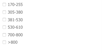

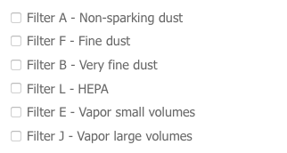

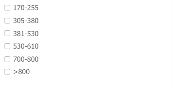

Hi there,

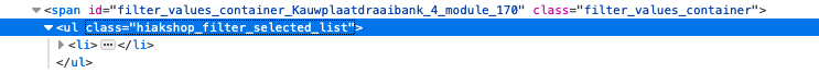

After filtering products the filtered values container is altered in the last update and not showing the right way. It's now a <ul class="hiakshop_filter_selected_list"> instead of a <span class="filter_values_container">, with hikashop wrongly spelled as hiakshop. Maybe there's the problem! See screenshots (first and last ones are from the updated/wrong site, the others are right).

- Regarding the typo in the class name, we indeed made a mistake there. I've made a patch on our end to fix that.
You can download the install package again on our website and install it on yours and it will add the change, or just directly do the change in the file administrator/components/com_hikashop/classes/filter.php
- Regarding the fact that the HTML changed. We indeed changed the way it displays in order to use a ul/li list instead of the translations HIKA_FILTER_LIST_PREPEND and HIKA_FILTER_LIST_SEPARATOR which you had apparently used to customize the way it looked before. We did this change so that the customization of the look can now be done purely with CSS.
Note that the span with the class filter_values_container is still there as it encompass the whole area, as before.
I believe that it is a good change going forward but it will indeed require that you adapt a bit the CSS if you want it to look like before.

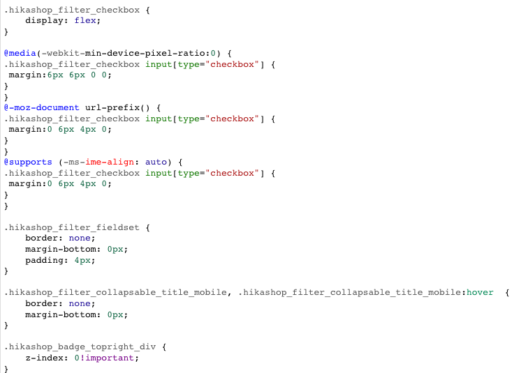

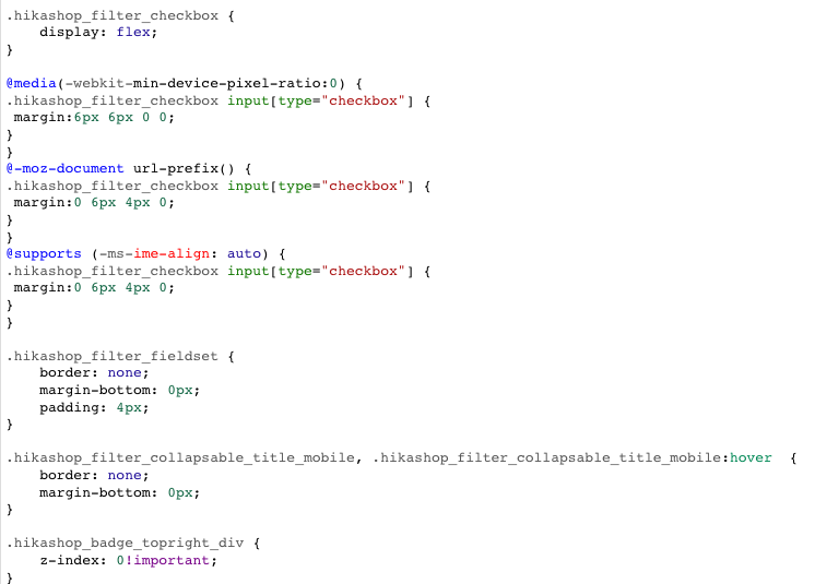

I never customized HIKA_FILTER_LIST_PREPEND and HIKA_FILTER_LIST_SEPARATOR, so that's not the reason it changed. I've changed hikashop_filter_checkbox (see screenshot for all changes) in display: flex. Otherwise the checkboxes will appear above the label instead of next to it for the unselected filters
Can you let me know if this is the proper way to show 'fa fa-times-circle' at the right of the selected filter label -> give span "filter_values_container" property -> display: ruby-text;
Cheers,
Remco

You can add such CSS and it will display relatively the same:
.hiakshop_filter_selected_list li, ul.hiakshop_filter_selected_list {
display: inline;
The following user(s) said Thank You: RustyHika
