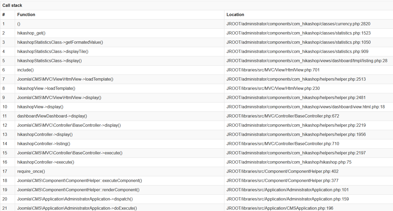

-- Error-message(debug-mod must be tuned on) -- : syntax error, unexpected end of file, expecting function (T_FUNCTION) or const (T_CONST)
I installed Hikashop Business on top of an allready installed Hikashop Starter. But then I get this error:
I tried installing Hikashop Business on een clean install, and that worked fine.
So how do I get this site working?

This indicates that the file administrator/components/com_hikashop/classes/currency.php is missing the end of the file.
This normally cannot happen with the install of the install package.
This usually happens when you do an install from a folder where you previously uploaded via FTP the extracted files of the install package, but you had a problem during the FTP upload which lead to at least this file not being uploaded completely.
If it's only that file, you can just overwrite it via FTP with the file back/classes/currency.php from the install package.
Otherwise, reuploading all the files of the install package and redoing the install will fix the problem for all the files.

I did not install through FTP, I installed through Joomla Extensions Upload package.
But I tried what you suggested, but I still get the same error.
I even tried to rename com_hikashop in Components and Administrator Componants. Installed again.
Still the same error.
When I do a clean install with Joomla and Hikashop Business, it works perfectly. But I allreaddy have 500+ products and 100+ categories in Hikashop Starter.
What you should know is that i have the site on a localhost. I uses Akeeba Backup to transfer the localhost site to ohsn-demo.nl. Everything works fine, untill I install Hikashop Business.
