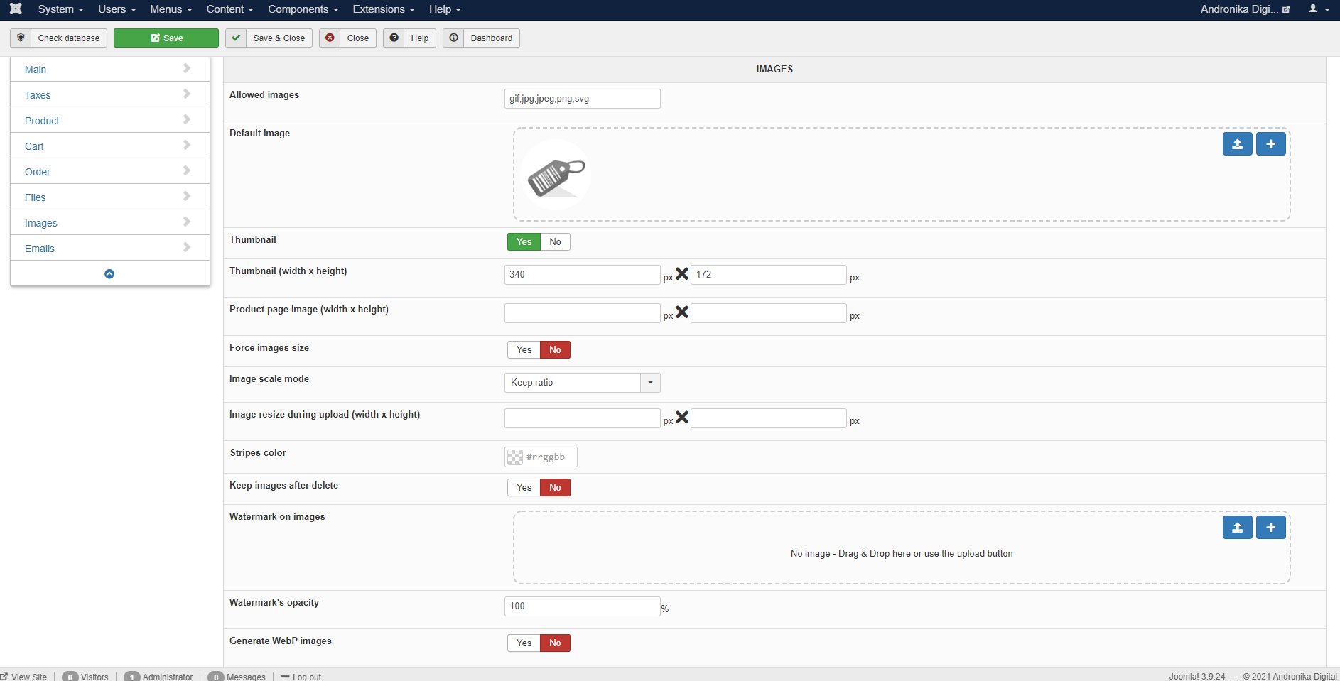

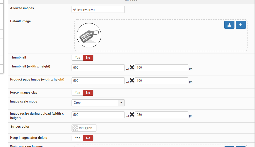

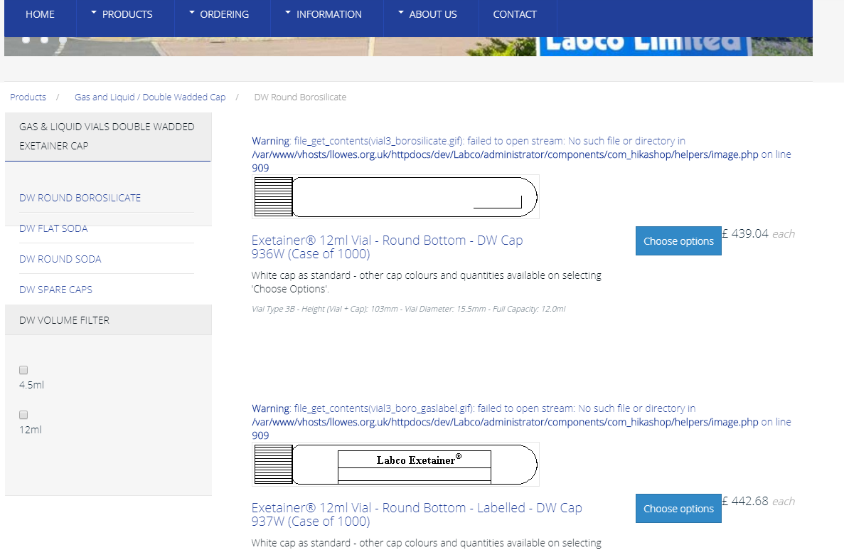

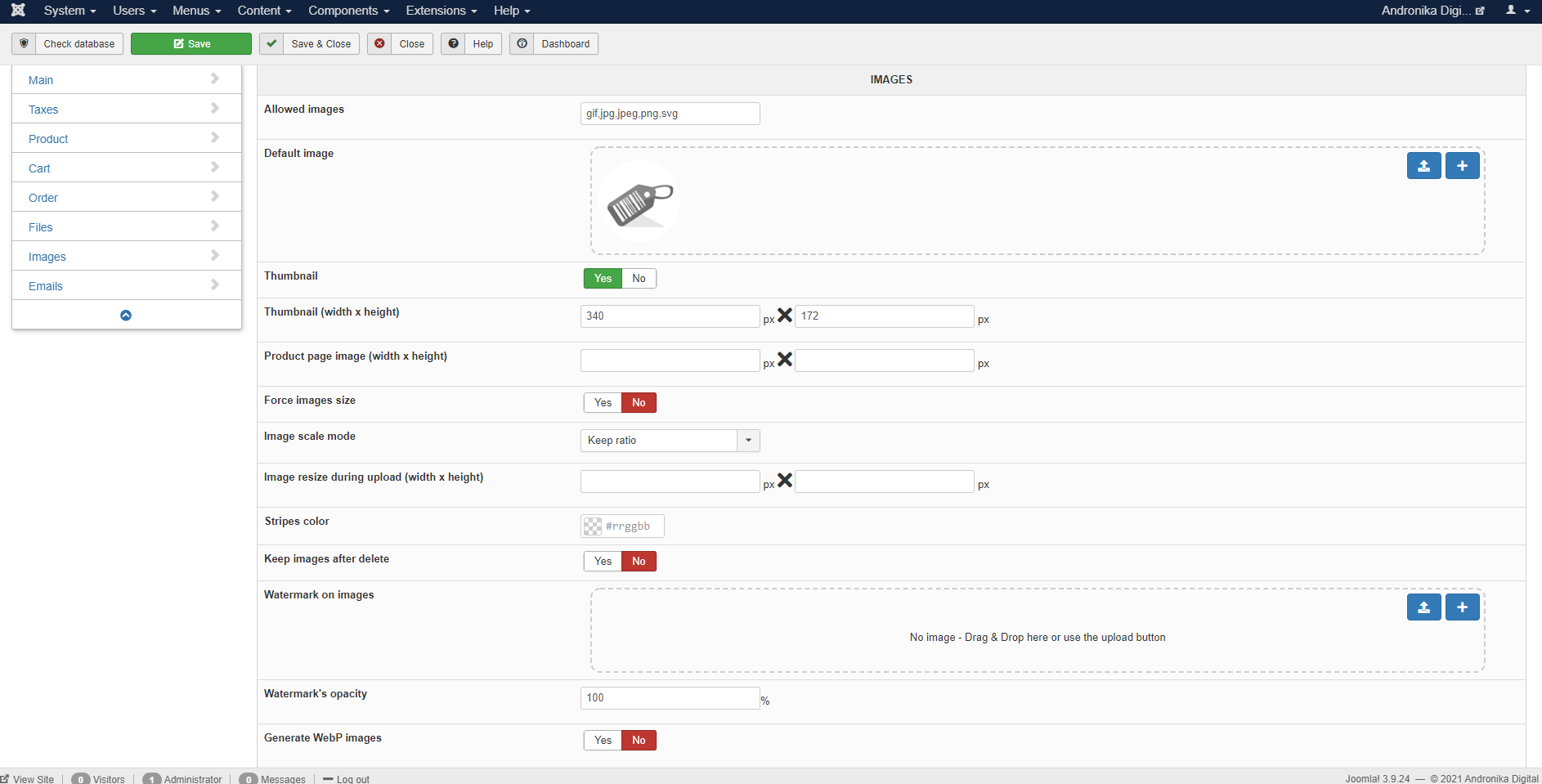

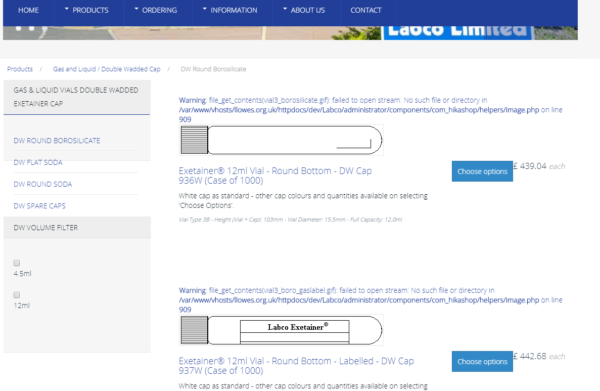

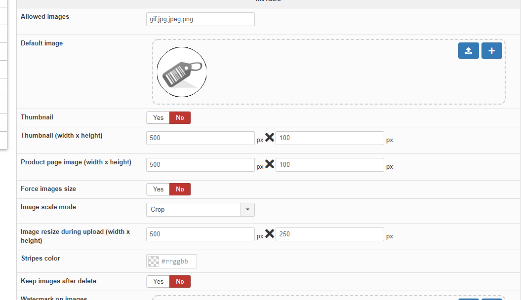

  • Posts: 33
5 years 6 months ago #330811
I have the same problem, the message 'Warning: file_get_contents(vial3_borosilicate.gif): failed to open stream: No such file or directory in /home/sites/4a/2/2bef3de369/public_html/administrator/components/com_hikashop/helpers/image.php on line 909' appears after upgrading to v.4.4.1.
I've checked the thumbnail size fields and there was already a value.
I have replicated the problem on a development server, so can give you access if you need.
I've attached a copy of the problem message and also the image configuration.
  • Posts: 86178
  • Thank you received: 14212
5 years 6 months ago #330814
I've reproduced the issue and in fact it only happens in some specific case based on your shop settings and how you configure the images.
I've added a patch for it. Download the install package on our website and install it on yours and it will add the patch for the warning.
The following user(s) said Thank You: iafdesign
