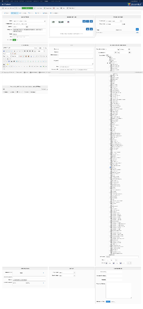

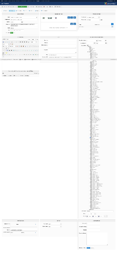

Ok this will get you into the site:
you can actually try it with any product, they all behave the same, but I've included the screenshot of the product settings of the url I provided.
