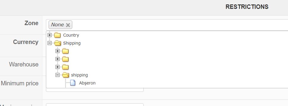

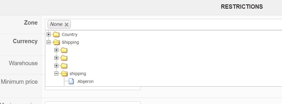

Restricting a shipping method to country - I seem to have run into problems
So my "Europe" shipping option seems to be available to select even if you put USA as your address - I have looked at the ZONES option in the shipping method restrictions but I can't see the "shipping zone" (EU shipping zone I created
) I wish to restrict it to - see screenshot.
Where am I going wrong?

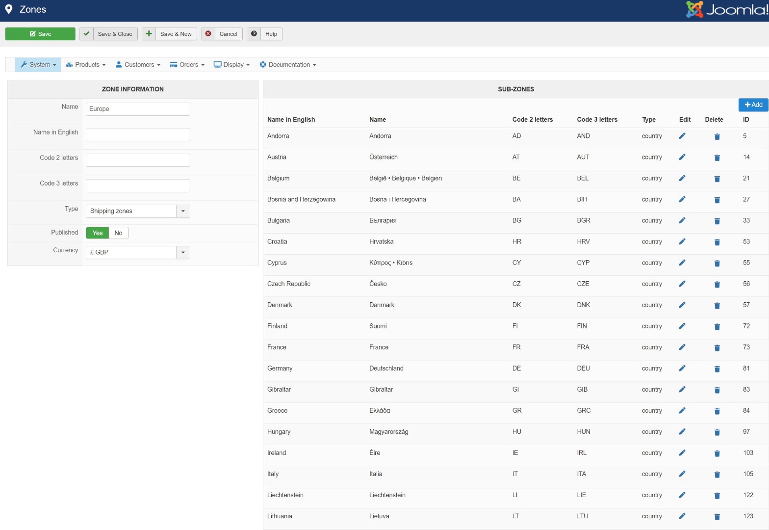

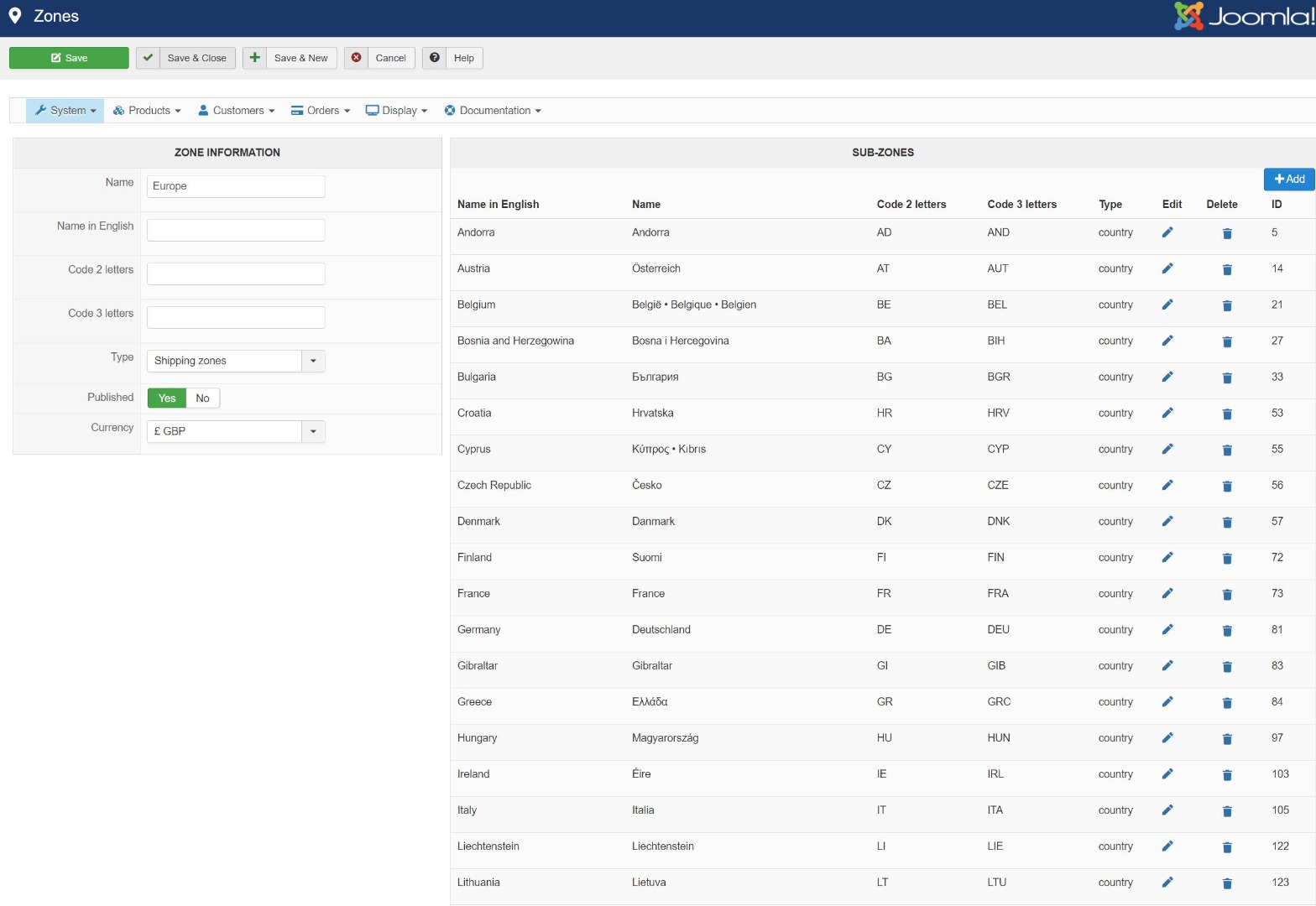

Could you provide a screenshot of the settings of your shipping zone in the System>Zones menu ?

Actually, there is a good chance that in fact, your shipping zone is there but without its name, let's detail what we mean :
In your Screenshot you haven't fill the "Name in English", and this is the name use to display in your Zone tree.
A little like this previous idea, we invite you to fill as well these inputs "Code 2 letters" & "Code 3 letters" in order to avoid this kind of issue in other page or use.
Hope this will help you to solve your issue.
