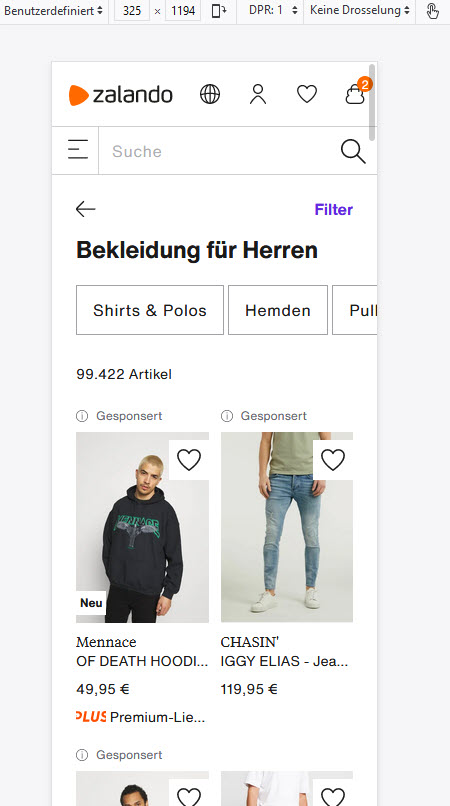

Support is looking into 2 column layout for 375px with module product list, but that is another forum post.
