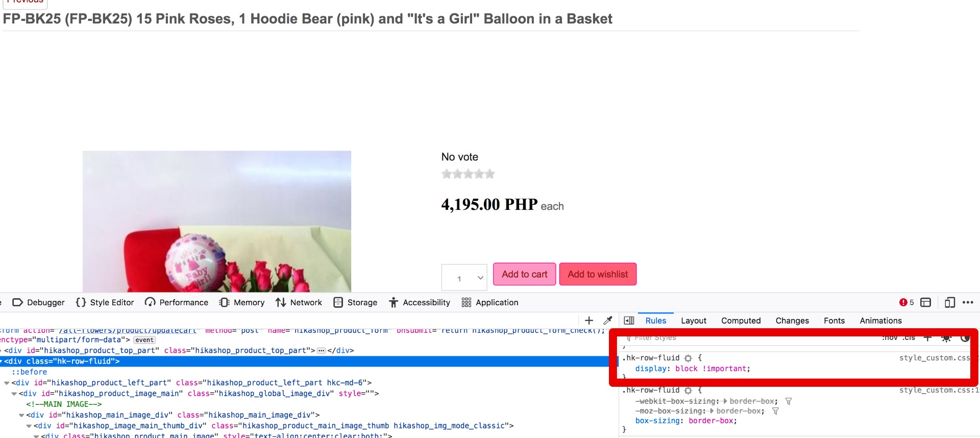

after updating hikashop to the latest version
the main product page was gone. after inspection the issue is with
hk-row-fluid the css is as follows
display: -webkit-box;
    display: -moz-box;
    display: box;
    display: -webkit-flex;
    display: -moz-flex;
    display: -ms-flexbox;
    display: flex;
    -webkit-flex-flow: row wrap;
    -moz-flex-flow: row wrap;
    list-style: none;
    margin: 0;
    padding: 0;
    text-rendering: optimizespeed;
i change it to this
.hk-row-fluid {
    display: block !important;
i feel that my changes was not appropriate.
i also inspected the code for
Original product / show_default.php and Override product / show_default.php
i can see that there are a lot of changes. So this is the second question. Are the updates not taking effect due to my overrides? i am having a lot of errors from google and was thinking it has something to do with my modifications and the update not taking effect.

1. Well, the CSS modification you had to do is linked with previous CSS you have in that style_custom.css file.
By default, the "styles for the frontend" setting is empty. So when you edit that CSS to add your own CSS, you should start from a blank file. It seems that you have in there a lot of positionning CSS, which should not be there as the positioning is handled by the main hikashop.css file that can't be overridden.
So I don't think your view override has anything to do with it.
I think you must have copied the CSS of HikaShop from an old version (the 3.2.0) in that style_custom.css file and then modified the CSS you wanted to modify in there so that your CSS would override the default CSS of HikaShop.
That's a dirty way of doing it.
A cleaner way would be to only add in there the CSS code you need to override the default CSS of HikaShop. That would be easier to manage in the long run and cause less issue when we change things.
