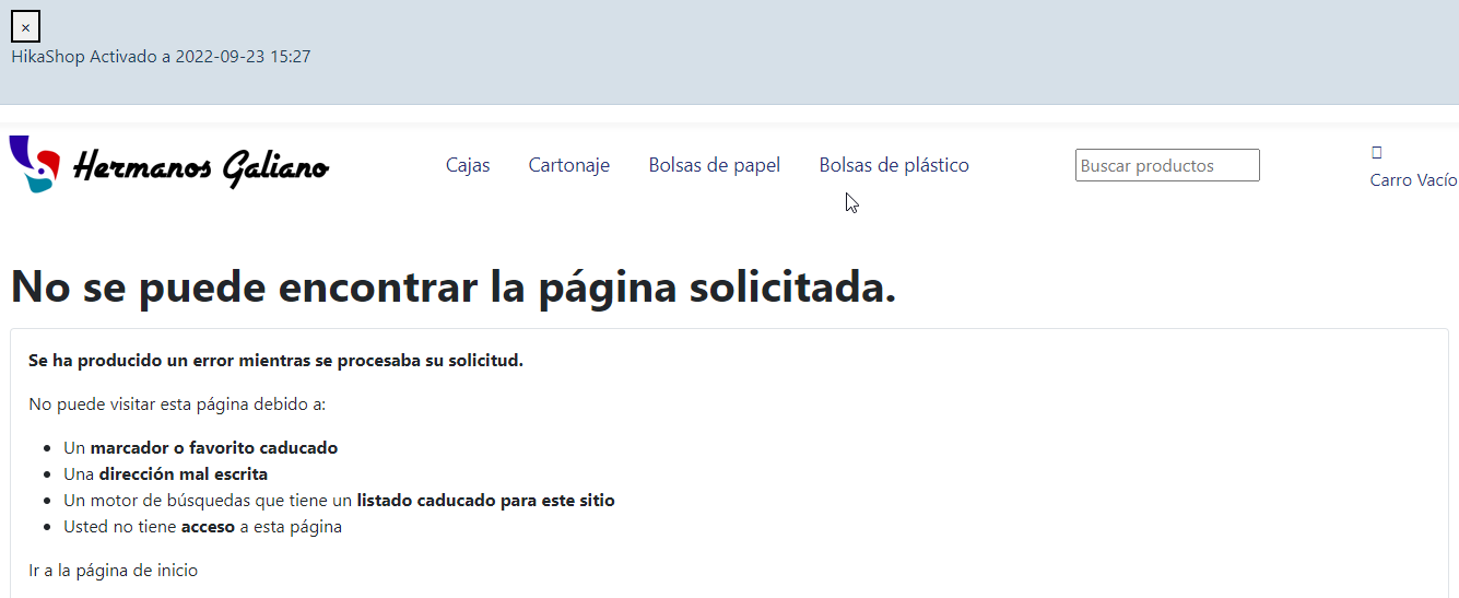

4 years 1 month ago #345034
by Reincidente
Replied by Reincidente on topic CRON
Hi Nicolas.
Excuse me for opening several tickets for you, but today we have done the migration and I want to tell you about things that I find.
When executing the cron URL, what you can see in the attachment appears on the screen.
I am also waiting for you to comment on the step from orders to confirmed.
Thanks!!
Thanks!!

4 years 1 month ago #345038
by nicolas
I can see on our end that the cron task has not been activated.
I've manually activated for you (normally, you can do it yourself from the Cron tab of the HikaShop configuration).
It should be working fine now.
