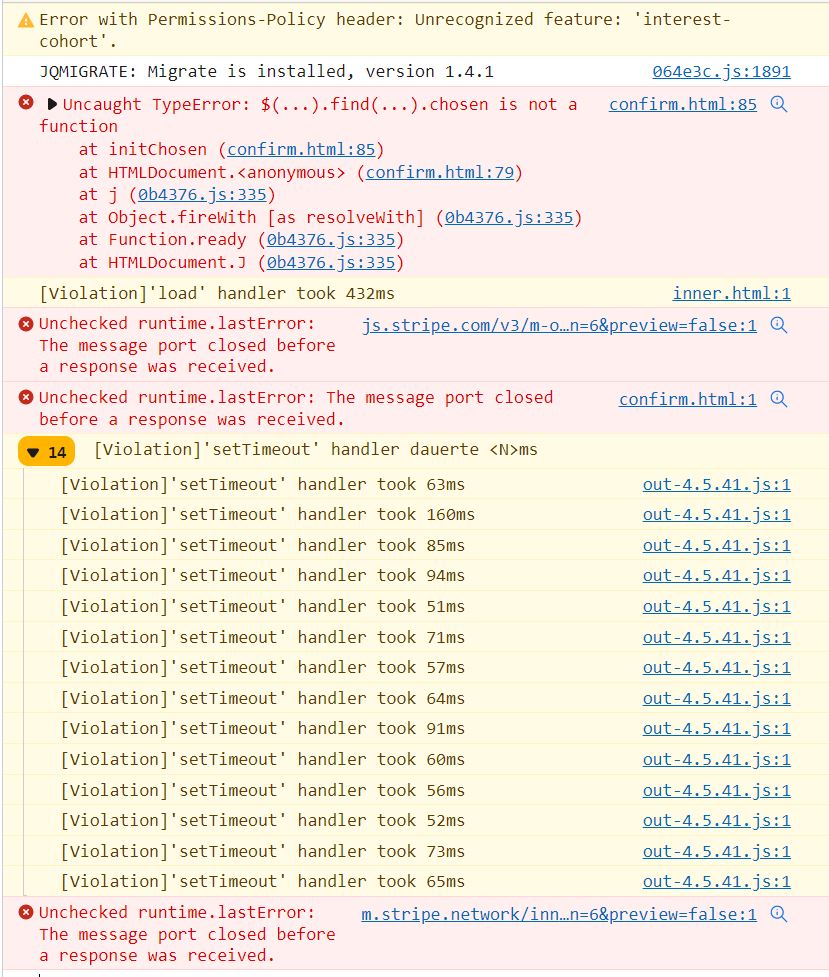

Yes, in the Emulation with mobile devices (MS Edge) I can reproduce the problem. The errors in the developer window are attached.

  • Posts: 86181
4 years 9 months ago #337882
The javascript error of your screenshot indicates a problem with the initilisation of the chosen library.
If you have the "user chosen library" setting activated in the HikaShop configuration, you can try turning it off and see if that helps.
