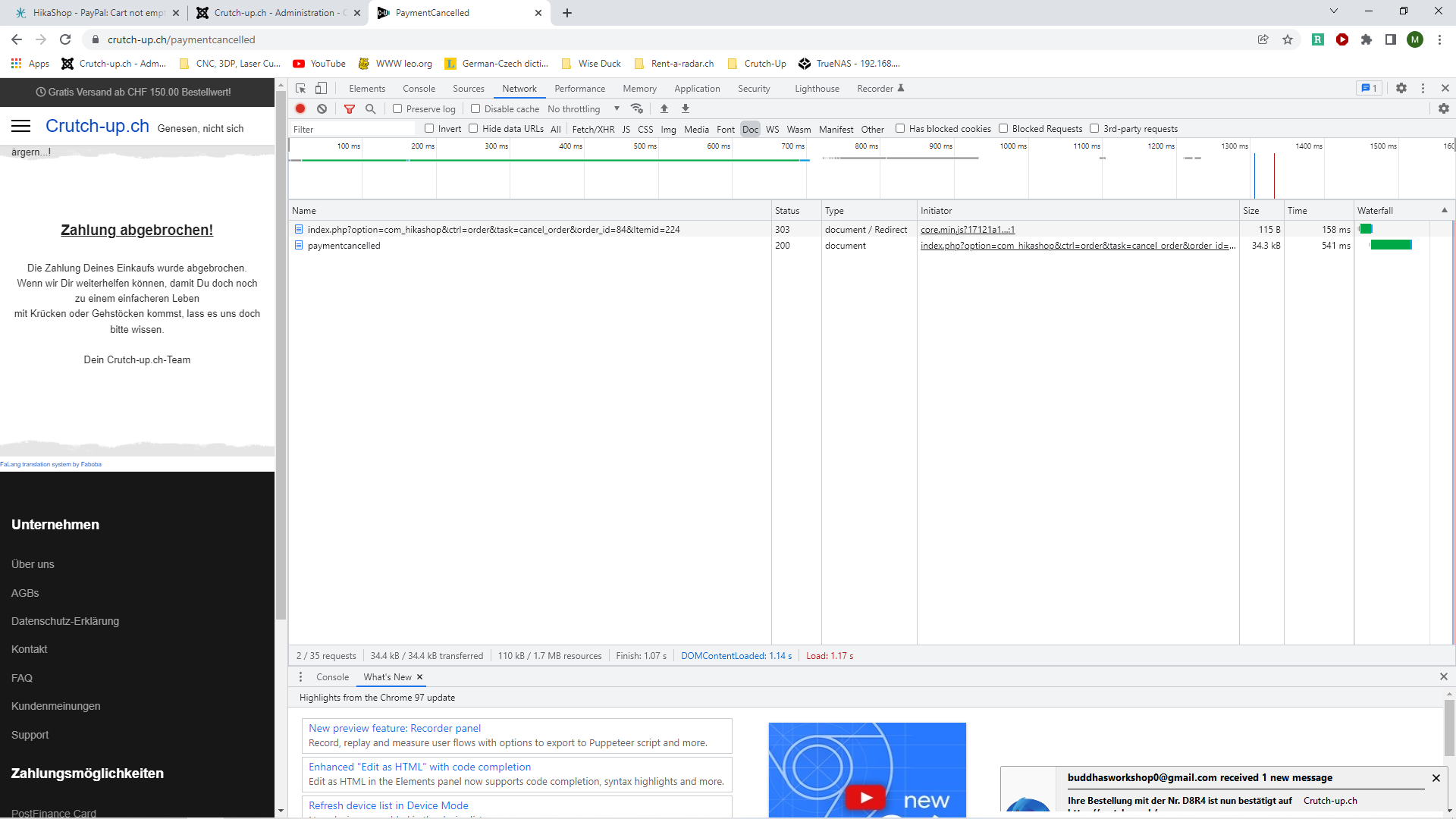

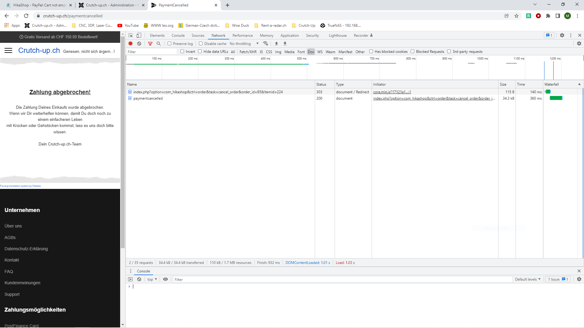

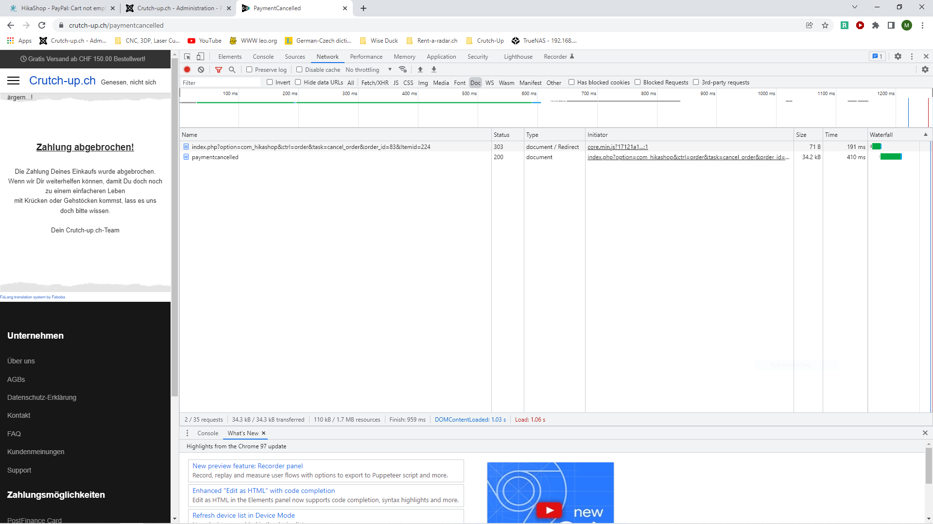

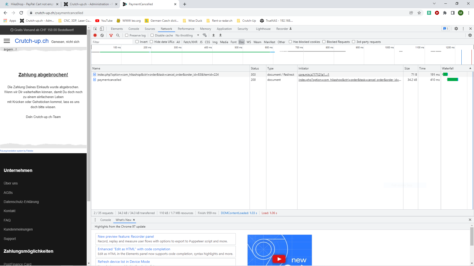

Could you try again these different scenarios and open the "network" tab of the console of your browser just before your click on the buton to validate the payment ?
In there, if you could filter with the "Doc" mode, we would be able to see a list of the different redirects being done.
Something like that:
i.imgur.com/ZswawCi.png
(with other URLs of course)
That would allow us to better grasp what is happening when you're leaving PayPal and going back to the website.

4 years 7 months ago #338792
Dear HIKA-Team,
So below are the screenshots, their title should be clear on which case it is:
- Was the payment a success or was it manually cancelled.
- Upon which setting is the cart (theoretically) cleaned.
- Where did my site lead me to after the above happened.
Let me please know if you need further details.
Kind regards et excellente journée,
Martin
