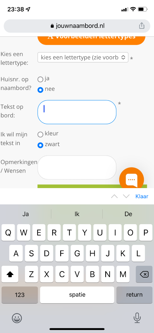

On any productpage the typepad won't disappear after entering a textfield on any iPhone. The button to lower the typepad doesn't respond at all. I contacted the Template developer first (Ivee Ecommerce), but he directed my to you, suggesting it could be related to a javascript conflict used for the product fields.

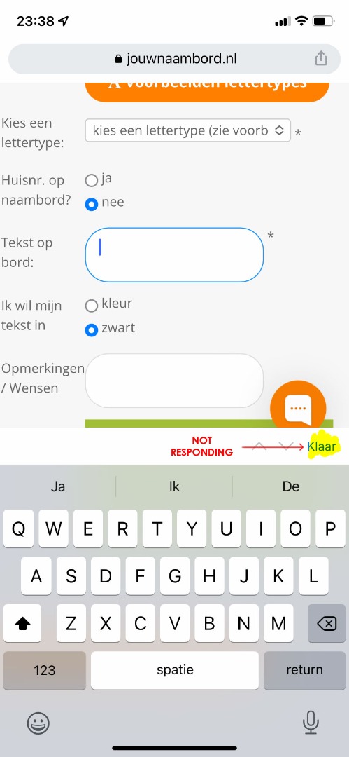

The typepad is the on-screen keyboard on a iPhone. When entering a field on any productpage or registrationform the keyboard pops up and won't lower when touching the "ready" button on the right. In the attachement you see the screenshot with the button highlighted.
