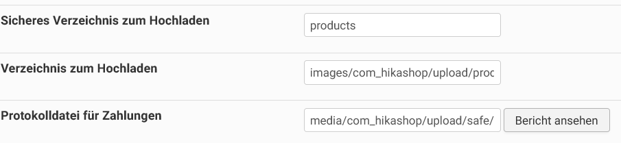

4 years 6 months ago #339789
see the configuration in the screenshot.. I can change all items, but not the company adress

4 years 6 months ago #339793
Then I don't know why it wouldn't work.
Could you provide a backend access along with a link to this thread via our contact form here:
That way, we can directly check on the situation there.
  • Posts: 86080
  • Thank you received: 14188
4 years 5 months ago #339808
Didn't you see the message
The weight unit "L" is not in the list of possible units : mg,g,dag,kg,t,lb,oz,ozt,l,ml,cl
when trying to save the configuration ?
That's because you had added weight units not in the list of possible units. I've removed the invalid ones and I can now modify the store address properly on your website.
