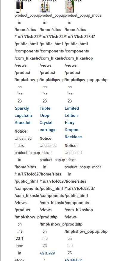

Anyway - with Debug set I got this error msg (on the Home page with Beez3)
Fatal error: Allowed memory size of 134217728 bytes exhausted (tried to allocate 67368631 bytes) in /home/sites/1a/7/7fc4c828d7/public_html/plugins/system/debug/debug.php on line 1247
So I knocked off the Debug - the main errors then showing up are all just relating to the catalogue of items available in the shop (unlike with the AT template, in Beez3 all the items are displayed on the Home page rather than their separate categories etc.
This error shows up above each item:
/tmpl/show_popup.php on line 23
Black Magic necklace
Notice: Undefined index: product_popup_mode in /home/sites/1a/7/7fc4c828d7/public_html/components/com_hikashop/views/product/tmpl/show_popup.php on line 23 AGJN01
Then further down the page is more along the lines of the screenshot - lots and lots of files with the same errors shown.

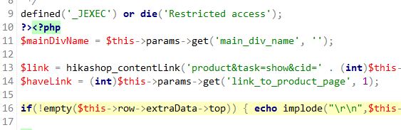

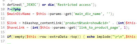

For the "0 syntax error, unexpected '='", we know were the error come from, see my screenshot :
Save on your side the code view, and analyze the code with a good code editor (which should point out your mistake).
But anyway remove this custom view will solve this issue.
Last edit: 4 years 5 months ago by Philip.
