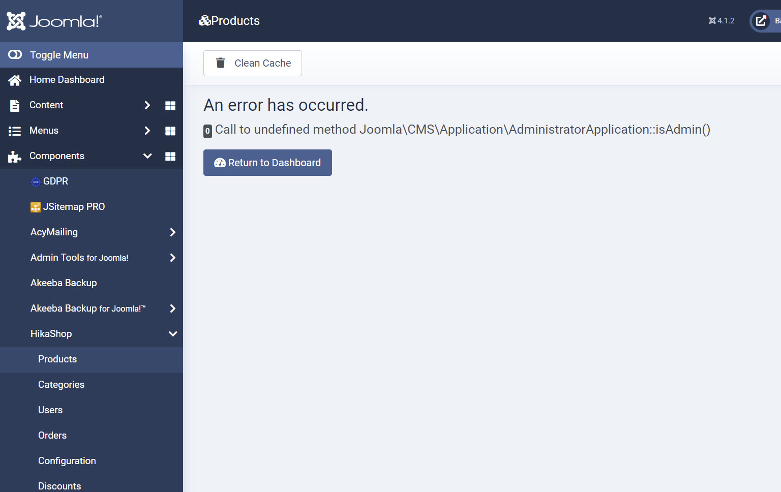

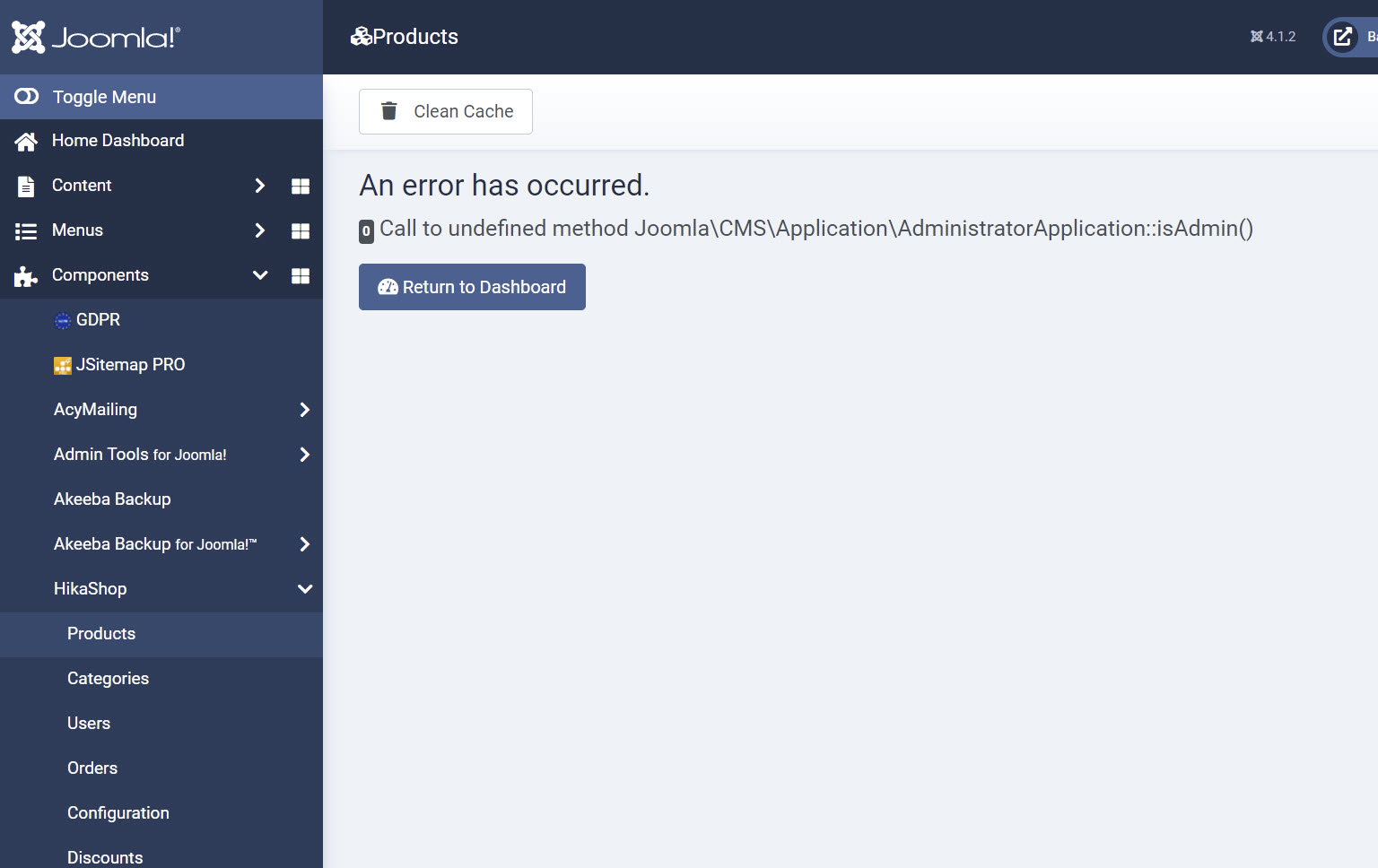

An error has occurred.
0 Call to undefined method Joomla\CMS\Application\AdministratorApplication::isAdmin()
We have installed Hikashop again but still we have this issue.
Hope you can help us.

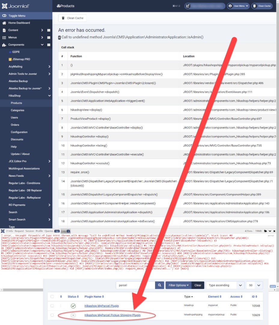

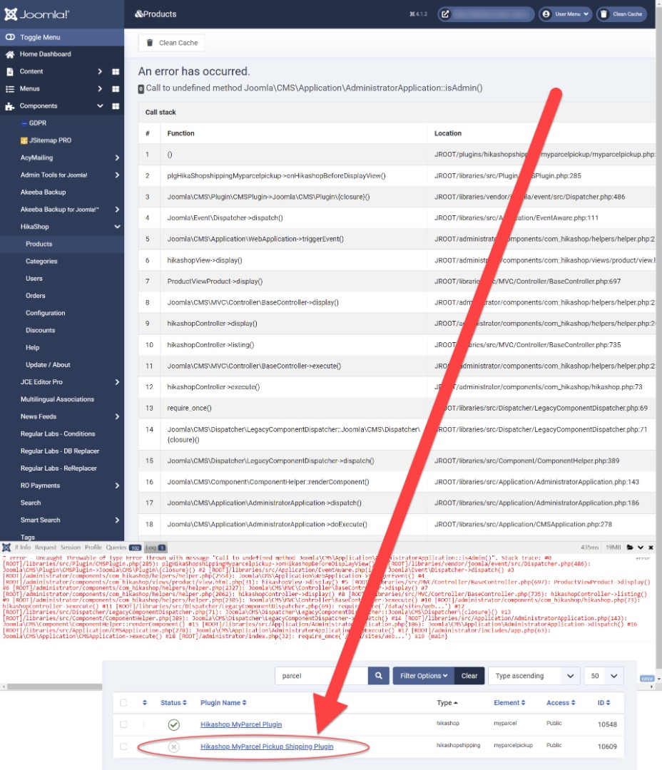

When turning on the "debug system" we saw that the MyParcel pickup plugin was the issue.
So we deactivated that plugin and then the issue was solved!!
But after downloading the newest version and turning the plugin on, the issue was not solved.

I was indeed able to reproduce the problem. Thank you for the screenshot.
I've uploaded a new version of the MyParcel Pickup plugin with a fix for this so download it again on our website and install it on yours to get the patch.
