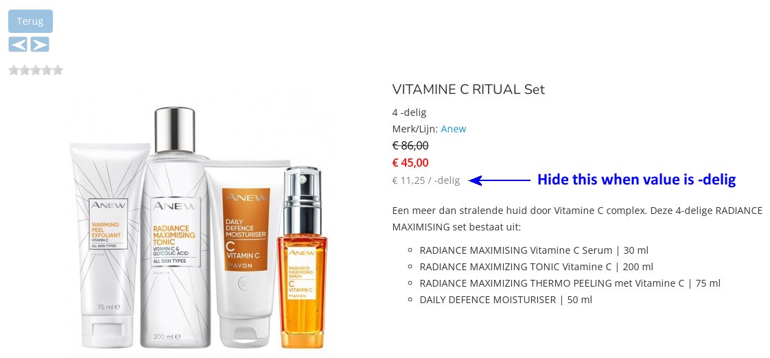

Hi Hika team,
I would like to enable the show weight per unit option on the product detail pages.
The problem is that I also sell product sets. I translated the dimension CL into -delig so it shows on the product listing page and the product detail page as for example 4-delig (means 4 pieces).
When I enable show weight per unit then -delig is also shown as per unit.
Is there a way to exlude this somewhere in the view that when the value is -delig than it won't show?
Thanks in advance.

Yes.
You can edit the file product / listing_price via the menu Display>Views and change the line:
if($this->params->get('show_price_weight')){
to:
if($this->params->get('show_price_weight') && !empty($this->row->product_weight_unit) && $this->row->product_weight_unit != 'cl'){

Works like a charm!
Again thank you very much Nicolas.
