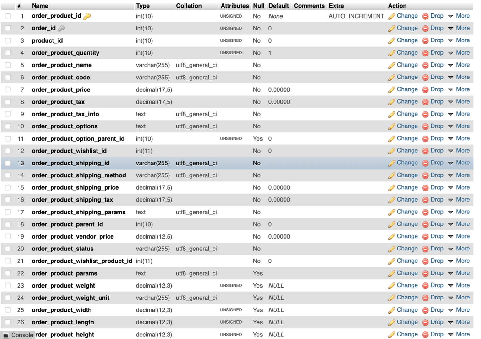

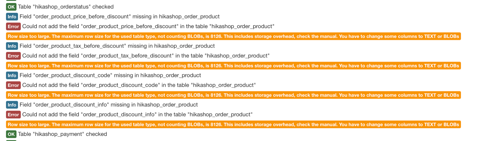

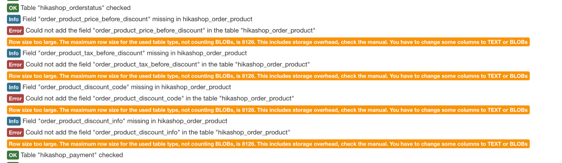

  • Posts: 58
4 years 3 months ago #341367
This is what I see when I run the CHECK DATABASE function:
  • Posts: 86080
  • Thank you received: 14188
4 years 3 months ago #341368
This indicates that you have too many columns in the hikashop_order_product and hikashop_cart_product tables.
I suppose that you must have created and deleted a lot of custom item fields in the past.
Go in your PHPMyAdmin and open these two tables and delete the columns of previously deleted custom item fields and it will then allow you to run the "check database" and the checkout will work again.

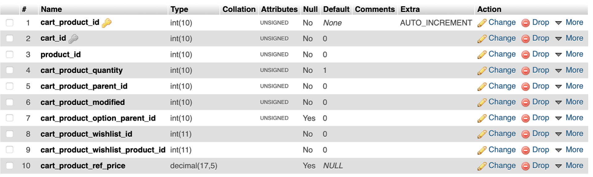

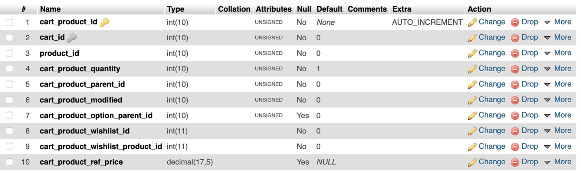

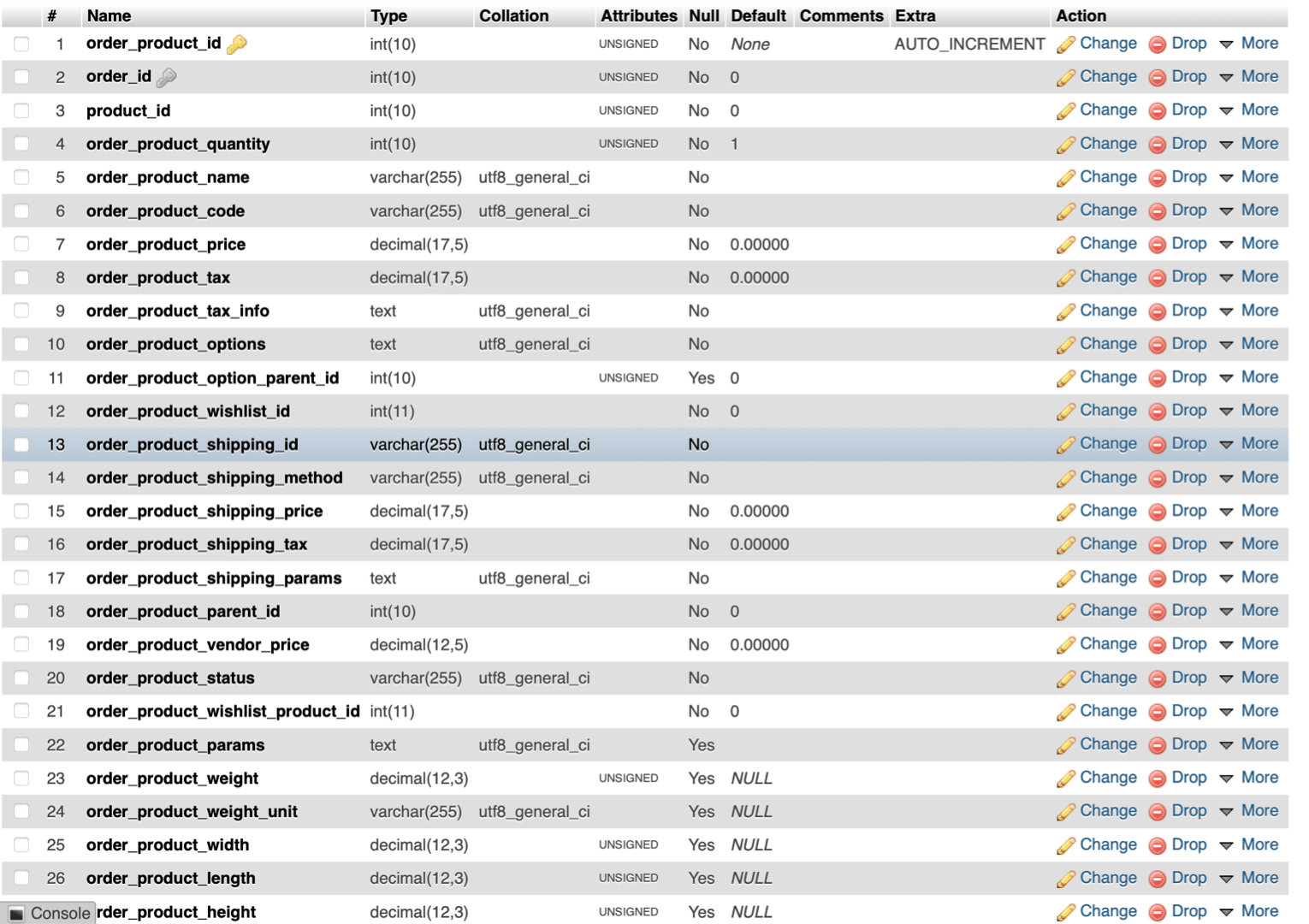

  • Posts: 58
4 years 3 months ago #341375
I got the columns - what do I actually delete now? There were many different people adding to this over the years. Thank you
  • Posts: 86080
4 years 3 months ago #341376
These are the default columns of the tables. Don't you have more columns in these tables ?
If not, then it's not a deleted custom field issue but a MySQL server setup issue.
Here is a page talking about this:
stackoverflow.com/questions/15585602/cha...l-row-size-too-large
There are several solutions proposed there.
The simplest is to run a small MySQL query to change the ROW_FORMAT of the tables:
ALTER TABLE `my_table` ROW_FORMAT=DYNAMIC;
However, this might not help and you might need to add an extra option like:
innodb_strict_mode=0
in your my.cnf file (the configuration file for the MySQL server).
But there are more potential solutions provided on that link.
Basically, it will require some tests to find what is the solution that works for you as it depends on how your MySQL server is configured.
