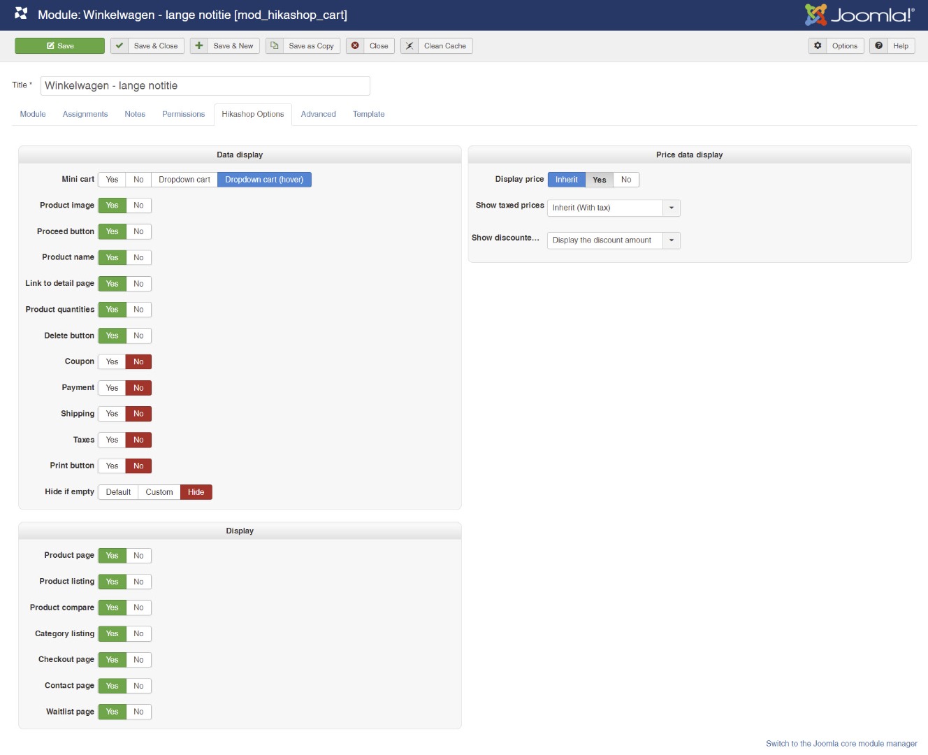

Our configuration:

In the module configuration "Drop downcart" and "Dropdown cart (hover)" makes no difference both have this issue.
