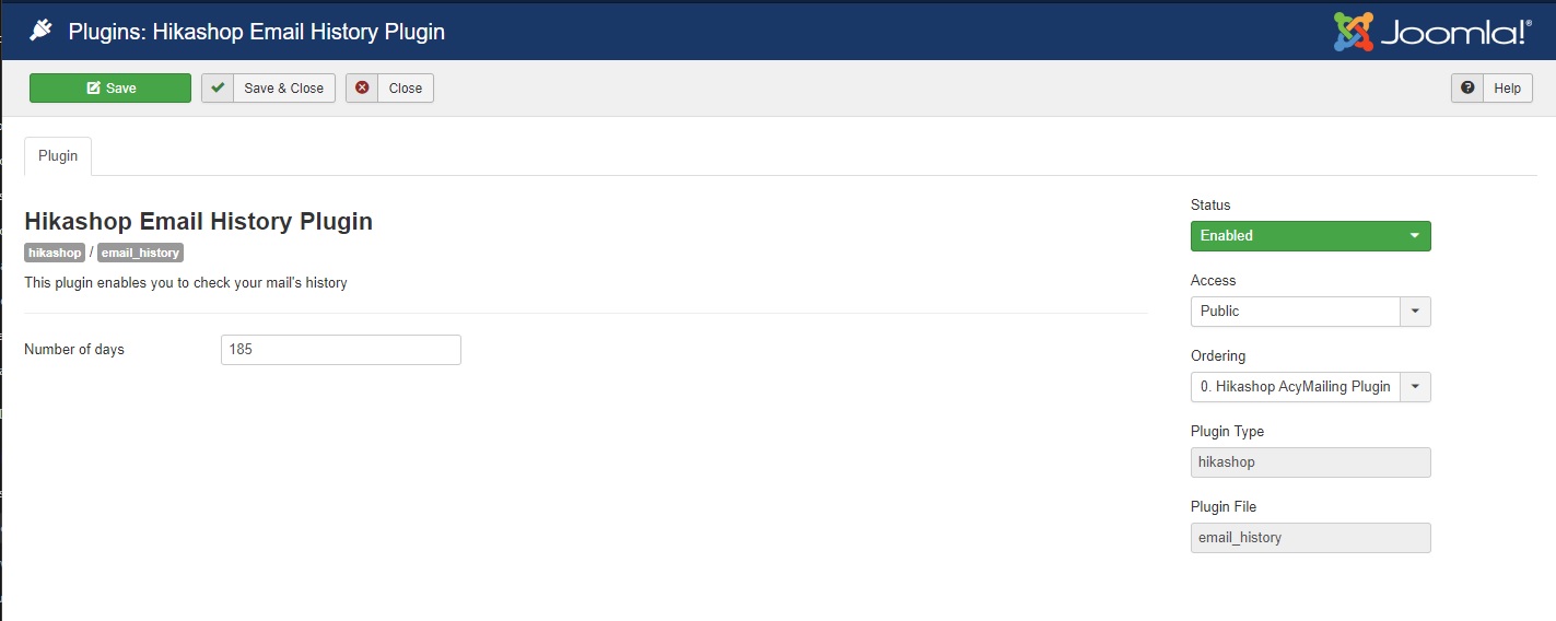

I may have just found the issue searching on many other terms for this problem. I will post again if it doesn't work after my Cron.
Found a post for Email History, and seems to be related so I will post once my Con finishes as I now have it set for roughly 6 months of logs after backing up the database.
  • Posts: 713
  • Thank you received: 37
4 years 2 months ago #342574
Ok...so setting it to 6 months did nothing, file is the same size it was previous to the cron. How can I fix this?
