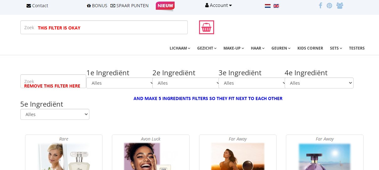

Dear Hika team,
I have a problem with one page with filters.It concerns this page:
I added filters on that page to narrow down the fagrances based on the ingredients.
They work fine except for the search filter who is supposed to be only on top of every page but it is also displaying near the other filters on that page and I don't know how to get rid of it.
Also I would like to have 5 filters for ingredients but I can not seem to get them next to each other because they are too wide.
So I tried with CSS to make them smaller but nothing happens.
3 years 11 months ago #343408
In order to have required filer entries in different container, more specifically your have 2 container :
1. On the top, the module with the Html Id :
#hikashop_filter_main_div_module_143
2. The filter inside your product listing with the Html Id :
#hikashop_filter_main_div_hikashop_category_information_menu_1476
From this, you will be able to "targeted" the required elements in order to choose to hide (or not) for each case :
With :
.hikashop_filter_ZoekopProductCode_1 {display: none;}
=> Both will be hide
With :
#hikashop_filter_main_div_hikashop_category_information_menu_1476 .hikashop_filter_main.hikashop_filter_main_ZoekopProductCode_1 {
  display: none;
=> Only in the product listing.
For the width, we process a little like previous :
With the same container id and by targeting the "select" :
#hikashop_filter_main_div_hikashop_category_information_menu_1476 select {
  width: 195px;
Hope this will help you to achieved your display.

3 years 11 months ago #343427
Perfect! Works like a charm.
Thank you very much.
The only thing was that the filters where overlapping on smaller screens so I also added a media query for that. Maybe it will help others who have the same problem.
/*Tablet Query*/
@media only screen and (min-width: 768px) and (max-width:1200px) {
  width: 125px;
Once the screen gets smaller the filters will collapse.
Thank you Philip. You made my day.
Last edit: 3 years 11 months ago by HSD. Reason: Edit for typo
