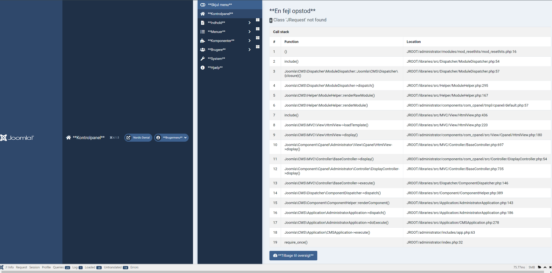

-- Error-message(debug-mod must be tuned on) -- : After updating to joomla 4. I cannot enter Hikashop.

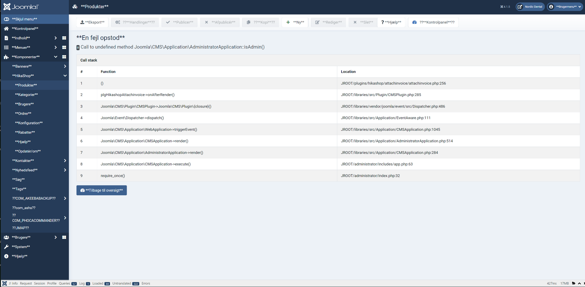

Call to undefined method Joomla\CMS\Application\AdministratorApplication::isAdmin()

We think we have a solution for at least the second error screen try to unpublished the pdf invoice plugin ( HikaShop - generate PDF invoice) in Joomla System, Manage => Plugins.
For the first screenshot try to unpublished the component Reset hits .
If this works for each error, for generate PDF invoice, this may means that for a reason or another when you update your HikaShop the plugins folder can't be updated (folder in read mode only?), as in our mind this plugin is fully compatible with J4.
You can try to update your plugin by download it again the plugin (from relative order, My account => My orders) and by using the Joomla install process.

Also now getting isAdmin error on attatchinvoice
0 Call to undefined method Joomla\CMS\Application\AdministratorApplication::isAdmin()
JROOT/plugins/hikashop/attachinvoice/attachinvoice.php:131
Seems to me you have issues with the call isAdmin throughout Hikashop

2. The error in /plugins/hikashop/attachinvoice/attachinvoice.php is because you're using an old version of the PDF invoice plugin.
For all the plugins sold on our marketplace ( www.hikashop.com/marketplace.html ), including the PDF invoice plugin, you get 4 years of free download of the latest version of the plugin after your purchase. After that 4 years period, if you need download the latest version of the plugin, you need to purchasing it again.
This is a way better deal than having to pay around 40% of the initial cost every year than what we do for HikaShop, HikaSerial or HikaMarket.
So since you first purchased it in 2015, that 4 years period is expired and you would have to repurchase it again to get access to the latest version again.

Yes I found out about Reset hits and student the back end was ok:-)

Even if you update HikaShop, you need to update the PDF invoice plugin separately as it is not included in HikaShop.
If you don't use the plugin, you can just disable it.
Do you know for sure all the plugin from Hika I need to unpublish because it do not work with J4?
All the plugins included in HikaShop are compatible with Joomla 4 if you have a recent version of HikaShop. So you don't need to unpublish them. The PDF invoice plugin is not included by HikaShop and needs to be updated separately.

I just forgot to specify earlier that indeed Attachinvoice (pdf invoice) was not provided with HikaShop and therefore had to be updated separately and by yourself (in order to solve your error message).

"Attach Invoice to the order confirmation e-mail" I can uninstall this too.

You can uninstall the PDF invocie plugin if you don't need it, yes.
Note however that for plugins included in HikaShop, like the system / hikasocial plugin, HikaShop will install/update them on each update of HikaShop. So if you uninstall itit instead of disabling it, you'll get it back next time you update your HikaShop.
