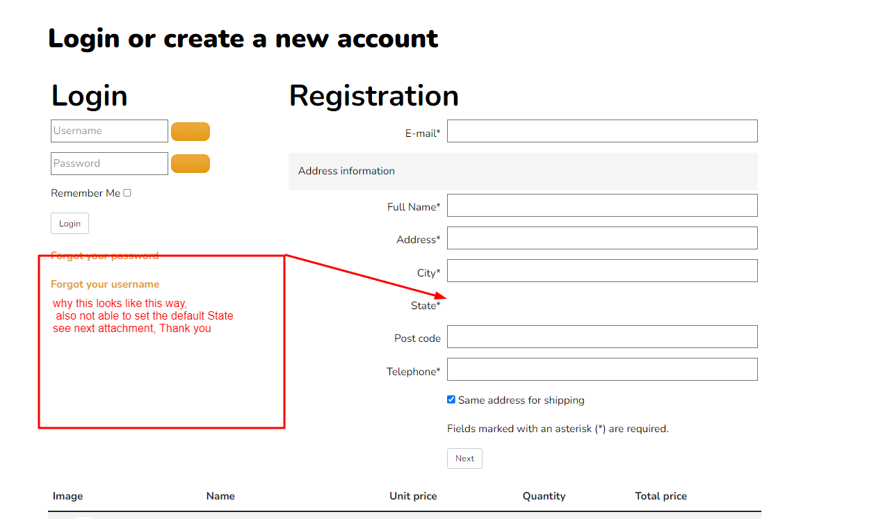

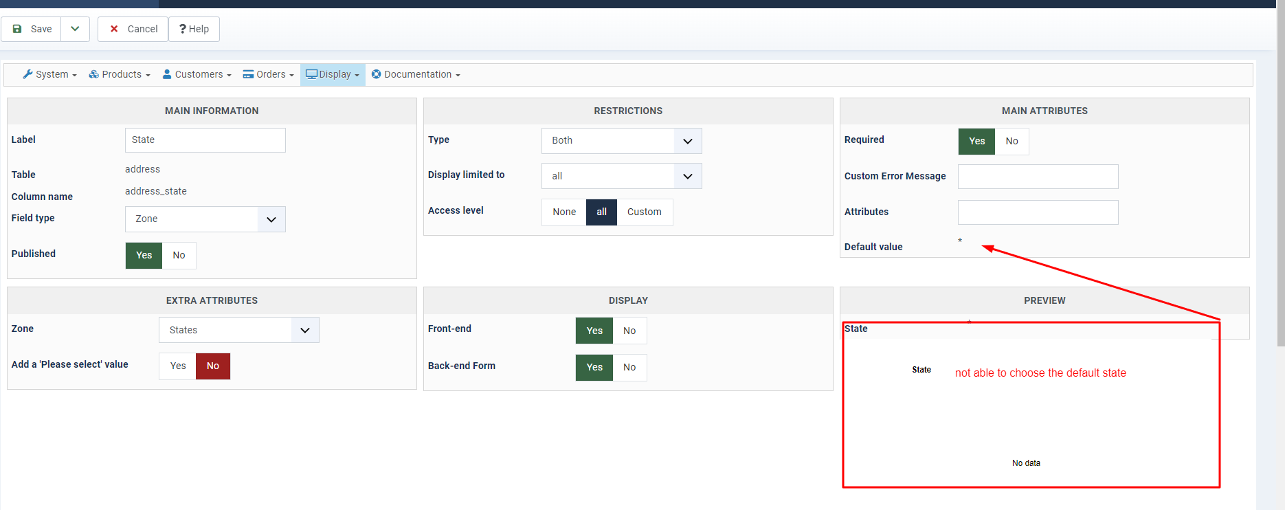

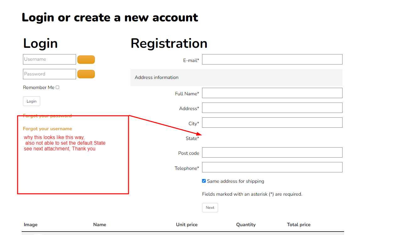

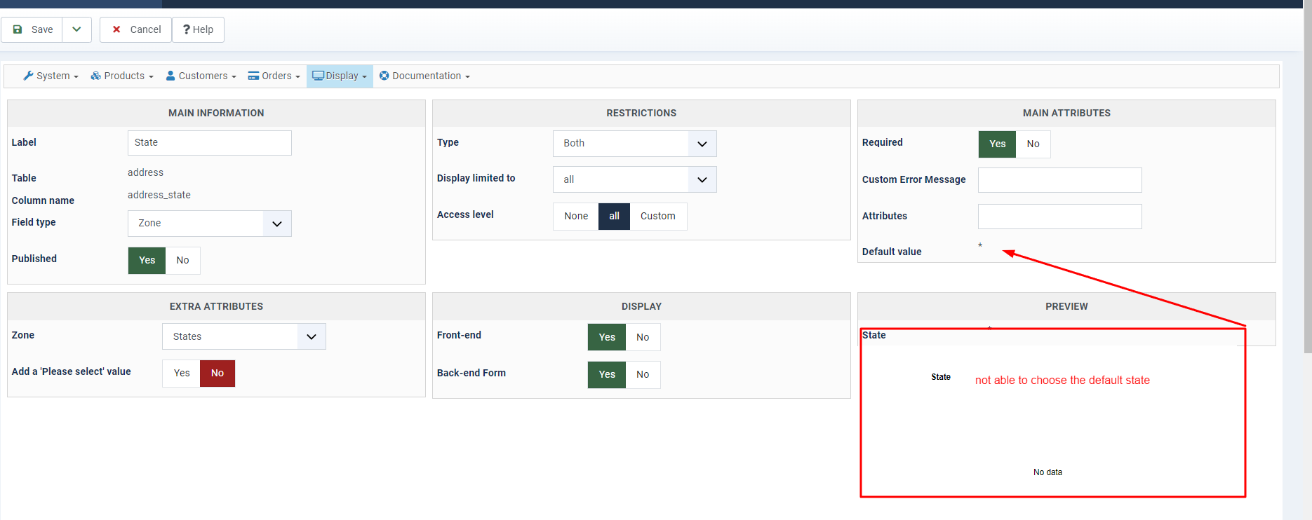

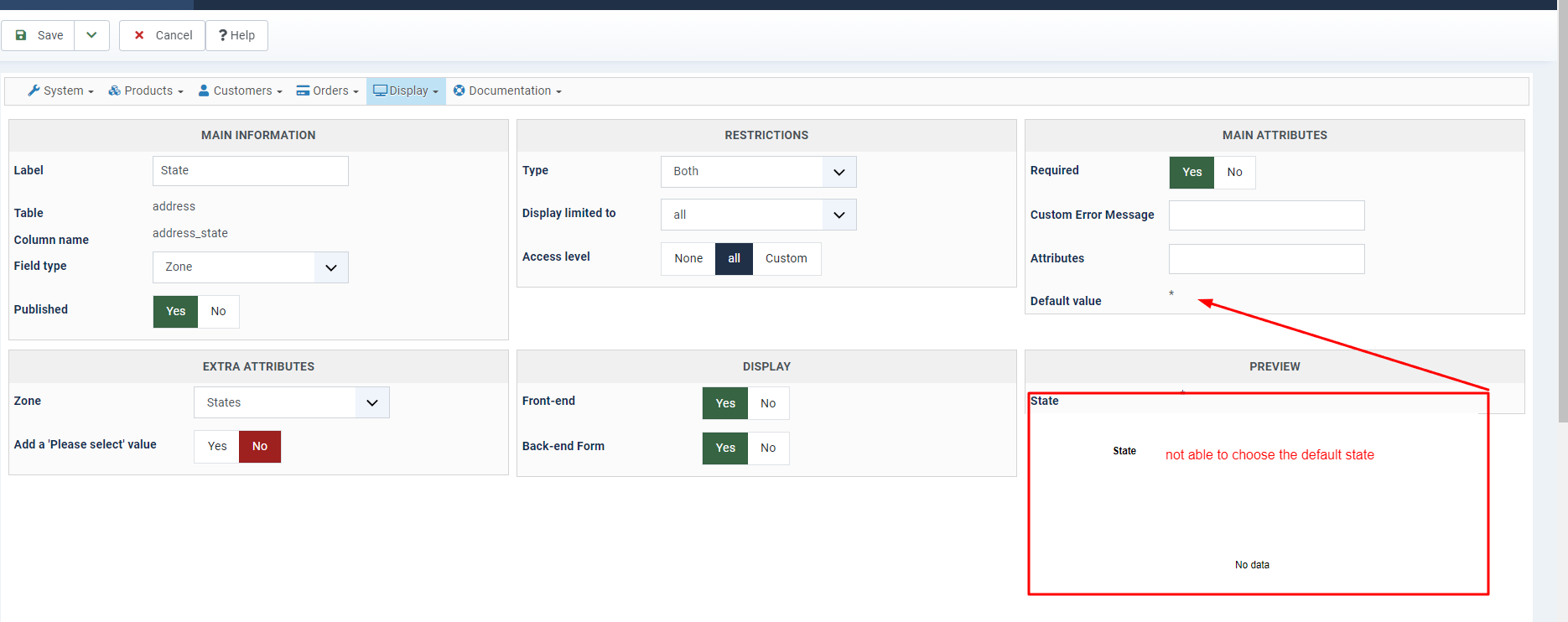

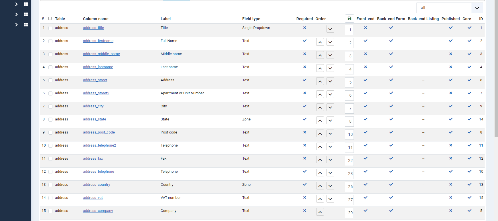

hello Hikashop Team,
we have an issue to put the registration in a certain order, not sure if is that related to the ID number or what? see attachment, also the state comes empty you can not choose, and finally, the area where you choose the default state has a star and you can not change,
please see the attachment, thanks
  • Posts: 86080
  • Thank you received: 14188

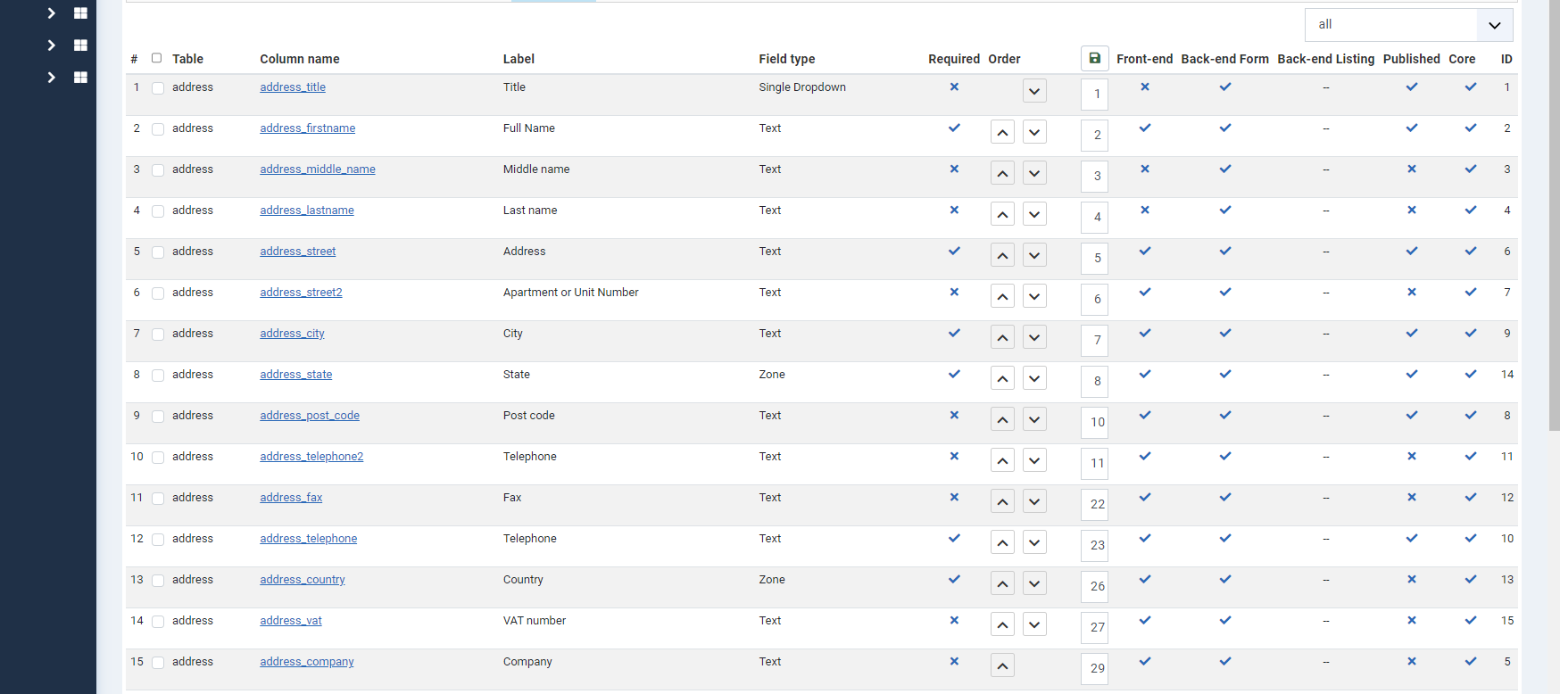

3 years 11 months ago #344741
Edit the "address_country" field and select the country you want to be used for the states in the "default" setting.

3 years 11 months ago #344756
Hello, the country already chosen but the state has a * as in the pic which is you can not edit, see the pic again , keep in mind that both are published

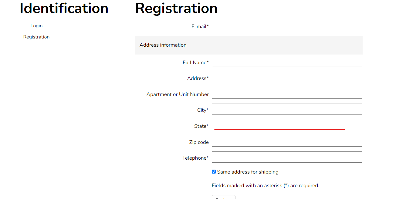

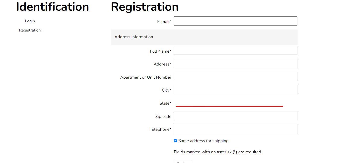

3 years 11 months ago #344757
see this pic from the front end

3 years 11 months ago #344758
Make sure that the correct country is selected as default and save it once.
If that doesn't display any state in the state field, then it means that the country zone configured as default in the country field doesn't have any published state zones as sub zones in the menu System>Zones. So please check there.

3 years 11 months ago #345150
Hi, for other people knowledge, I reinstalled Hikashop and it works perfect, nothing will effect your prior work , Thanks
