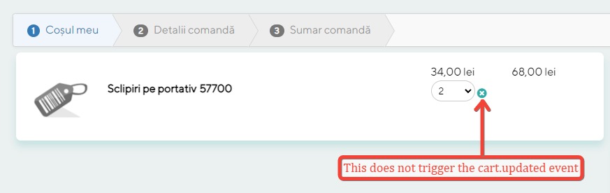

3 years 10 months ago #345634
I don't know if I should create a new topic or to continue here with the JS events :silly: , for now, I will continue here.
In the checkout the cart.updated is not called when I remove a product from cart, I know that for the checkout checkout.cart.updated it is the evenet that is triggered, but this event it doese't have any paramater regarding the product that was removed from the cart, same thing with cart.empty.
cart.updated get triggered only if the product it is removed from cart using the cart module.
In my remarketing implementation, I need to know the id and quantity of the product I remove from cart.
Thank you for your time.

3 years 10 months ago #345639
It would require calculating the changes in the function validate of the file administrator/components/com_hikashop/helpers/checkout.cart.php in order to add the extra information in $eventParams before the call to the addEvent function.
I guess it will be a few dozen lines of PHP.

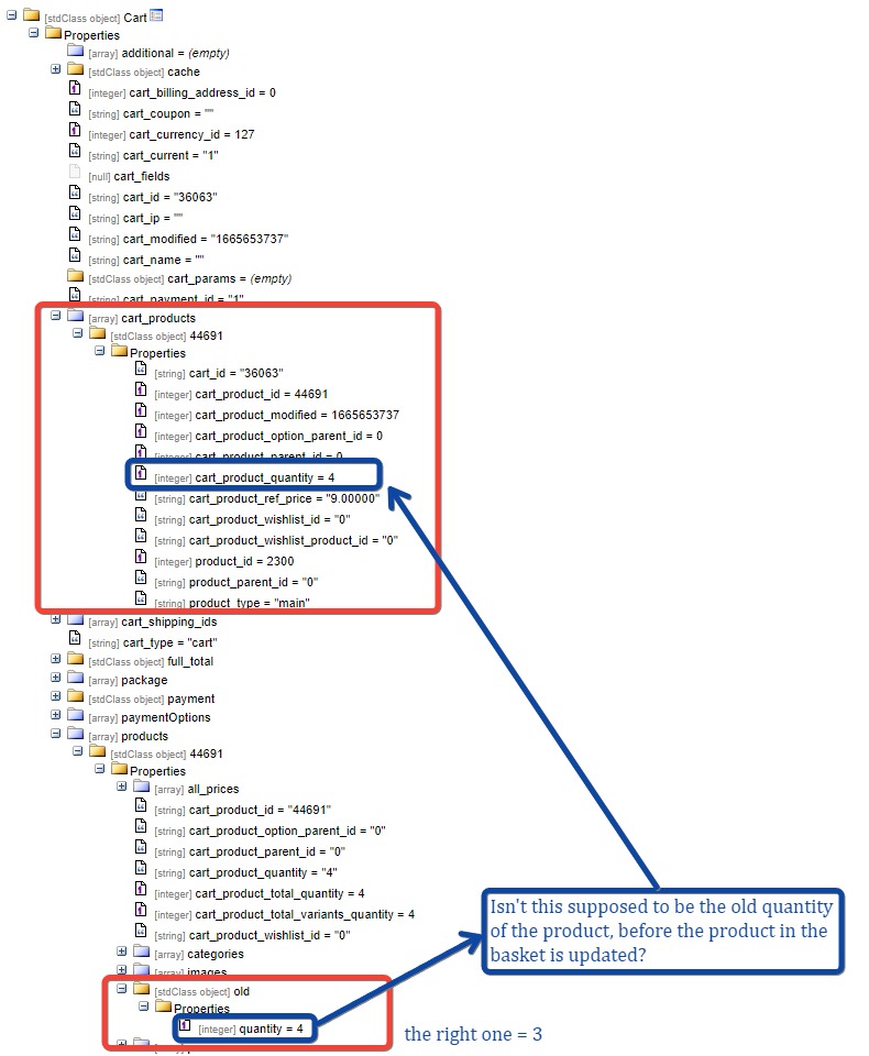

Nicolas, when I dump($cart) in validate function I have this (I will paste only what I think is needed)
SdClass Object (cart)
 [array] cart_products
- [stdClass object] 44691
--Properties
 ---[string] cart_id = "36063"
 ---[integer] cart_product_id = 44691
 ---[integer] cart_product_modified = 1665653737
 ---[integer] cart_product_option_parent_id = 0
 ---[integer] cart_product_parent_id = 0
 [---[integer] cart_product_quantity = 4
 ---[string] cart_product_ref_price = "9.00000"
 ---[integer] product_id = 2300
 [array] products
--Properties
 ---[array] all_prices
 ---[string] cart_product_id = "44691"
 ---[string] cart_product_option_parent_id = "0"
 ---[string] cart_product_parent_id = "0"
 ---[string] cart_product_quantity = "4"
 ---[integer] cart_product_total_quantity = 4
 ---[integer] cart_product_total_variants_quantity = 4
 ---[stdClass object] old
 ----Properties
 -----[integer] quantity = 4  // <==== Isn't this supposed to be the old quantity of the product, before the product in the basket is updated?

3 years 10 months ago #345664
You should make a copy of $cart->products before the line $ret = $cartClass->updateProduct($cart->cart_id, $items); like this:
$oldProducts = hikashop_copy($cart->products);
Then, before the addEvent, you can compare $oldProducts and $cart->products
