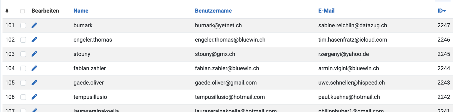

  • Posts: 50
3 years 10 months ago #345411
The joomla users and hika users do not match.
Is there a way to delete all hika users and resynchronise them with the joomla users?

  • Posts: 50
3 years 10 months ago #345418
Yes, I have imported the joomla users with a tool.
I checked the database but the IDs are still not correct and I still have users without names and usernames.
OK Table "hikashop_address" checked

  • Posts: 50
3 years 10 months ago #345586
I still have the problem that the users do not match the email address.
  • Posts: 86080
  • Thank you received: 14188
3 years 10 months ago #345601
That's strange, you have the email address of the user as username ?
In that case, run the MySQL query:
UPDATE `#__hikashop_user` AS hku LEFT JOIN `#__users` AS ju ON hku.`user_email`=ju.`username` SET hku.`user_cms_id`=ju.`id` WHERE hku.`user_cms_id`!=ju.`id`
via your PHPMyAdmin (make sure you replace #__ by your table prefix in the Joomla configuration and it should help).
