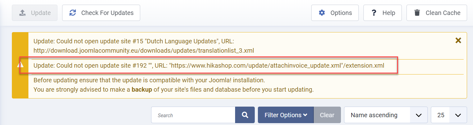

Hi Supportteam,
We see this issue on the update page.
How can we fix this?

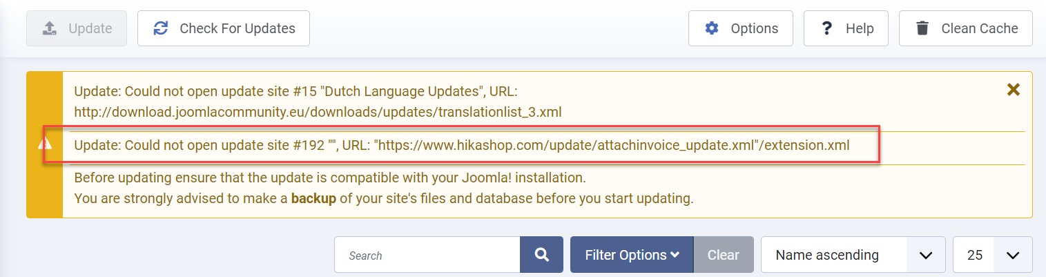

Unfortunately that didn't help, after installing the new version and clearing the cache and trying several times. I keep seeing the following error:
Update: Could not open update site #192 "", URL: " www.hikashop.com/update/attachinvoice_update.xml"/extension.xml

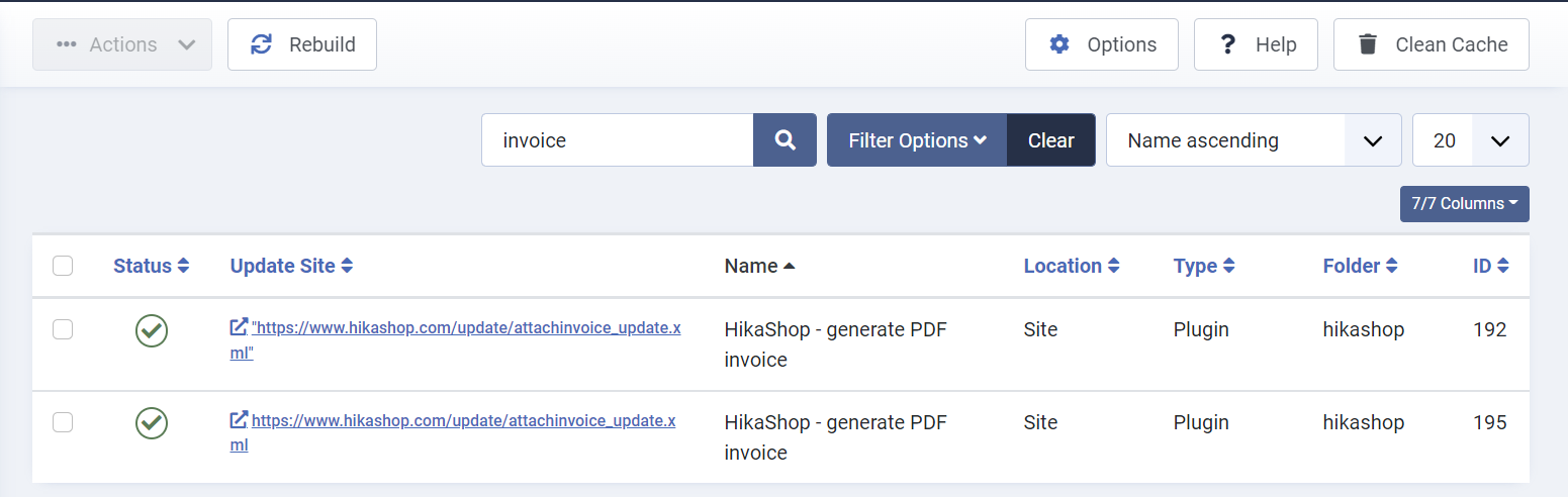

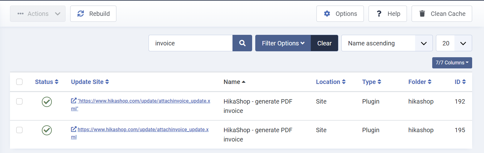

Ok, let's go with a different approach.
Go in the System menu of your backend and then "Update sites". There, delete the faulty entry. Then, download again the install package of the PDF invoice plugin from our website and install it again on yours and it will fix the problem.
  • Posts: 637
  • Thank you received: 26
3 years 8 months ago #347107
Deleting ID 192 was enough to fix the issue.
