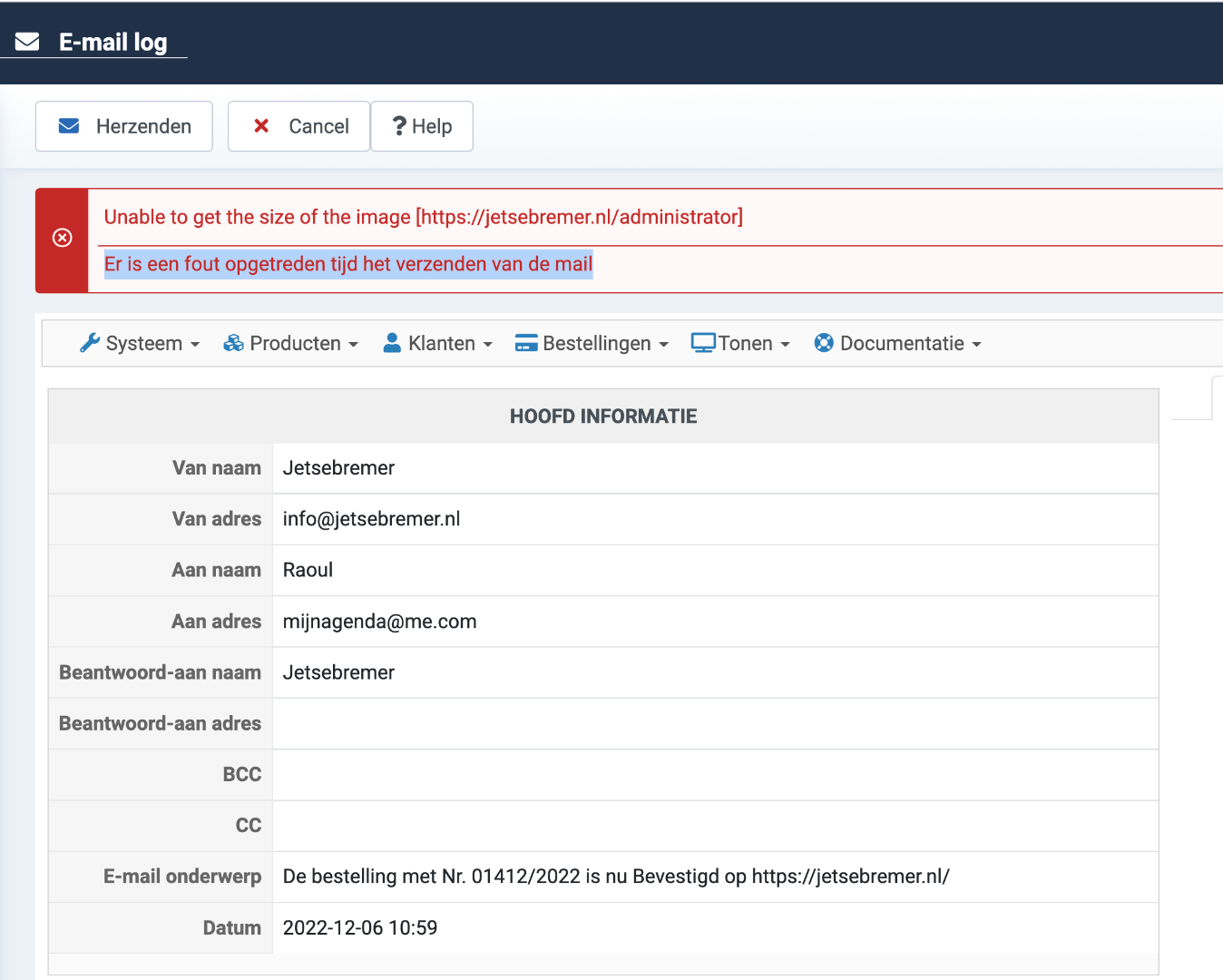

I see now that the mail is created but if I want to resend it I see this error > Unable to get the size of the image [ jetsebremer.nl/administrator ]
Er is een fout opgetreden tijd het verzenden van de mail

Hi, We still run in the same error after the patch. See screenshot if I try to resend the email.

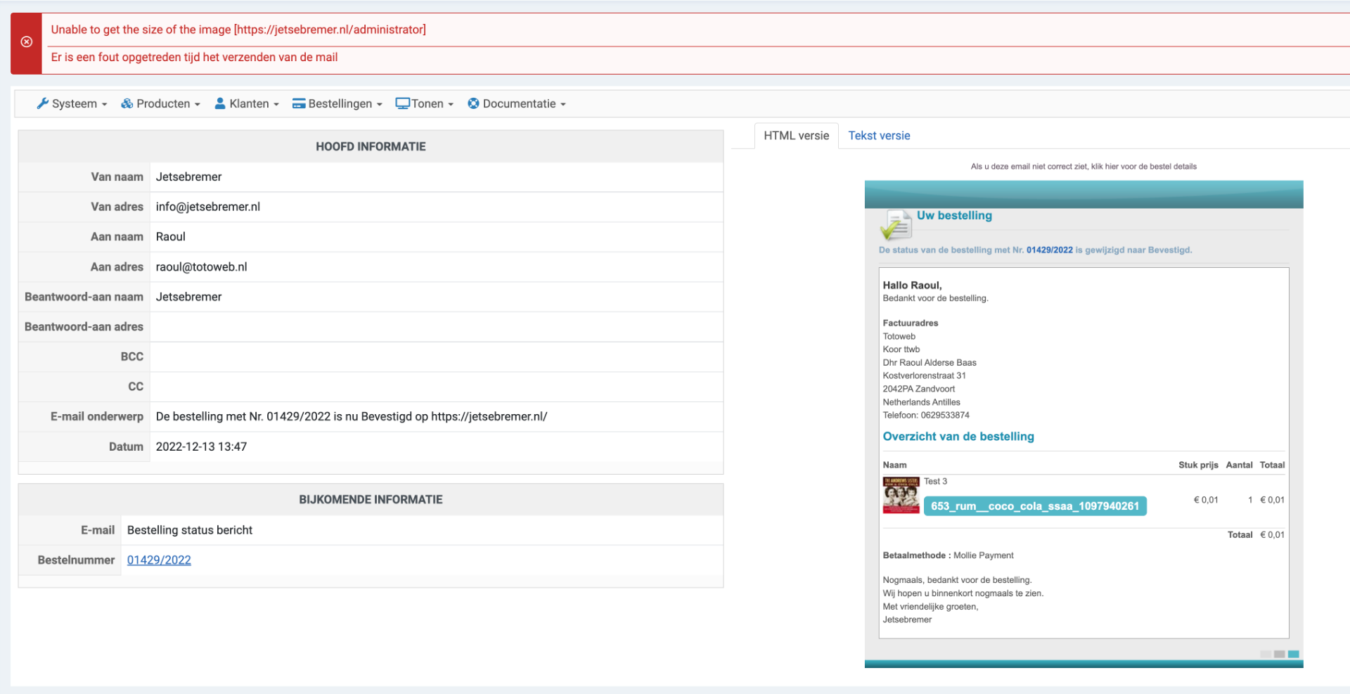

I've updated the plugin on your website for you and then I tried to resend the email and then it worked and I didn't get the error.
So I suppose you must have made a mistake when trying to update the plugin, like using the wrong install package.
Anyways, it's fixed on your website as far as I can see:
i.imgur.com/mGk6ERj.png
