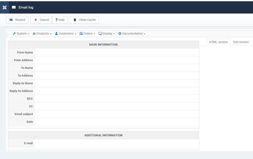

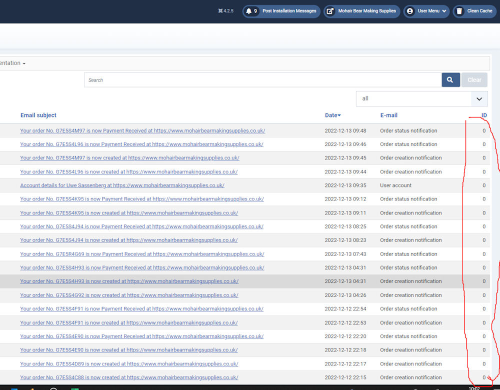

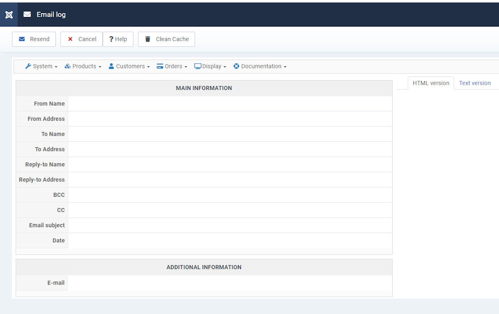

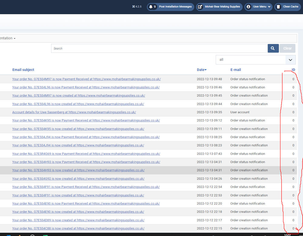

Hi, This looks to have been happening since upgrading to Joomla 4?
See attached. ALL emails sent to customers are blank in the email history? no id is being set all showing 0?
I know some email are being sent out correctly as I have them sent to my admin email also it appears just to be the log that is faulty?

This looks like a problem with the structure of the hikashop_email_log table. This would happen if the primary key / auto_increment on the column email_log_id would have been removed. This has happened (on other tables) to a few users in the past when migrating / updating websites.
I would recommend to delete that table via PHPMyAdmin. That way, the email history mechanism will automatically recreate it with the primary key / auto increment and it should then work properly.

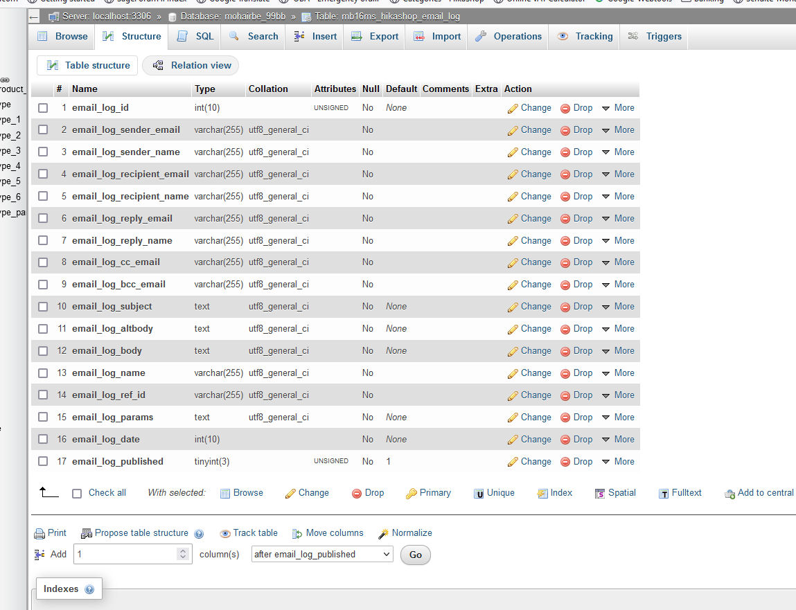

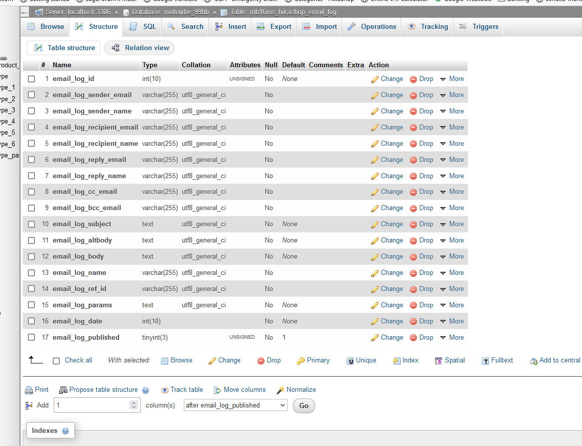

Can you provide a screenshot of the structure of the email_log table in your PHPMyAdmin ?

3 years 8 months ago #347508
Attached thanks

Note that you should not empty the email_log table but delete it, otherwise, HikaShop won't add it back and will just fill it again, not solving anything.
Here is how it should look:
i.imgur.com/NEa9OE0.png
Note the "AUTO_INCREMENT" text in the "extra" column for the email_log_id and the primary key in the indexes area at the bottom.
Please make sure it is like that and it will then work properly.

Hi, yes thats the fix.
