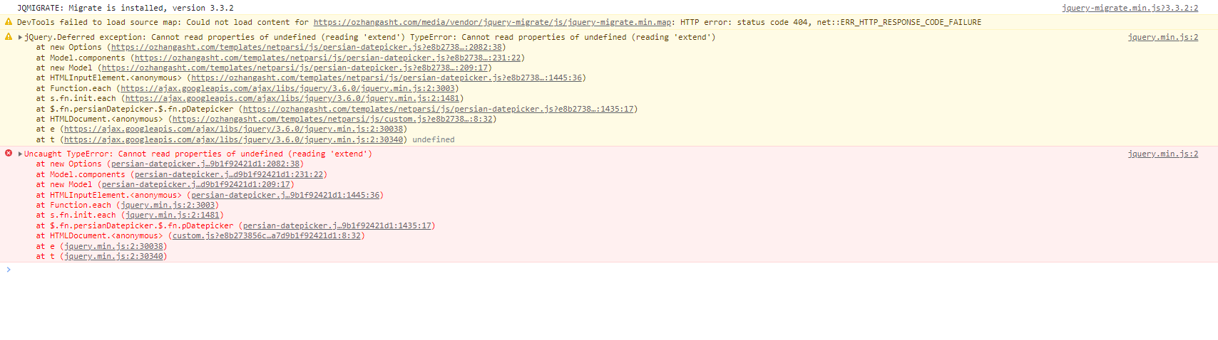

hikasshop.js has conflict with my datepicker library.
I tried alot tofix the problem but i did not managed to.
i also tried installing jQueryeasy plugin but it did not work too
can you help me with resolving it ?
i found where the hikashop.js is loading, i commented that line for testing and the error which is attached to this message was gone

Can you provide the URL of the page with the issue so that we can look at the situation and analyze it ?

i managed to solve the problem.
it was because my library should have used "jQuery" instead of "$"
