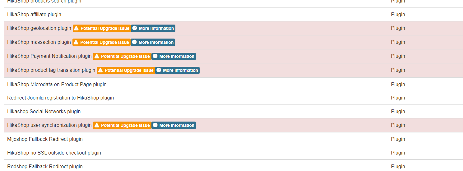

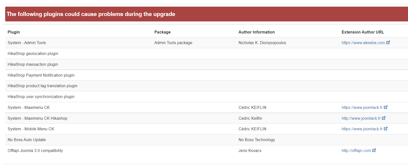

I am having a problem updating site to joomla 4 and getting error :0 Call to undefined method Joomla\CMS\Application\AdministratorApplication::isAdmin()
which the Joomla Forum says is from non j4 compatible extensions.
I just updated to new Business Hika 4.7.0 - Does that mean that EVERY EXTENSION IN THE PACKAAGE IS UPDATED?
the joomla live update says there is a problem.

This error indicates that one extension on the website is not compatible with Joomla 4.
To know which one, you need to activate the debug setting of the joomla configuration and try again. It will display the full error message with the path of the file where the problematic code it, pointing at the extension generating the problem.
The extensions (plugins and modules) included in HikaShop are compatible with Joomla 4 and automatically updated when you update HikaShop. So it likely comes from something else.

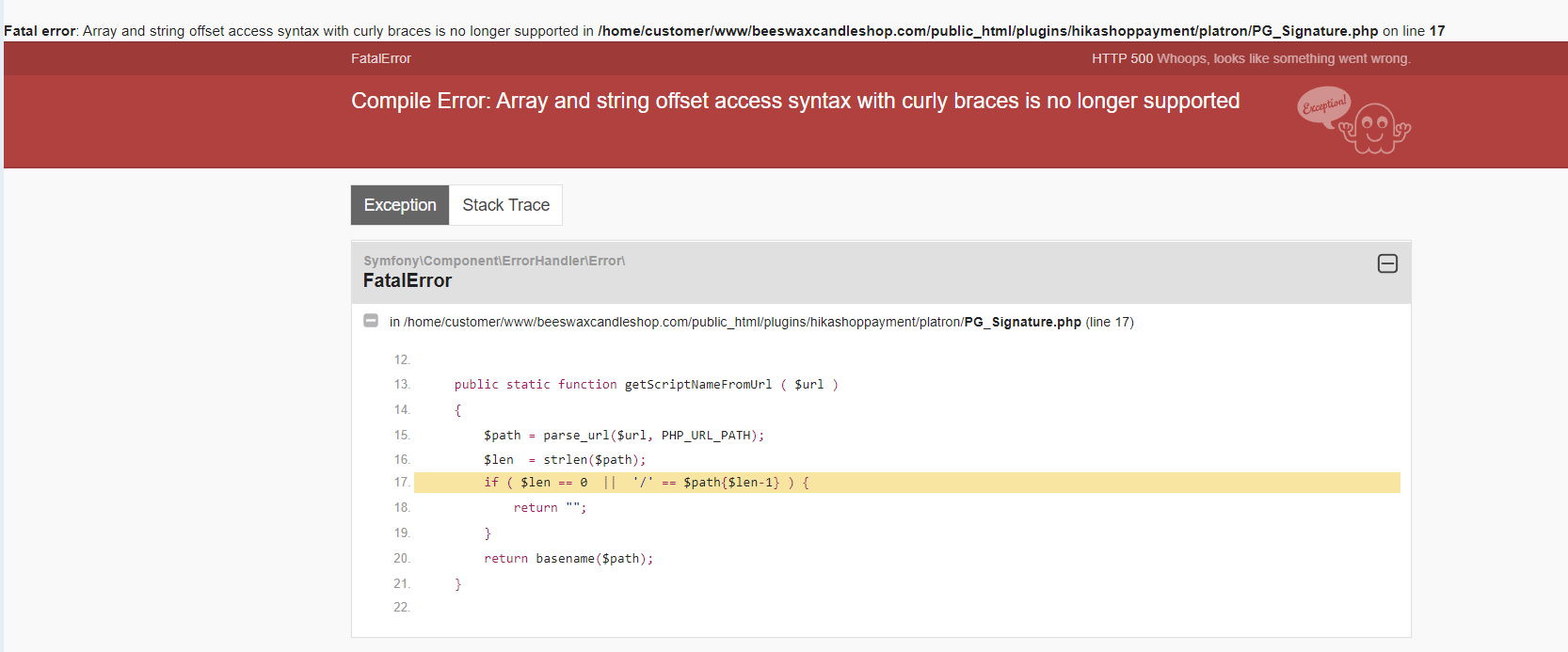

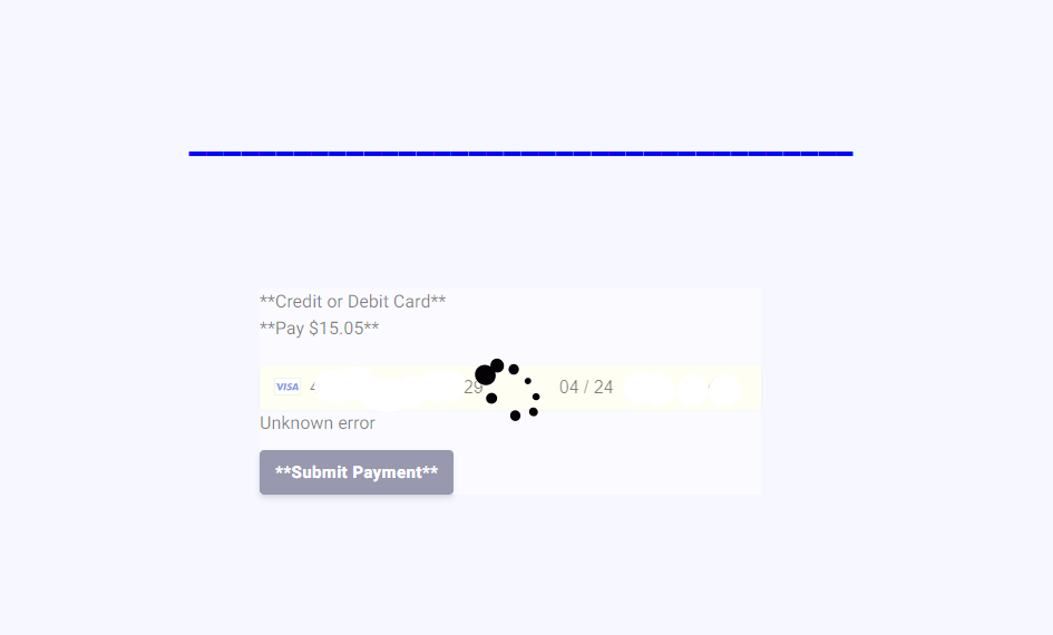

Another joomla 4 issue?? I thought everything was fine, but credit card stripe is not working - get this: image:
MORE INFO: Went to payment plugin page and clicked on "NEW" and received this error:
Last edit: 3 years 8 months ago by bigfoot. Reason: more info
More
3 years 8 months ago #348366 by Jerome
Replied by Jerome on topic Updating to Joomla 4
Platron plugin is not part of HikaShop packages.
See : github.com/HikaShop/hikashoppayment-platron

Hello again - I deleted the playtron file in hikashop and that error went away and now when I am in the system payment area and hit new all the available plugins come up - GOOD!
Then I ran another test and credit card payment did not go through - BAAAAD!
I was running php 8.0.27 --- I went back to 7.4.33 (what I was previously running before updating to joomla 4 and now stripe-connect is working. Is my stripe file out of date (purchased about a year ago) --- How do I proceed to get php back to 8?
More
3 years 8 months ago #348387 by nicolas
Replied by nicolas on topic Updating to Joomla 4
Yes, probably want to update it. There were several new versions for the plugin since 1 year ago, including some for PHP8.
To update it, you need to download it from the link provided in the order details on our website, under the My account>My orders menu. Then, install it again on your website and you will have the latest version.
