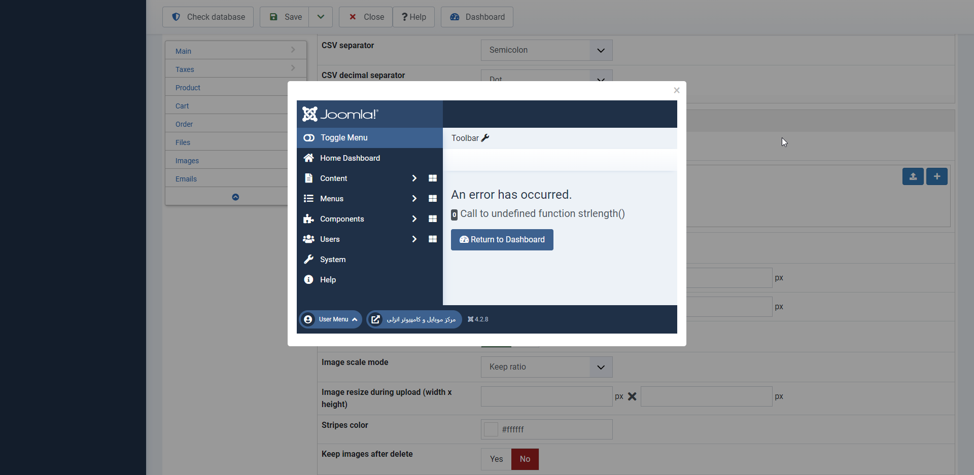

i tried to run my first project with Hikashop 4.7.1 on the same environment that used to run all my previous projects with the great hikashop, but i get this error when iclick on image select button in image uploader section for prodcts
although i can not upload any images for products and uploader turns into red error color

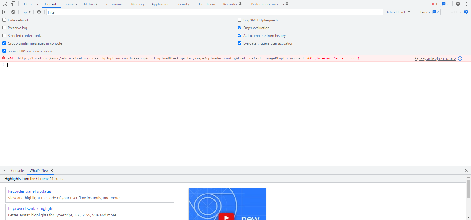

Could you provide a screenshot of the situation ?
Also, can you open the console of your browser and check if you get any error there when you get the issue ?
  • Posts: 237
  • Thank you received: 13
3 years 5 months ago #349753

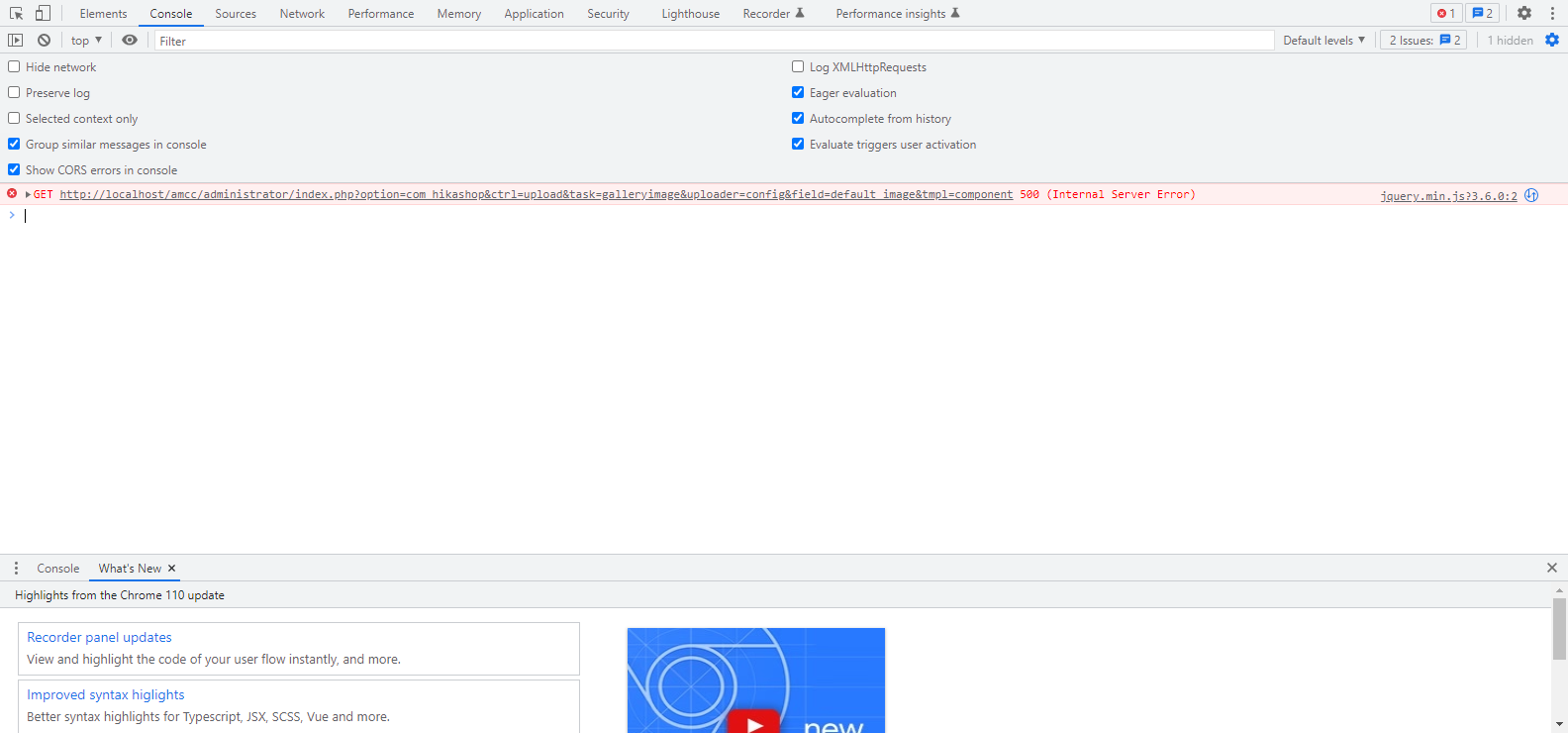

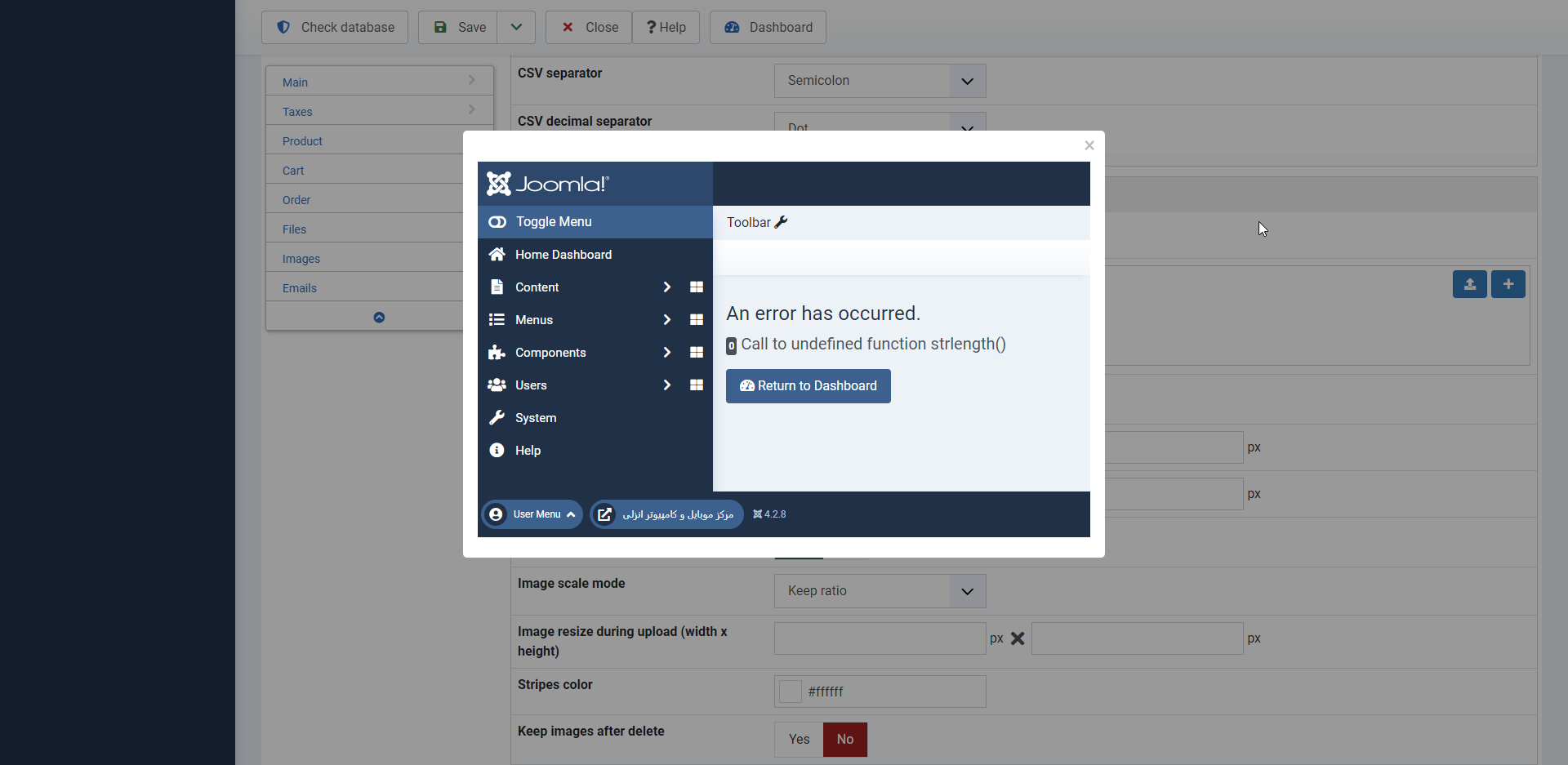

yes there is an error in console
i attached both screenshots

3 years 5 months ago #349754
I think that's something for which we already have a patch in HikaShop.
Download again the install package of HikaShop on our website and install it again on your website and it should help.

3 years 5 months ago #349758
the problem comes from the Stripes color field
if i leave that field empty error will go
but if i put a color code in it, error appears
  • Posts: 86080
  • Thank you received: 14188
3 years 5 months ago #349760
