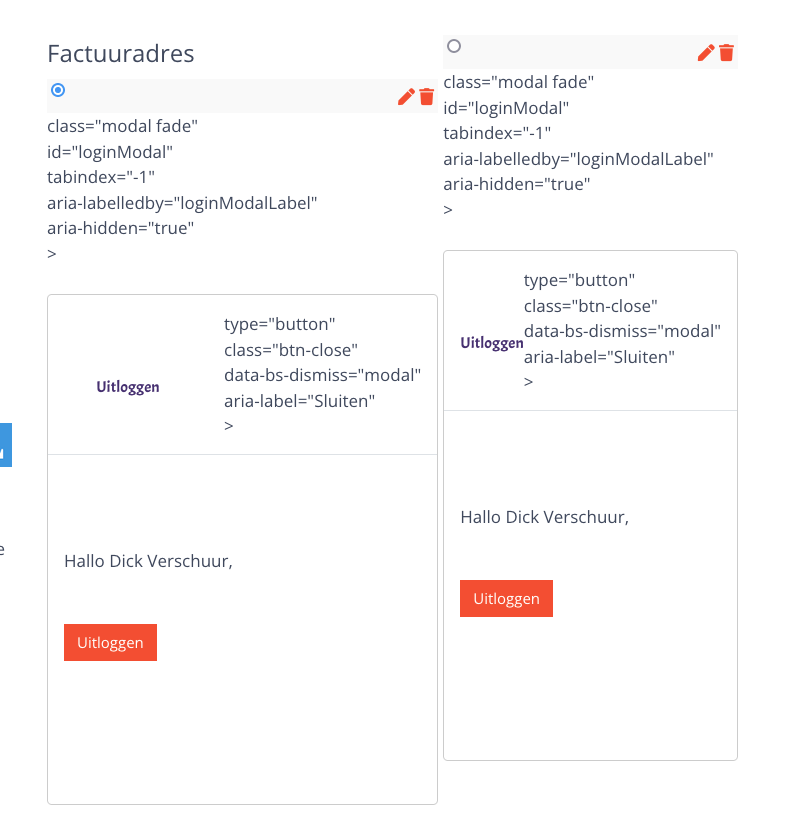

Good (monday)morning
I have waited all weekend to post this.
On checkout I have unexpected behaviour (see attachment).
Obviously there is something missing somewhere
Greetz
Dick

Registration is not allowed on your website ( i.imgur.com/RobuhHt.png ) and you didn't provide a user account credentials, so I wasn't able to analyze the situation directly.
Checking your screenshot, the HTML code displayed there seems to come from your template's login popup mechanism.
First, check if you have the folder templates/YOUR_TEMPLATE/html/com_hikashop/ via FTP.
If you do, rename it to temporarily deactivate all the view overrides for HikaShop in your template and then try again to reproduce the issue. If you're not able to, it means that the issue comes from one of the overrides in there, so you can rename each sub folder one after the other and then the files in them one by one so that you can identify which view file is creating the problem.
If you still have the issue regardless, then I'm not sure what should be done. You'll probably have to check with your template provider.

So, from what I can see there, it's the logout popup content which is added at the beginning of the address_template.
In the HikaShop configuration, you have a setting "address format" under the Checkout tab.
There, you can customize the format of the addresses displayed by HikaShop.
When you change that format, the modified format is stored in the file templates/YOUR_TEMPLATE/html/com_hikashop/address/address_template.php
If you say you don't have the folder templates/wt_vhost_pro/html/com_hikashop ( wt_vhost_pro is apparently your template folder name ), it means you ( or your template provider ) didn't change the address format and you're using the default one.
This means that for some reason, the template / login module popup system thinks it should add the logout popup content there.
How is that login/logout popup made ? Is that something in your template ? Or is it a special module you're using ?

I checked the code of that plugin and it uses the event onAfterDisplay to add the HTML of the modal module to the page.
I think it should use another event to do that as this event will be called each time a view is displayed (and so it displays for each address). Ideally, it should add it at the end of the page. I would have used instead onAfterRender and I would have done a str_replace on </body> to prepend the modules HTML before it.
That would avoid such problems.
