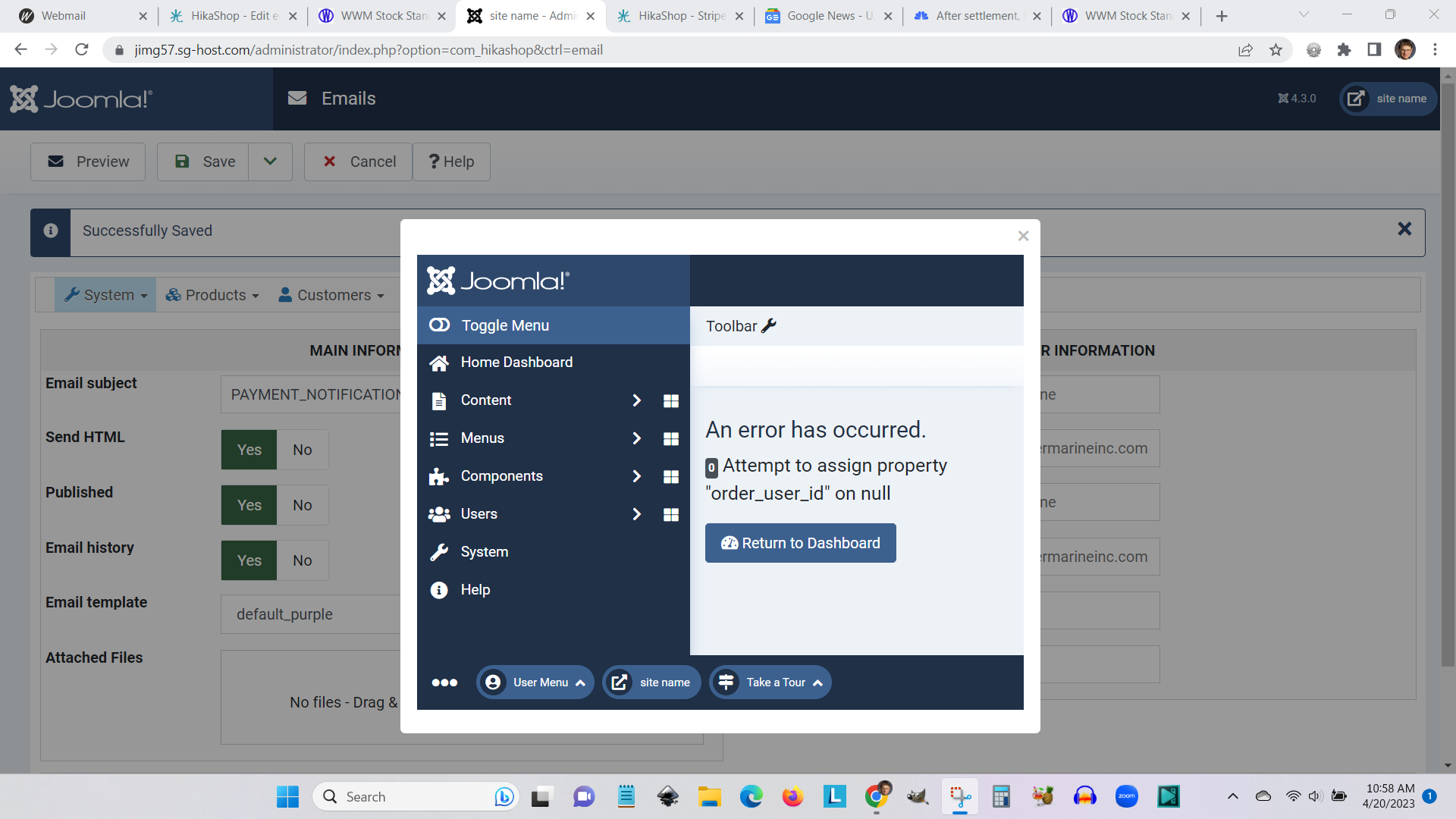

  • Posts: 317
  • Thank you received: 20
3 years 5 months ago #351140
Suddenly, can no longer preview email templates or work with orders. System asked me to create an order and I did. Did not edit anything. Went back to work on emails. Boom. None of the default templates work. All produce this error. Why?
It actually opens up a dashboard. For what?
Thank you.
Last edit: 3 years 5 months ago by jgribble.

  • Posts: 317
3 years 5 months ago #351153
This helps quite a bit, thanks.
Regarding the error, I did as you suggest and I see a long list but it tells me nothing. Since I did not edit anything in Hikashop, other than create my first order, I don't know why it occurred.
Before creating that order, I was able to preview.
Then after first order was created, everything went south.
Also, when I manually create an order and then add a product, the same error message appears and I can't add any products. I don't know as yet how far-reading this issue is. But it is obviously something serious.
Are you willing to take a quick look?
At least I find I can create new products.
Thank you,
-Jim Gribble
error has occurred.
0 Attempt to assign property "order_user_id" on null
Call stack
# Function Location
1 () JROOT/administrator/components/com_hikashop/classes/order.php:2041
2 hikashopOrderClass->loadOrderNotification() JROOT/administrator/components/com_hikashop/classes/order.php:2034
3 hikashopOrderClass->loadNotification() JROOT/media/com_hikashop/mail/order_creation_notification.preview.php:20
4 order_creation_notificationPreviewMaker->prepareMail() JROOT/administrator/components/com_hikashop/views/email/view.html.php:304
5 EmailViewEmail->preview() JROOT/administrator/components/com_hikashop/views/email/view.html.php:24
6 EmailViewEmail->display() JROOT/libraries/src/MVC/Controller/BaseController.php:645
7 Joomla\CMS\MVC\Controller\BaseController->display() JROOT/administrator/components/com_hikashop/helpers/helper.php:2459
8 hikashopController->display() JROOT/administrator/components/com_hikashop/controllers/email.php:103
9 emailController->preview() JROOT/libraries/src/MVC/Controller/BaseController.php:678
10 Joomla\CMS\MVC\Controller\BaseController->execute() JROOT/administrator/components/com_hikashop/helpers/helper.php:2437
11 hikashopController->execute() JROOT/administrator/components/com_hikashop/hikashop.php:73
12 require_once() JROOT/libraries/src/Dispatcher/LegacyComponentDispatcher.php:71
13 Joomla\CMS\Dispatcher\LegacyComponentDispatcher::Joomla\CMS\Dispatcher\{closure}() JROOT/libraries/src/Dispatcher/LegacyComponentDispatcher.php:73
14 Joomla\CMS\Dispatcher\LegacyComponentDispatcher->dispatch() JROOT/libraries/src/Component/ComponentHelper.php:361
15 Joomla\CMS\Component\ComponentHelper::renderComponent() JROOT/libraries/src/Application/AdministratorApplication.php:143
16 Joomla\CMS\Application\AdministratorApplication->dispatch() JROOT/libraries/src/Application/AdministratorApplication.php:186
17 Joomla\CMS\Application\AdministratorApplication->doExecute() JROOT/libraries/src/Application/CMSApplication.php:293
18 Joomla\CMS\Application\CMSApplication->execute() JROOT/administrator/includes/app.php:61
19 require_once() JROOT/administrator/index.php:32

  • Posts: 86216
  • Thank you received: 14222
3 years 5 months ago #351154
1. It might tell you nothing, but it tells us a lot about what is the problem.
This error means that the order which you selected before in the preview popup is not found. You must have deleted the order in the middle of your tests.
Logout from your backend and login again. It will reset the Joomla user session, including the selection you made previously in the preview popup and you won't get the error.
On our end, we'll add a fix so that even if the selected order is not found, it doesn't generate an error.

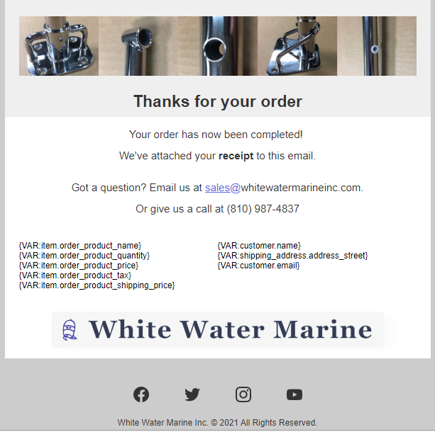

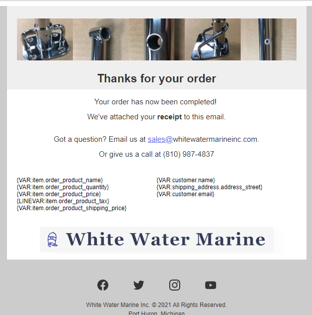

  • Posts: 317
3 years 5 months ago #351182
If I can use tags inside my custom email layout, what about LINVAR. There, I find the critical tag: {LINEVAR:item.order_product_name} And also ones like {LINEVAR:item.order_product_quantity}.
To the left, in the VAR column, I see plenty of useful things like {VAR:customer.name} and {VAR:customer.email} and {VAR:shipping_address.address_street} So that should work fine without any modifications..
I am thinking that for the LINEVAR tags to work they have to be converted intop VAR format. As in {VAR:item.order_product_name}. Is that what I need to do? And then I can drop my tags into my custom layout anywhere that works best?
Thank you,
-Jim Gribble
  • Posts: 86216
3 years 5 months ago #351183
For LINEVAR tags, you need to make sure they are between
<!--{START:PRODUCT_LINE}-->
and
<!--{END:PRODUCT_LINE}-->
so that the email template system can replace the tags several times, once for each product in the order.
I invite you to check the default HTML of an order email. You'll see that the start and end tags are around the |code]<tr></tr>[/code] which encompass each row of the products listing table.

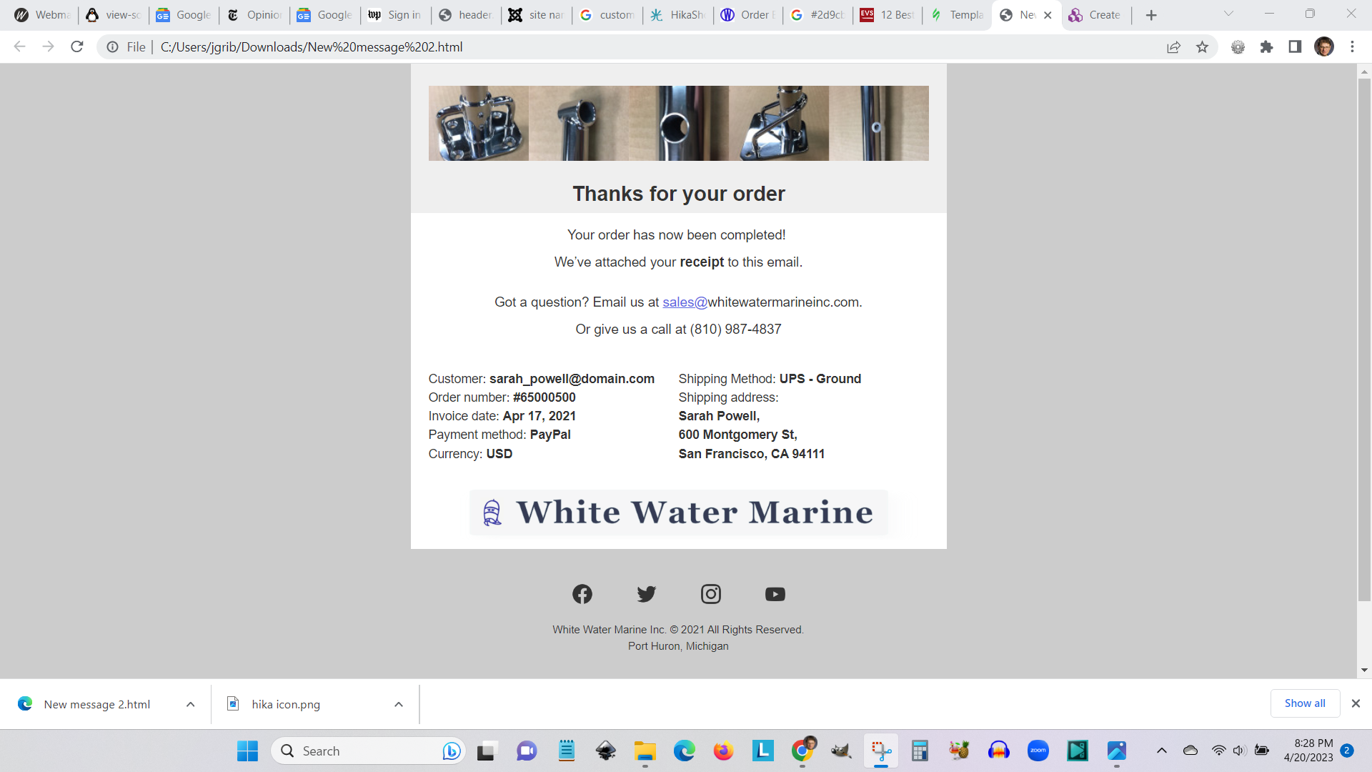

  • Posts: 317
3 years 4 months ago #351226
Thanks. Then, the way I proposed will not work. My undertstandng is faulty. Correct?
In the example I am showing, how do I fix that so that it will work?
Other form systems I work with typically offer something like this. {all_fields} Which publishes data from all tags. Very simple. Is that possible in Hikashop?
-Jim Gribble
  • Posts: 86216
3 years 4 months ago #351228
Yes and No.
Having the result like your screenshot on www.hikashop.com/forum/install-update/90...invoices.html#351158 is possible.
But I don't understand why you're trying to add the product tags in www.hikashop.com/forum/install-update/90...invoices.html#351182 ? The product tags are there to display the details of each product in the order.
If you want the same result as www.hikashop.com/forum/install-update/90...invoices.html#351158 then you need to use order tags. The list of tags is available with a button you can click on at the top of the "HTML" area when you're editing an email.
For example, for the order number you can use the tag {VAR:order.order_number}
For the total amount : {VAR:order.order_full_price}
For the customer email: {VAR:customer.user_email}
Now, some things like the order currency, are not available directly as a tag. Then, you can use PHP code. For example, for the invoice date, you can use:
<?php echo hikashop_getDate($data->order_invoice_created); ?>
