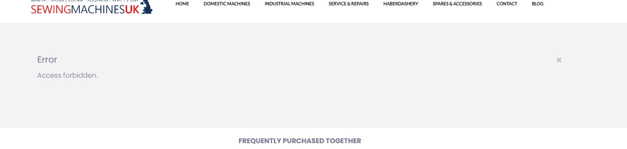

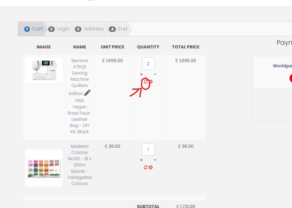

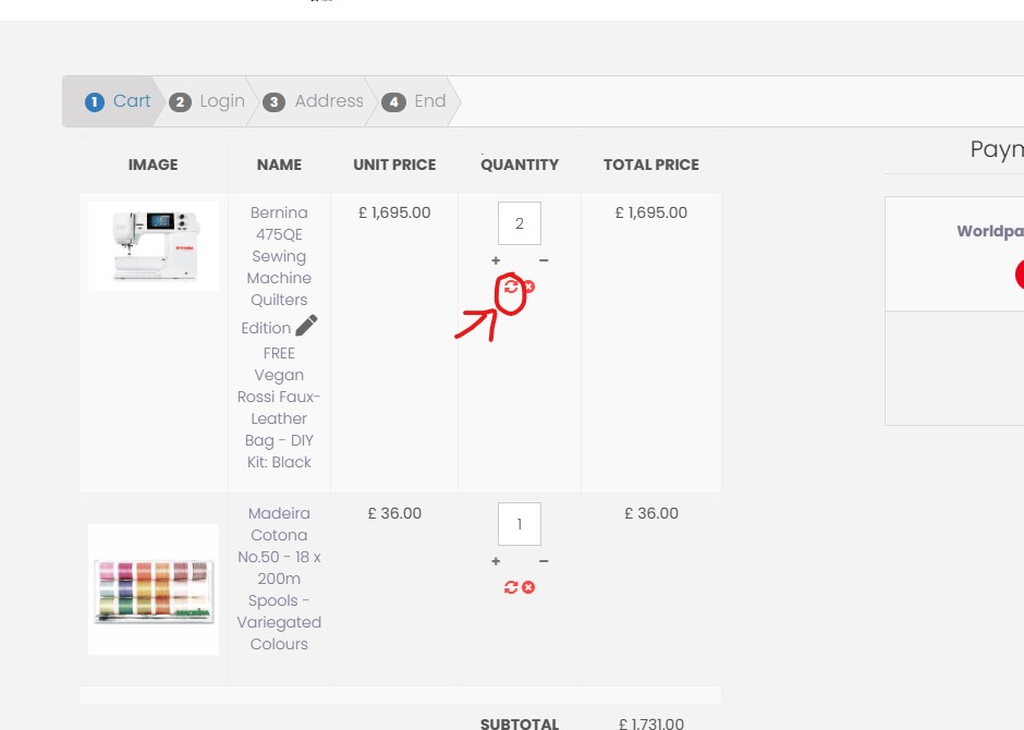

I'm having a little trouble with my checkout. Whenever I change the quantities in the checkout and press the 'refresh' button I get an access forbidden error.
I've searched your forum for an answer but I was unable to find a thread on the matter.
I was just wondering if it was something you've encountered before?
Sorry in advance, I'm just unable to pinpoint the issue.

I'm not able to reproduce the issue on your website.
I suppose it's because you left your browser tab opened for too long and your user session expired so the server doesn't recognize your browser when you try that operation.

I have tried no on 4 different devices, 3 different browsers (chrome, edge, safari) and different networks, however I always get access forbidden when I try to update the quantity.
When I change the quantity and click 'Next' However, the cart and prices will update as you would expect if you pressed 'refresh'.
I'm sure it couldn't be a session issue, as I have tried so many different sessions and devices.
Thank you for pointing out those errors, I have fixed the issues that were causing them. (was running the code for booking a viewing site wide for some reason. My bad.)

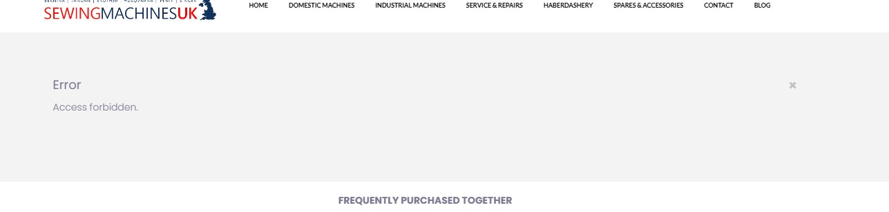

I've removed those and the cart updates as you change the value now, which is ideal.
If you manage to click update before it finishes refreshing then you still get the "access forbidden" error, but this should be good enough for me to be fair.

I've looked deeper into it. I'm now able to reproduce the issue. It only happens if you click on the quantity input field, enter something in it, and then click on the refresh button directly without clicking elsewhere before.
If you use the + or - and then click on the refresh button, or if you change the quantity in the input field and then press enter and then click on the refresh button, or if you change the quantity in the input field and click elswhere on the page and then click on the refresh button, it works fine.
That's why I wasn't able to reproduce it before on your website.
Now, I'm still not able to reproduce the issue on my test website. And I'm not sure why.
I've made a patch which should prevent the issue, providing that you don't have view overrides for checkout / show_block_cart and layouts / quantity on your website.
Download again the install package of HikaShop on our website and install it on yours. It will add the patch and it should hopefully work better.
