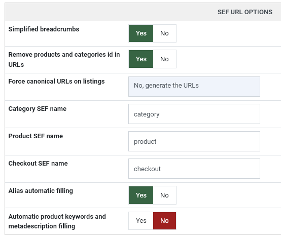

What do you have in the "checkout SEF name" setting of the HikaShop configuration ?

3 years 1 month ago #353057
It's "checkout". See below.

So what if you empty that setting ? Does it help ?
  • Posts: 966
  • Thank you received: 11
3 years 1 month ago #353123
Removing "checkout" seems to work. Now the URL is just www.mysite.com/checkout.html .
