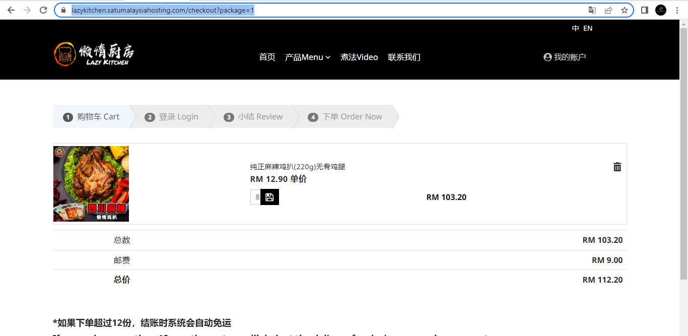

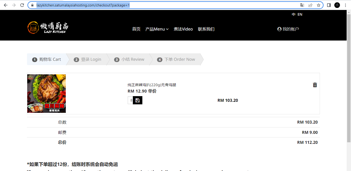

-- url of the page with the problem -- : lazykitchen.satumalaysiahosting.com/checkout?package=1
I would like to show package discount in checkout page using onBeforeCartSave method.
But seems like the discount won't show up even the additional already saved.
May I know the reason or the correct way to implement this?
Thanks.
	function onBeforeCartSave(&$element, &$do)
		$additional = new stdClass();
		$additional->name = 'package1';
		$additional->price_currency_id = hikashop_getCurrency(); // this line is compulsary, else it wont change the total price
		$additional->input_currency = $this->plugin_params->currencyid;
		$additional->price_value = 10;
		$additional->price_value_with_tax = -10;
		$additional->current_total = 100;
		$additional->discounted = 10;
		$element->cart_params->additional1 = $additional;
		foreach($element->cart_params as $param)
				$additional->name = $param->name;
				$additional->price_currency_id = $param->price_currency_id;
				$additional->input_currency = $param->input_currency;
				$additional->price_value = -$param->discounted;
				$additional->price_value_with_tax = -$param->discounted;
				$element->additional['package1'] = $additional;

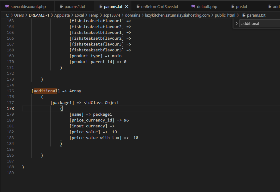

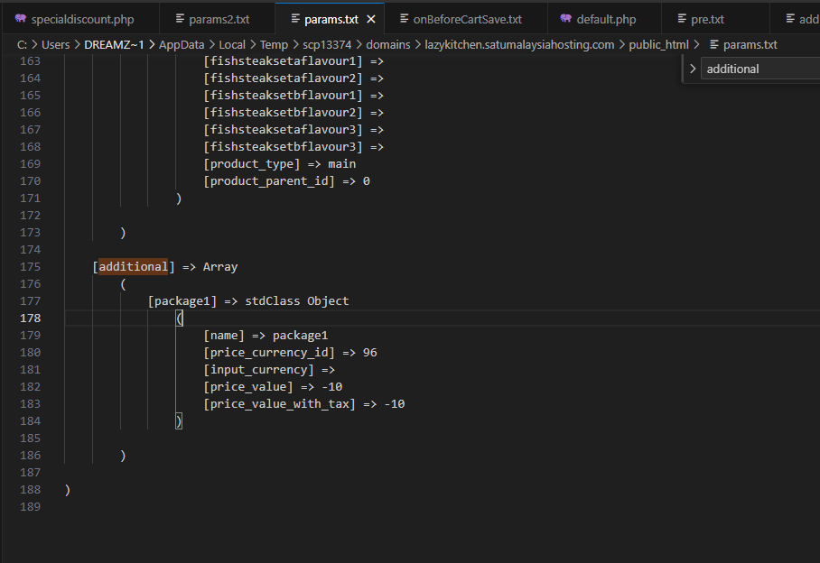

		$fp = fopen('params.txt', 'w');
		fwrite($fp, print_r($element, TRUE));
		fclose($fp);
		$fp = fopen('addi.txt', 'w');
		fwrite($fp, print_r($previous_total, TRUE));
		fclose($fp);

Additionals are to be added on the fly when the cart is being loaded.
I would recommend to look at the code of this plugin:
www.hikashop.com/marketplace/product/224-global-cart-fee.html
Its goal is precisely to add an additional fee to carts.
